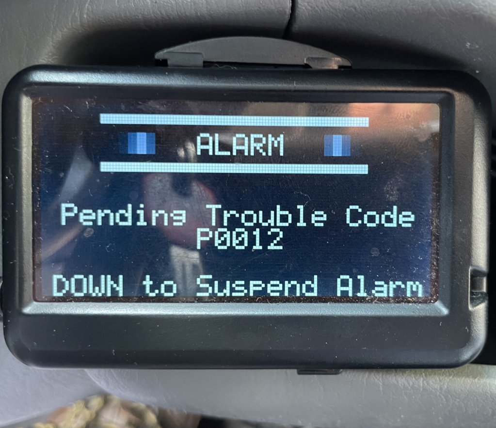

    Following up. Nothing gets my blood pressure up like a (pending) CEL, so I didn’t waste any time trying to diagnose the issue.
    The P0012 code that popped states:
    Camshaft Position 'A' Timing Over-Retarded Bank 1
    https://www.autocodes.com/p0012_toyota.html

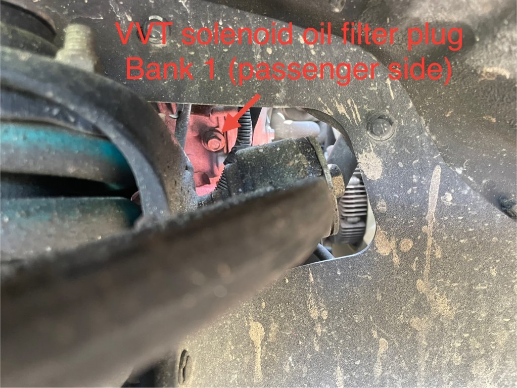

    Upon consulting the Library of Tacomandria (old threads), I found two likely culprits: the VVT filter, and the VVT solenoid itself.
    VVT filter
    From what I understand, this filter is designed to keep crud out of the VVT solenoid. With the P0012 error code, it stands to reason that the filter is either clogged or failed outright.
    I located the Bank 1 (passenger side) VVT filter, which is most easily accessed through the front-passenger wheel well. I then used a 14mm socket and a couple extensions to remove the plug. The filter came out attached to the plug, which doesn’t always happen according to some reports.
    It didn’t look especially dirty to my eye, but I opted to do a bit of maintenance while I had it in hand. I rinsed the filter out with gasoline, which isn’t the preferred method for addressing this part. Without a replacement filter on hand, it was the best I could do.
    I reinstalled the VVT filter and torqued to 46 ft-lbs, which is the only torque spec I was able to find for this part.

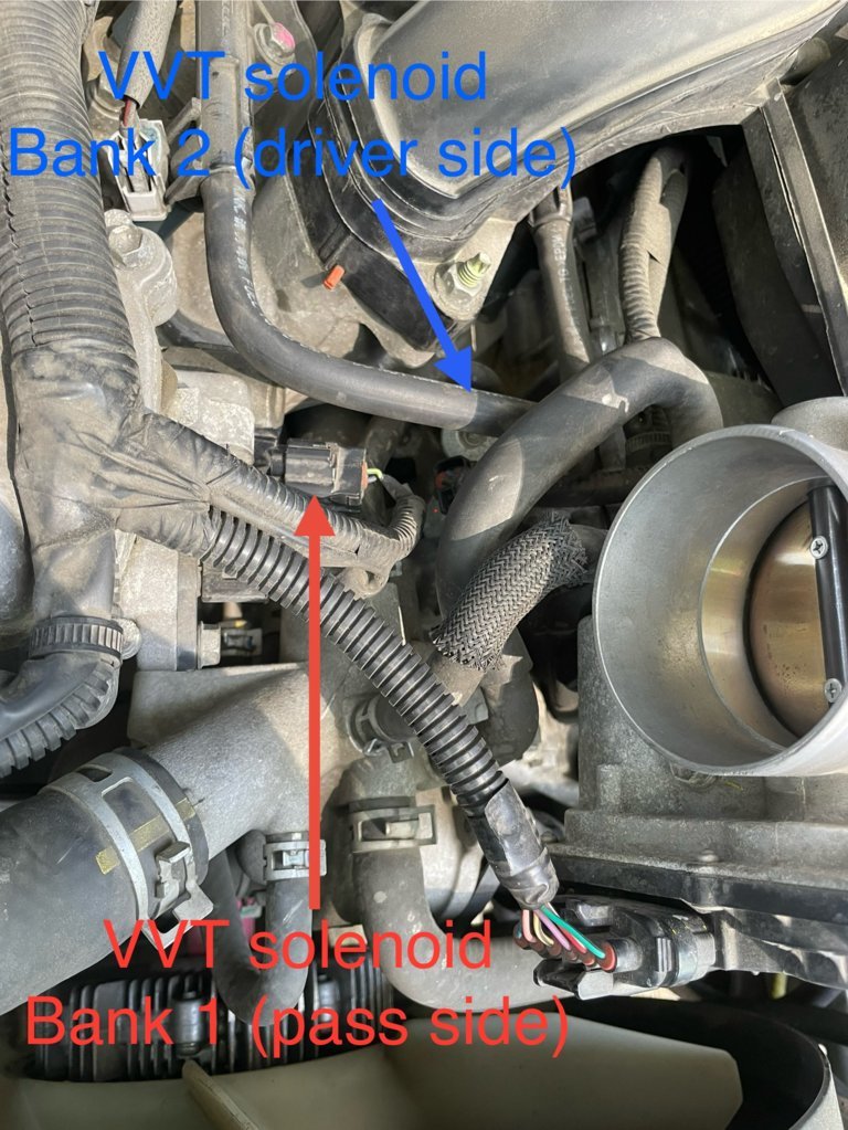

    VVT solenoid

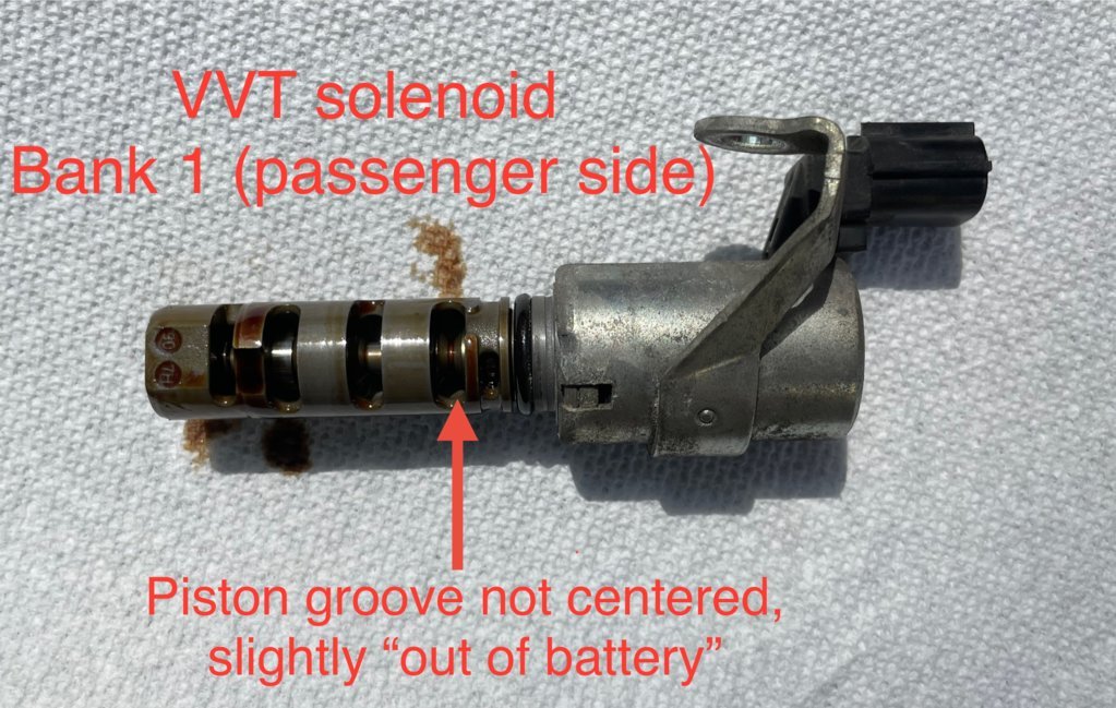

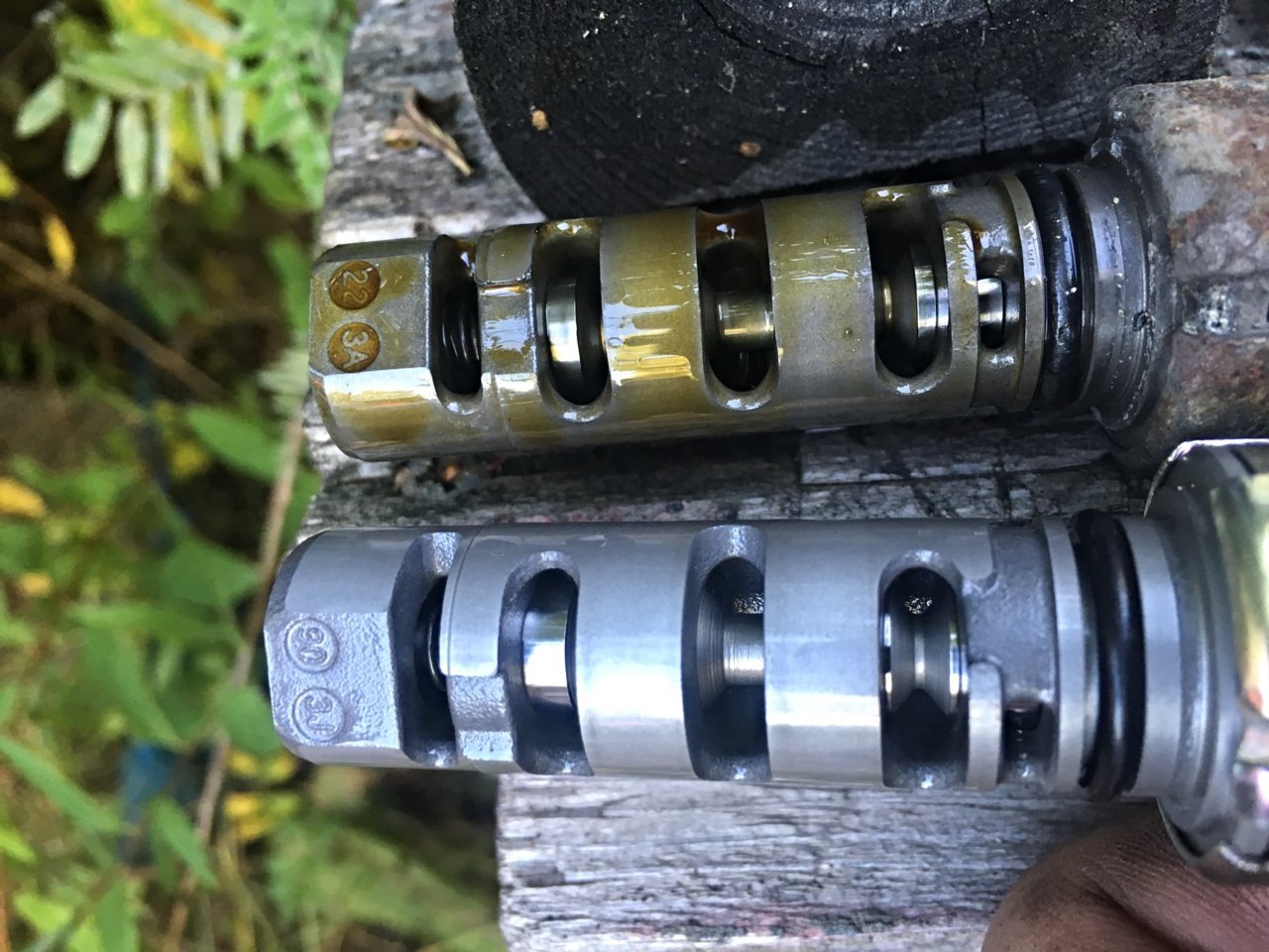

    Now on to the VVT solenoid itself. According to a couple sources I found, a sticky solenoid can cause a P0012 code. I also found a useful picture showing the indicators of a stuck/gunked up solenoid:

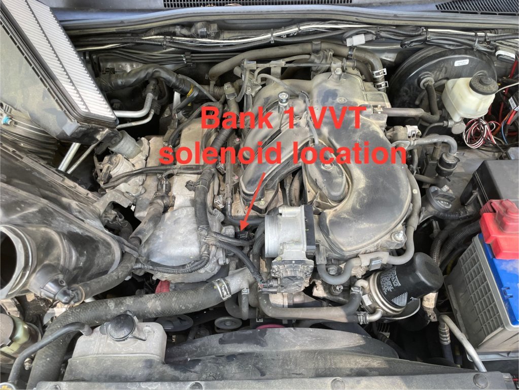

    Off I went to pull the VVT solenoid. After removing the engine cover, air filter housing, and air manifold, I was left with this:
    You can see that the Bank 1 (passenger side) and Bank 2 (driver’s side) VVT solenoids are very close to each other:
    Since I was already in the neighborhood, I figured I should pull them both for inspection and cleaning.
    While neither solenoid was as gunked up as the photo in the quoted post above, it was clear that the piston was slightly out of position when at rest. Without spares on hand, I once again did the best I could with what I had. Hosing both solenoids down with throttle body cleaner, including inside the enclosed end (near the electrical connector) seemed to restore full range of motion.
    Reinstallation wasn’t too difficult, nor was reassembly of the other components.

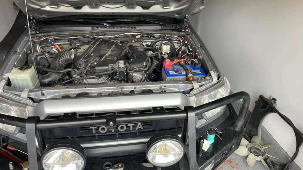

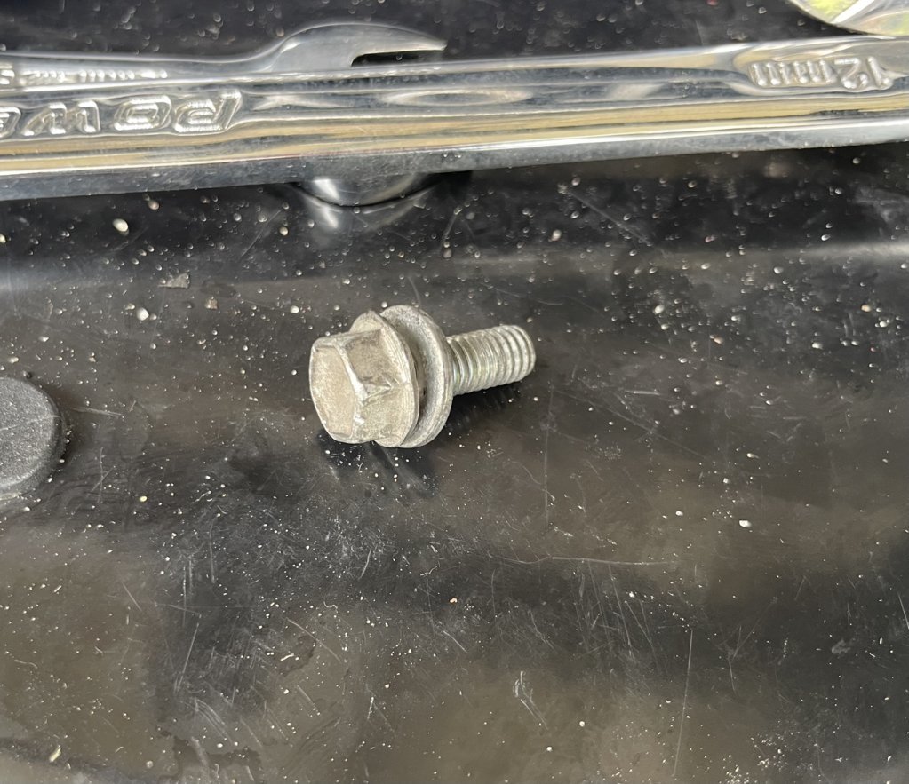

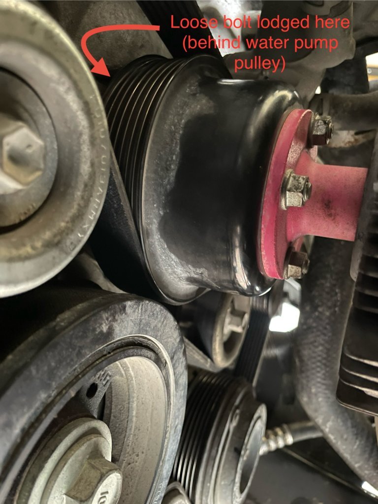

    Replacing the VVT solenoids ended up being something of an adventure. I sourced the replacements easily enough, OEM P/N 15330-0P010 for Bank 1/passenger and 15340-0P010 for Bank 2/driver. Everything was pretty straightforward up until I fumbled the stupid little bolt that secures the solenoid to the engine block. It decided to wedge itself nice and snug behind my water pump pulley:
    I had no luck trying to fish it out with a magnet or sticking my fingers in there. I walked out to my neighborhood auto parts store to get a replacement bolt, which I then installed. I reassembled everything and started the engine in the hopes that the errant bolt would be flung out by the rotation of the pulley. Nope, all I got was a god-awful screeching noise and the faint smell of rubber that had just started to burn. This isn't good.
    After a moment of
    ... and a decent night's sleep, I figured out what to do. Just gotta take the fan assembly out, loosen the serpentine belt, and retrieve the little bastard. Then slap everything back together, test, and carry on.
    https://youtu.be/SySKizdRA0I?si=4X50RFOQPG3WwRms
    This video was quite helpful in illustrating the process. There are differences between my 2015 and whatever he's working on, namely the coolant reservoir being integrated into the fan shroud and no actual need to disconnect the big fat coolant line before removing the fan shroud. Still useful though.
    Not as scary as I thought it would be.

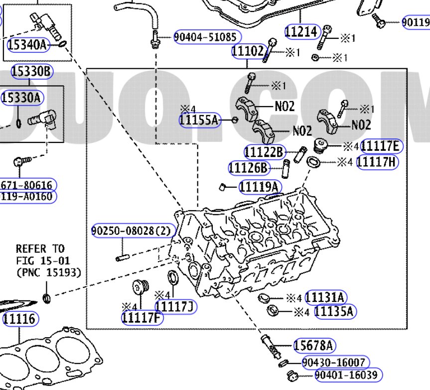

    Got it. The name of this little pain-in-the-ass is OEM P/N 90119-A0160, and it's the bolt that secures the VVT solenoid to the engine block. Here's hoping that's enough keywords for the search function to find this post.

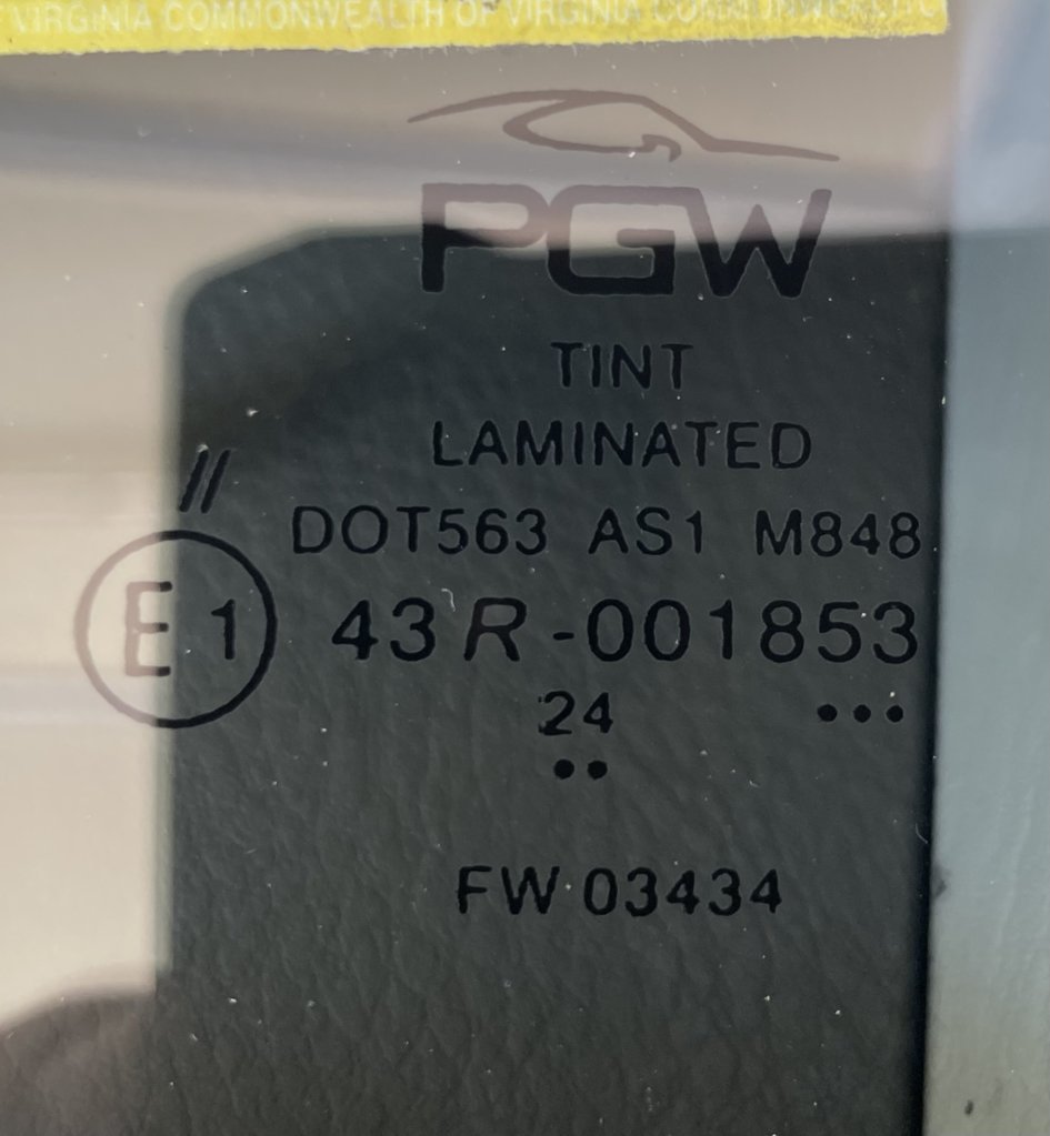

    I also got my windshield replaced, this time by Glass King of Norfolk. As mentioned in the quoted post above, these guys are highly rated. Their attention to detail leaves something to be desired, though...
    I specifically requested Japanese or American glass on multiple occasions. DOT 563 is the same manufacturer regardless of what brand name is slapped on it, whether it be TriVal like my previous windshield or PGW like the one they installed. To recap, this link shows the manufacturer's location based on the DOT number:
    https://www.carwindshields.info/dot_db
    As I noted previously:
    Am I annoyed? Yes. Is the manufacturer of the windshield more important than the quality of the install? Probably not. I've got bigger fish to fry at the moment, so I'll let it ride.
