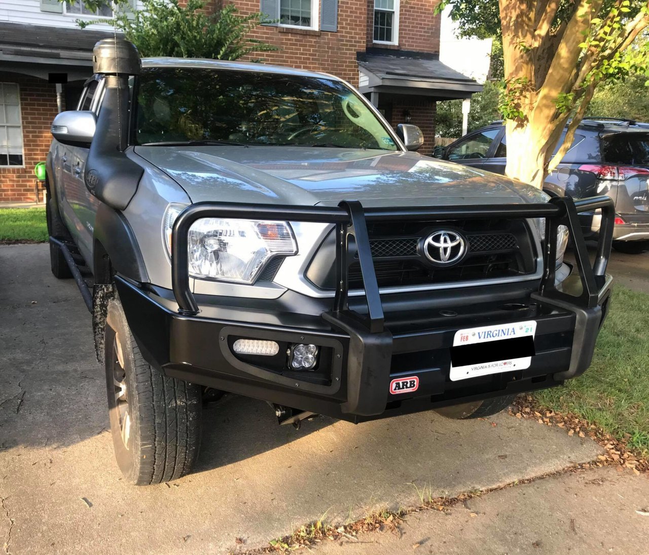

    ARB bumper installed. The M1 Main Battle Tacoma is starting to take shape.
    Why did I buy an overhyped, overweight ARB bumper for a daily driver that rarely leaves pavement? To put it simply: because it allows me to have my cake and eat it, too.
    The OEM bumper does 2 things remarkably well: it protects passengers, and it weighs very little. You will not find an aftermarket bumper that does both of these things better than the stock part. In exchange for these qualities, you have to deal with a relatively fragile part that is designed as a very expensive single-use item.
    Most aftermarket bumpers do one thing (fairly) well: they protect the truck during collisions. In exchange for this protection, you increase the vehicle's weight and compromise passenger safety. Altering or deleting your designated front crumple zone changes the way your onboard safety systems work, although the extent of these changes has not been tested.
    ARB is the only company that makes a Tacoma-compatible bumper that is certified to maintain stock airbag functionality. This is accomplished by replicating the crush rate of the stock bumper via an integrated crumple zone built into the bumper mounting bracket. In addition to accurate triggering of the airbags, this crumple zone also offers a modicum of frame protection during a collision. Take a look through this thread and count how many owners are left with a bent frame thanks to their aftermarket bumper:
    https://www.tacomaworld.com/threads/plate-bumpers-after-impact-with-pics.379600/
    Choosing the ARB over all the other options meant I had to compromise the least on the things that matter most: occupant protection and vehicle protection. In exchange, I had to significantly upgrade my suspension to handle the net +131 lbs of new weight on the front end. Maybe ARB will consider making an aluminum bumper one day; I consider this to be the ideal solution.
    On to the install itself!
    There was a significant amount of prep work that I accomplished before this install, which was done the weekend prior. Organizing, inventorying, and labeling hardware took a couple hours by itself. Be advised: if you don't organize your hardware in advance, you have a looong day ahead of you.
    Drilling mounting holes for the Slee Offroad LED inserts (P/N SOK0049) took another couple painstaking hours, including deburring and painting. This was well worth it, since ARB's optional "fog lights" are actually driving lights, renown for their inappropriate beam pattern and poor performance. I opted for Diode Dynamics SS3 Pro LED fog pods, as reviewed by @crashnburn80 in his thread here:
    https://www.tacomaworld.com/threads...og-light-review.554813/page-137#post-22622437

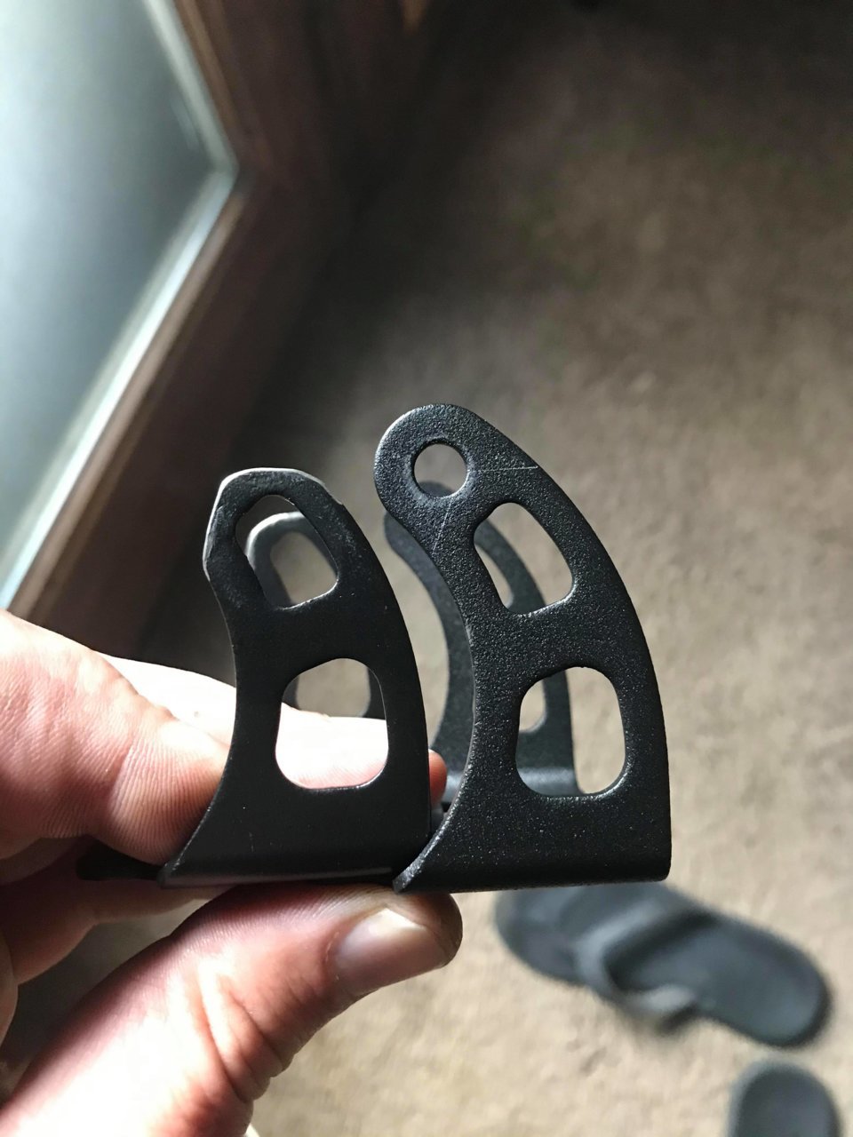

    The fog pods weren't quite centered in the Slee inserts, so I had to lop off the top of the LED pod u-bracket to get the lights to sit lower in their square cutout. Pictures below:
    Cut u-bracket (left) vs. stock u-bracket (right). Larger washers will be required for the LED pod side bolts.
    LED pods are now vertically centered (more or less) in the Slee insert cutout.
    With the bulk of the pre-install tasks complete, all I had to do was wait for my time slot in the #randyfab garage.
    Fast forward to install day. @ImpulseDan met up with @EatSleepTacos and myself, where I swapped my intact color-matched bumper for his black cut bumper section. This saved Randy the hassle of cutting my OEM bumper, and Dan got hooked up with a complete OEM bumper assembly. Win-win.
    The ARB install itself isn't terribly complicated. The instructions (full color pdf attached), while vague in spots, are generally accurate. There are a few extra things you can do to make the process easier:
    - Pack a pair of AA batteries and masking tape. These will be used to set the gap between your bumper and fender flares. It can be difficult to get this gap even on both sides, so taping an appropriately-sized spacer in place will simplify the process.
    - Have a 90 degree drill adapter on hand. Per the instructions, you are supposed to drill 4 additional holes in the bumper mounting bracket once you get your bumper centered and sitting pretty. These 4 holes and bolts fully lock the bumper into position, removing any possibility of adjustment slippage. The 2 upper holes are fairly easy to access for drilling. The 2 lower holes cannot be reached without a 90 degree adapter. Since Randy didn't have a 90 degree drill adapter on hand (who does?), I currently only have the upper 2 bolts installed.
    - You have a giant, expensive rust magnet strapped to the front of your truck now. Fluid Film the hell out of the inside of the bumper and the entirety of everything else. Embrace the truck butter. 1 can should be fine, unless you're like me and blow through 2.
    - There are threads on various forums discussing ARB bumper issues, post-install. The one recurring complaint I found has to do with the outboard "wings" of the bumper slapping the fender flares, causing a worrying banging sound. I had some adhesive-backed weatherstripping sitting around, so I cut some to length and installed it on top of the aforementioned "wings." For reference, this is the exact spot the AA batteries were taped for setting the bumper-to-flare gap.

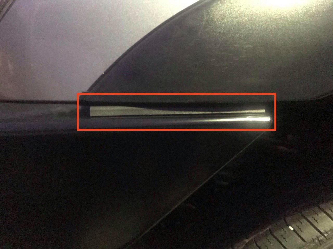

    Once you've made it this far, check the function of your fog lights and turn indicators. Aim your fog lights, tighten the mounting bolts (if using LED fog pods), and you're done!
    Note: the Diode Dynamics SS3 Pro fog pods are so bright it's absurd. With them on, I can't even tell that my Philips LED headlights are on. I'm hoping that my planned Lexus HID retrofit will correct this issue.

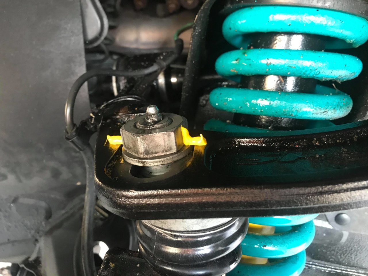

    The main effort today was originally going to be applying anti-seize to the adjustment hardware in my shiny new LCAs, which I finally got replaced under my CPO warranty. The original LCA bushings and ball joints themselves were fine, but one of the adjustment cams was seized. Details on that ordeal in my previous post.
    As it turns out, the dealership gave my LCA hardware a hearty coat of reddish grease prior to installation. Wiping this grease off and applying anti-seize in its place isn't really an intelligent use of time. Instead of working on my LCAs, Randy and I worked on some minor stuff that doesn't warrant a detailed writeup.

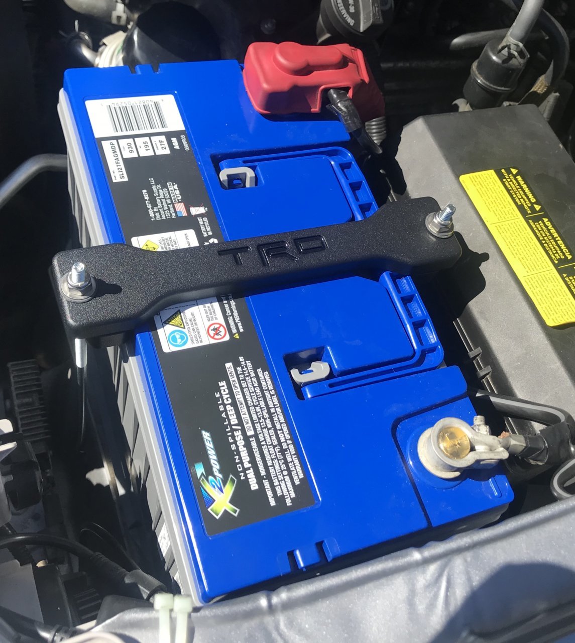

    This weekend has been significantly less busy. My HKB 0.5V voltage booster finally arrived from Australia, allowing me to install my X2Power 27F AGM battery and wide adjustable battery tiedown from @Coupe. Details on that particular upgrade here:
    https://www.tacomaworld.com/threads/the-northstar-agm-battery-voltage-booster-upgrade.604478/
    While I could've installed the upgraded battery prior to receiving the voltage booster, I didn't want to risk damaging the battery by charging it incorrectly. Take care of your stuff and it'll take care of you.
    I also reattempted the rear diff breather mod. I went with OEM parts this time around, using a union (P/N 90404-51319) and 2-way breather (P/N 90930-03136) purchased through OEM Part Source. I bought 7 feet of 3/8" fuel line and the appropriate hose clamps from my local AutoZone. 7 feet turned out to be the perfect amount, giving me just enough length to allow for full rear axle droop and hug the frame all the way up to the driver's side brake light.
    Yes, using 2 hose clamps per fitting is probably overkill. Two is one, one is none, three is fun.

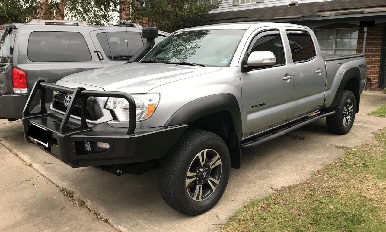

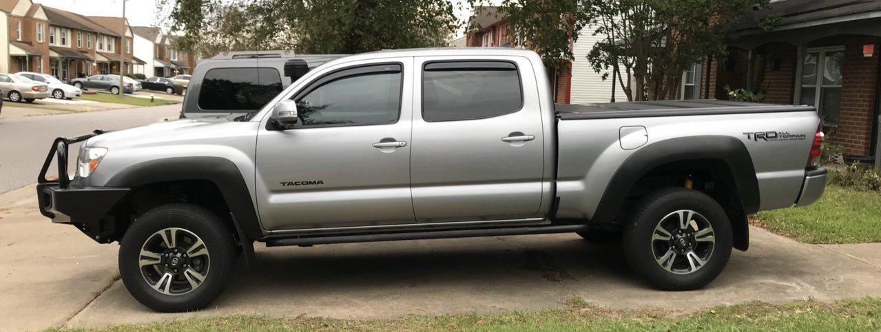

    It has now been 2 months since I had my lift installed, and 1 month since I added the ARB bumper to the front. I think the springs are about as broken-in as they're going to get, so I took measurements again to see where I'm sitting.
    Front end: + 2 7/8" lift (- 15/16" from original post-lift measurements)
    Rear end: + 2 7/16" lift (+ 3/16" from original post-lift measurements somehow?)
    Ride quality is firm, with very little nose-dive while braking or body roll while cornering. It isn't "plush" by any stretch of the imagination; hitting potholes and other road imperfections is much more jarring than the stock setup. My concerns about breaking components due to excessive shock transfer appear to be unfounded:
    https://www.tacomaworld.com/threads/damage-from-stiff-front-suspension.688486/
    I still suspect that the GS59-350 coils I have are actually meant for a heavier 3rd gen with armor. That said, if nothing is going to suffer damage due to the stiff coils, then I'll live with it for now.

    Yesterday, I got my SPC UCAs dialed in properly by a highly-recommended local alignment shop. The UCAs were adjusted to maximize space at the rear of the wheel well, which should ensure that I have room for mud flaps after getting larger tires installed. This was accomplished via SPC's recommended method:
    https://www.spcalignment.com/partFAQ/25470_FAQ.pdf
    This particular alignment shop is "old school": no computers, all manual. As such, I don't have any printouts to show my final alignment numbers. I'm going to take the shop's word on the accuracy of the alignment for now, and verify with my Firestone lifetime alignment later.
    Following the advice of @EatSleepTacos, I used a Markal security paint marker on the SPC's large 32mm nut once the alignment was complete. This will let me know if the bolt loosens or the ball joint slides within its slot. I recommend double-checking the torque on the nut before applying the
    f o r b i d d e n m u s t a r d
    After everything got dialed in at the shop, the tech told me that the VSC light was illuminated. He said that it was likely due to the extreme change in alignment: with the LCA caster cams dialed to max and the UCA ball joints rotated around, the tires were super toed-in before tweaking the tie rod (or whatever gets tweaked to adjust toe).
    I made a thread asking for assistance diagnosing the cause of the constantly illuminated VSC indicator:
    https://www.tacomaworld.com/threads/vsc-light-steady-on-after-alignment.689970/
    Since the ABS light wasn't on and the speedometer was functioning, a broken ABS wire seemed unlikely. @ShimStack offered some useful insight as to why a VSC recalibration might be needed. So, following his (and others') advice, I did a DIY VSC reset following the instructions in this thread:
    https://www.tacomaworld.com/threads...ibrate-your-vsc-computer-the-easy-way.467485/
    It took 2 paper clips and about 5 minutes in my office parking lot. Not complicated stuff.
    I finished up and took my truck for a spin around the block. The VSC light is off and stayed off for the duration of the ~3 minute drive. I will update this post if the light comes back on.
