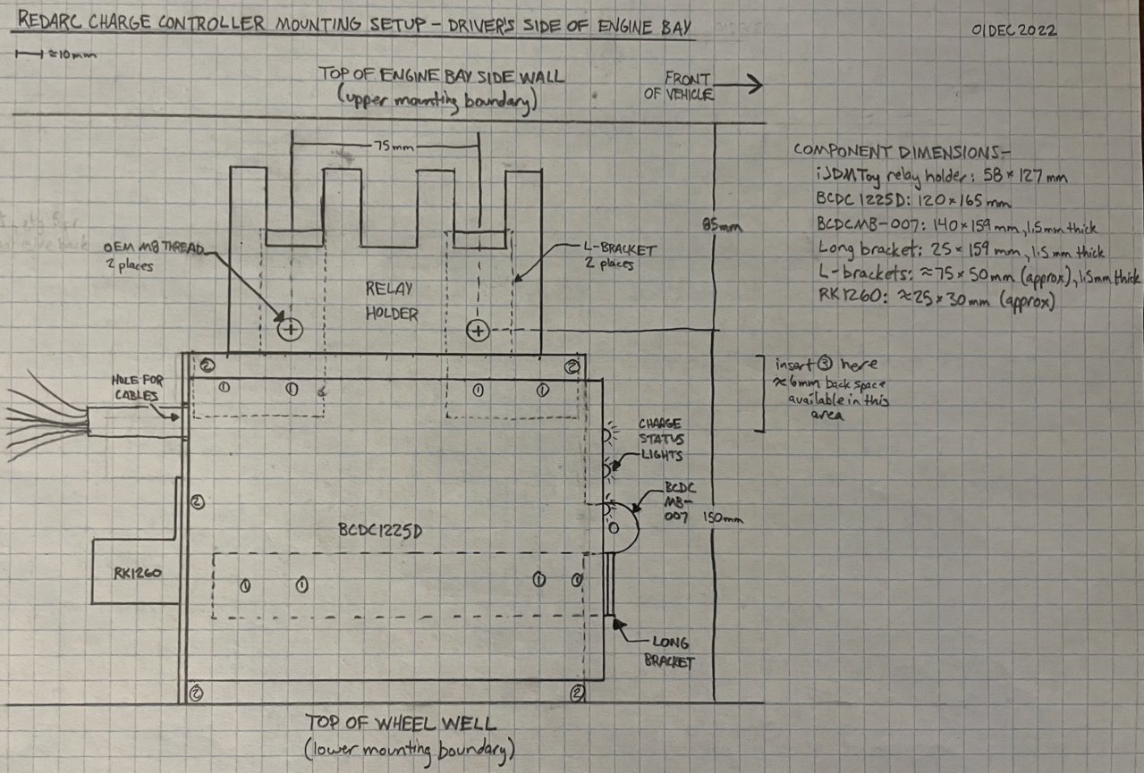

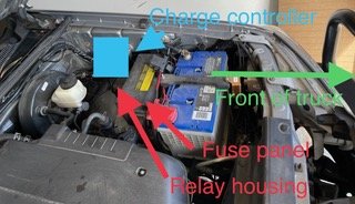

    Yessir, that's the plan. I'm shooting for the shortest wiring route possible, in order to minimize electrical losses along the cable run.
    If I'm unable to find a suitable waterproof enclosure for the solar charge controller, how worried should I be about the IP43 rating being insufficient? Based on my research, IP43 rated components can withstand -
    - Solid intrusion: Protected from tools and small wires greater than 1 millimeter.
    - Liquid intrusion: Protected from water spray less than 60 degrees from vertical.
    The most the charge controller will see is the odd trickle of water from above, where the hood meets the quarter panel. I can't foresee any circumstance where the controller would be subjected to water spray from below, or fully immersed.

    In all actuality, I have no idea. Water gets into wild places, same with dust. It might not cause issues right away but over time it may cause fuckery. That's all speculation though.

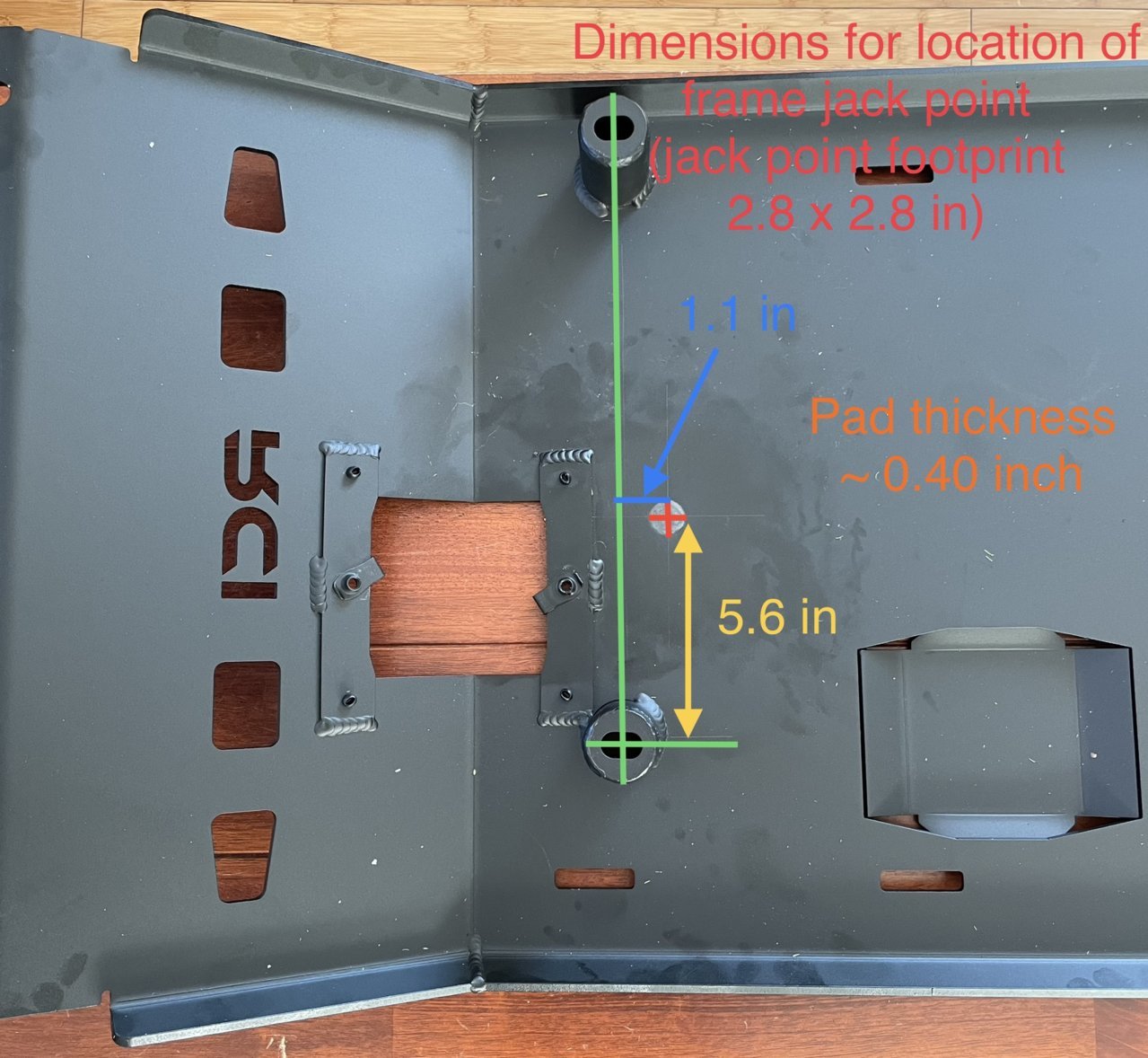

    With product selection out of the way, let’s move on to the mods I performed to the skids themselves.
    The most important alteration is the addition of a 3/8” thick UHMW pad, which is situated between the engine skid and the factory front jack point:
    I shamelessly stole this idea from @NukedTaco's excellent thread:
    https://www.tacomaworld.com/threads/rci-front-skid-mod.654059/
    The idea is to fill the gap between the two parts, minimizing the distance that the skid can flex before contacting a structural member. Material properties are an important consideration here: when bent, steel tends to deform while aluminum is more likely to crack.
    Another important consideration is enabling load transfer to a point on the frame that is actually designed to take it. There is a thread somewhere out there, showing a guy who bent his frame after his aluminum (!) RCI front skid took a hit. He ended up swiss-cheesing the two vertical RCI skid supports with a bunch of holes to ensure that they collapsed before damaging the frame again. It is my hope that adding another point of contact will distribute the load sufficiently to prevent something like this from occurring.
    To perform this mod, the first step is identifying the center of the jack point. This ensures that the UHMW pad is located properly. I stuffed a small plastic bottle, 0.93 OD x ~3” long, into the drainage hole in the jack point, then installed the engine skid and marked the outline of the bottle with a scribe. I also took a small piece of hard material and stuck it in the desired mounting location to determine the required material thickness. My measurements for locating this point are below:
    With the jack point dimensioned and center point marked, I ordered a small 5 x 7 x 3/8” thick UHMW pad off Amazon. I then cut it to approximately 4 x 5” size, and added a notch to accommodate the weld securing the oil filter cover frame. Once that was done, I drilled a hole in each corner of both the pad and skid, painted the raw metal, and installed:
    Could I have just taped the pad down instead of through-bolting it? Maybe, but that depends on the quality of the UHMW used. Cheap UHMW material is “skived,” and has a tendency to curl at the edges over time.
    https://www.mcmaster.com/high-temperature-uhmw-polyethylene/
    Since I bought Amazon-grade (crap) UHMW, it’s fair to assume that it’s the cheapest material available. Bolting the pad down will prevent curling, and will definitely keep it exactly where it’s supposed to be.
    I added some EPDM sealing washers to electrically isolate the stainless steel bolts, nuts, and washers from the skid and (electrically conductive) UHMW pad. Galvanic corrosion is a real problem, and it’s one I haven’t paid any attention to until recently. A writeup on that topic is coming soon.
    I also added some dummy-proofing to both skids with paint. The jack point is marked in white, the oil drain plug port is outlined in green, and the transmission drain plug port is outlined in no-no red.

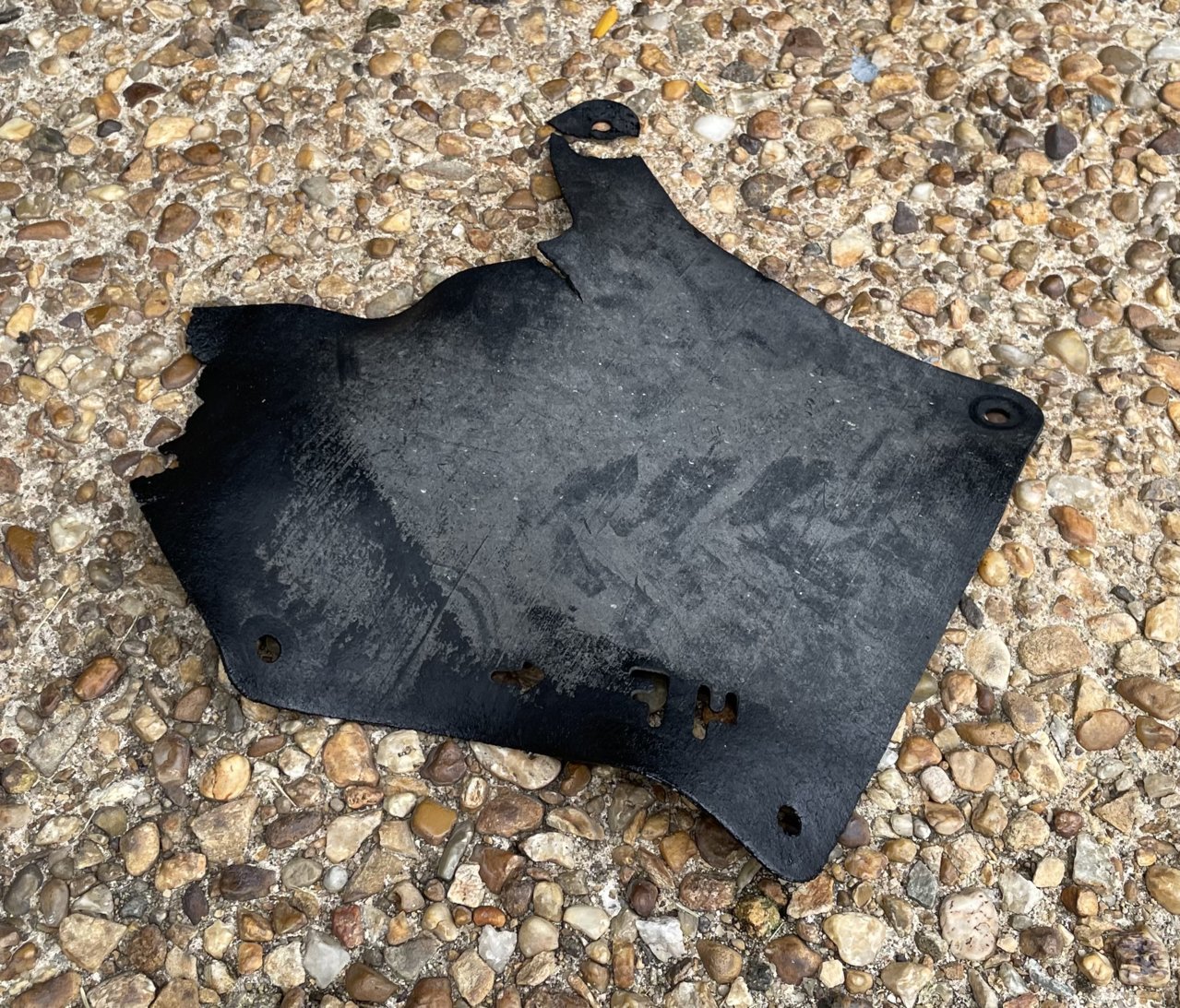

    I replaced my partially-shredded OEM splash guards:
    ... with some aftermarket ones, made by ARK. These were a bit fussy to fit, and required some modification:

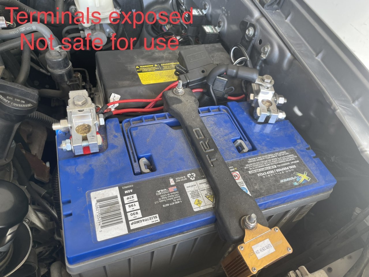

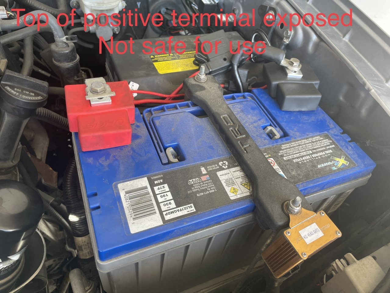

    The last thing I accomplished was installing my newly-arrived SDHQ billet battery terminals. I got these because my stock terminals were basically maxed out, and I have some more electrical mods coming up soon (specifically, a single-battery solar setup).
    SDHQ's installation instructions are beyond useless, so I highly recommend following @boogie3478's video instead:
    https://www.youtube.com/watch?v=i061RQGfizQ
    I have one important note from the install process: DO NOT get rid of your OEM positive terminal cover. If you get in a collision, and your hood gets bent up, it's possible that the hood could make contact with the (now extra-tall) positive terminal. That will instantly turn your fender-bender into a vehicle fire.
    It's almost like Toyota knows what they're doing.

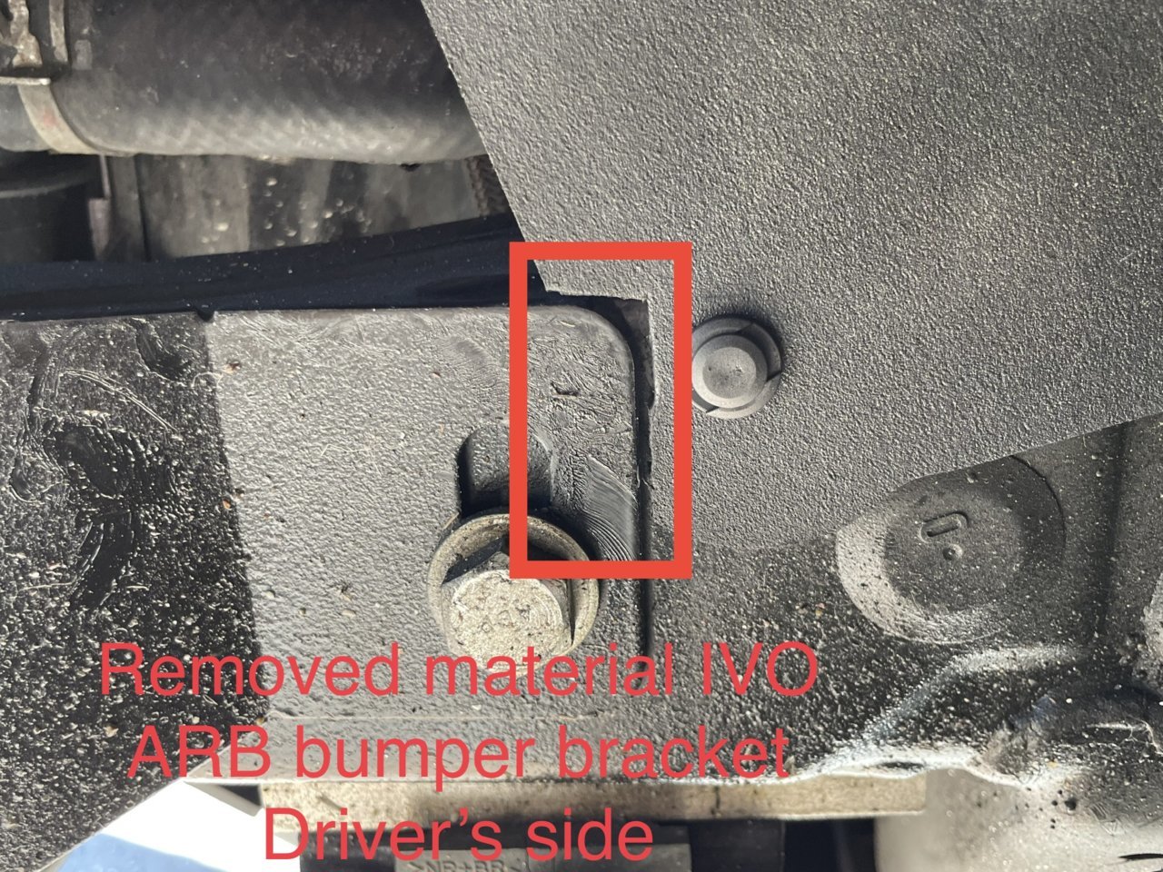

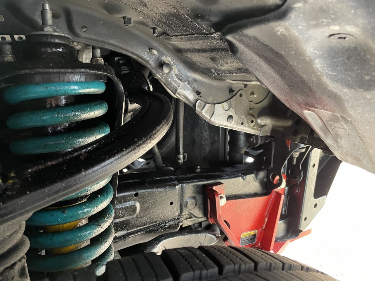

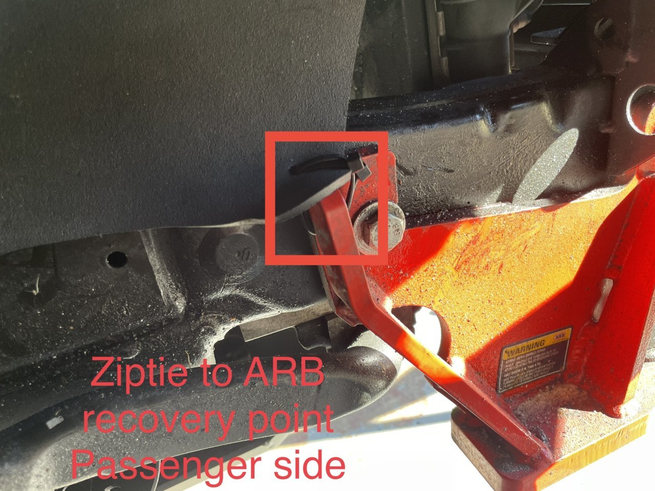

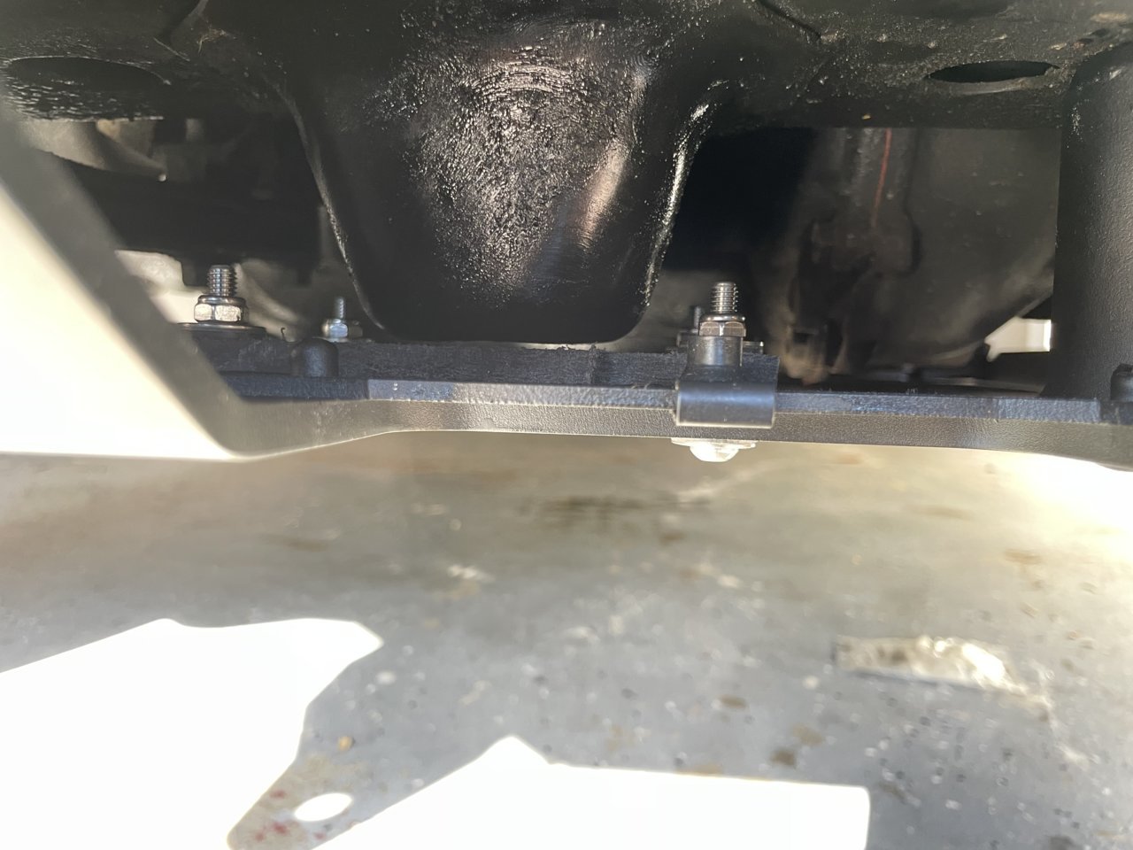

    @dpele, I had my truck up on a lift today for an alignment. This should illustrate what the RCI cat guards cover.
    I have also made note of a couple components making contact, which are the likely source of some worrying new noises. I intend to correct this issue in the near future.
    dpele likes this.
  19. Dec 9, 2022 at 12:05 PM
    #179
    aturk
    aturk Well-Known Member
    Jul 24, 2019
    #300138
    1,707
    Tony
    Charlotte, NC
    Easiest option is to put a few washers under the carriage bolts at the rear of the transmission skid, spacing it down a quarter or so inch. Between the skid and the crossmember.
    Best option is going to be to use a carbide burr to open up the holes on the RCI skid to allow more adjustability when bolting down the cat guards. I used a burr on mine, but after pulling the transmission skid twice because I didn't open the holes up enough, I put some washers under it. I'll pull it in the next week or two to do a proper fix.
    ardrummer292[OP] likes this.

    I was thinking about inserting some sort of padding between the cat guard and cat, just to dampen the vibration. I'm wondering if this would work:
    https://www.jbweld.com/product/exhaustweld
