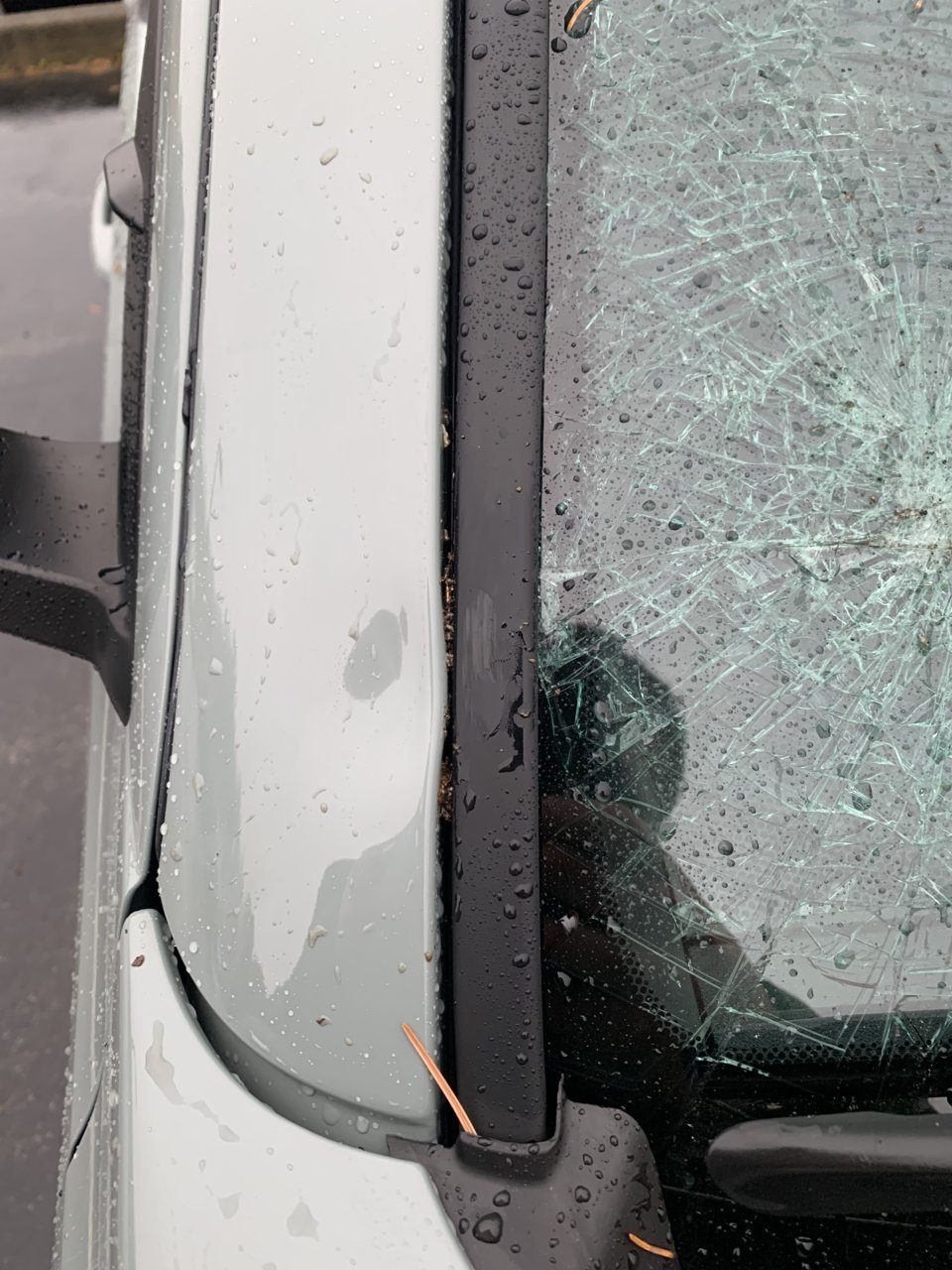

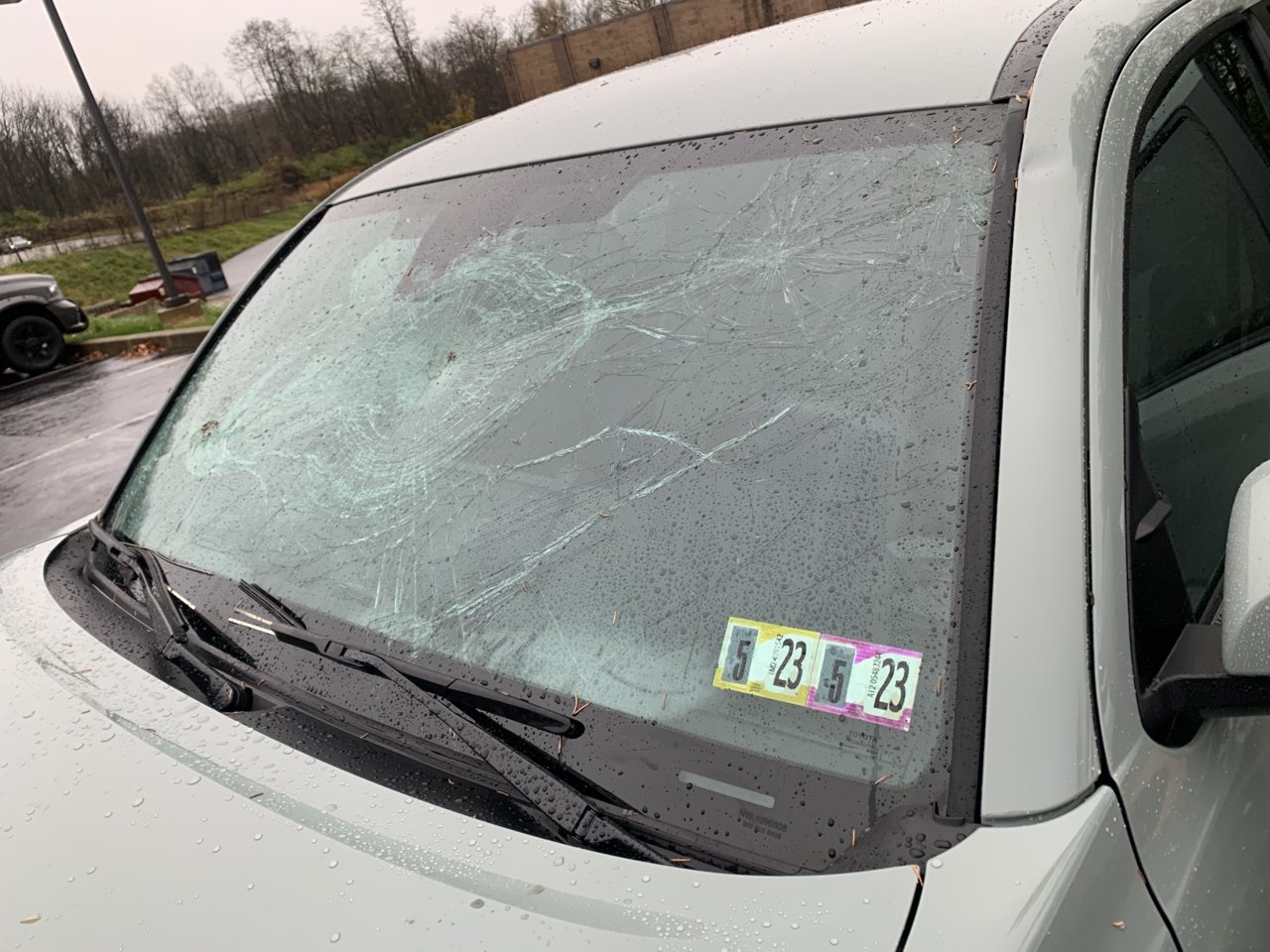

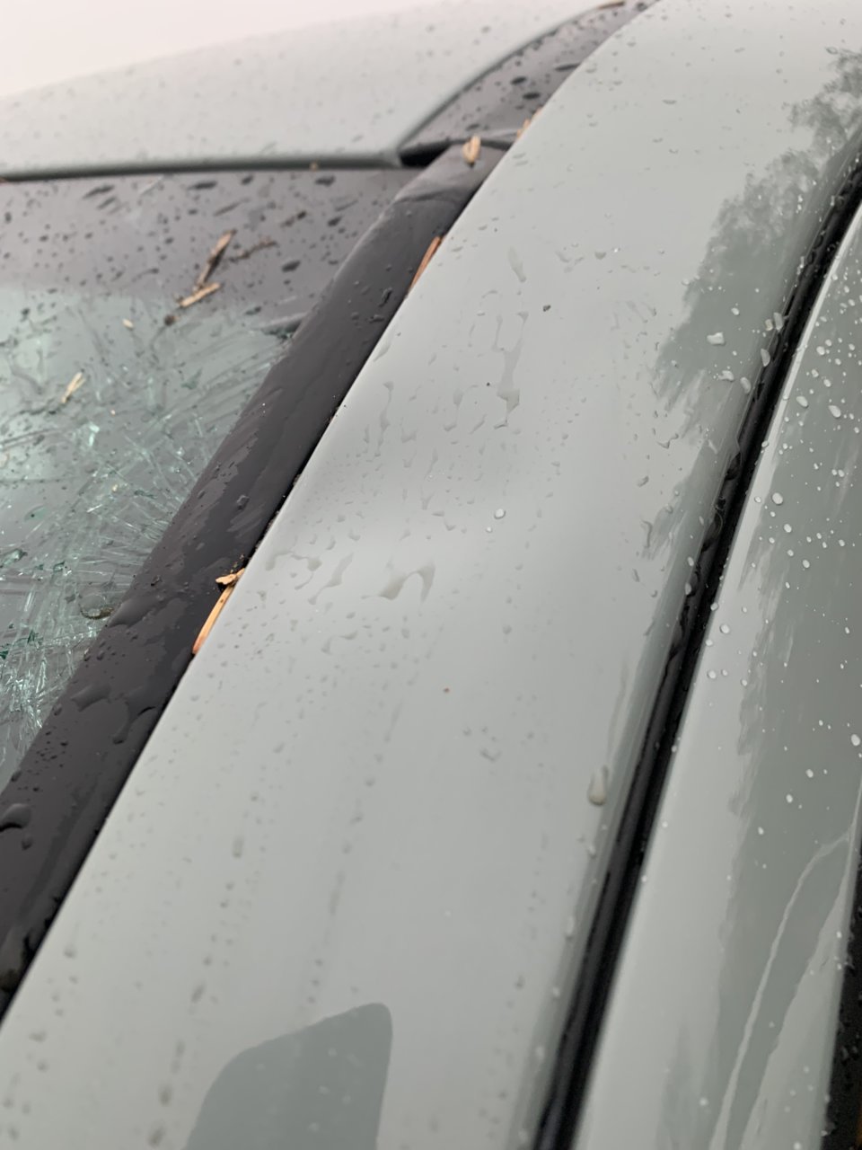

    Hello guys. Had some seriously bad luck this weekend. A small tree fell on my 3k mile taco. Landed across the windshield blowing that out with glass inside. Also produced a dent in each A pillar. Had the truck towed to my repair shop and the guy there said very unlikely PDR and the repair would include removing a piece that goes all the way to the back of the truck, down and u set to the front again. This would require bed removal and all. I’m horrified to have a factory new truck go through all that after market repair.
    Based on the pics does anyone believe PDR could be possible? If not I’m almost wondering if living with the dents and just having the windshield replaced is the smarter move. The repair sounds intense and I wonder if it would ever be “right” again. Any thoughts would be really helpful!

    A good PDR guy should be able to do it. It is a pain though as those pillars have a lot of stuff in them My jeep had a similar issue and we were able to fix it with PDR. As long as paint is not broken and the metal is not linked it might be possible. Get a PDR specialist to look at it as body shop may not have someone

    PDR would be very tough because those pillars are thick and designed to be sturdy as hell. Give PDR a try but don't be too optimistic about it

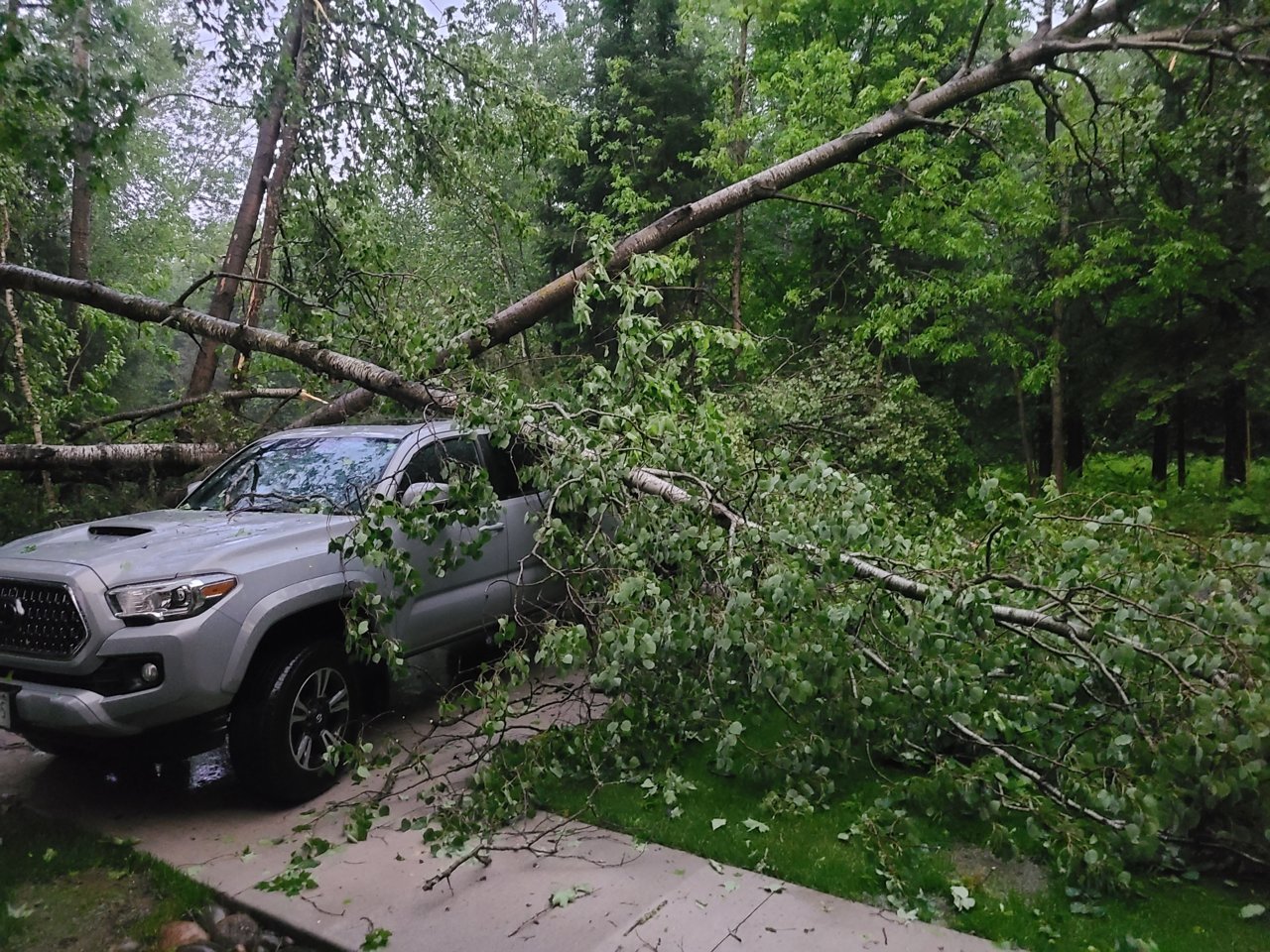

    The reason they are saying it needs/should be replaced is, because that is structural part of truck (in rollovers)
    Just had this done to my 18. New roof, and structural side replaced last month20220615_061002.jpg

    From what I see installing the A-pillar grab handle, the A-pillar interior trim, curtain airbag, and wiring come out easy, giving ample access from the inside to knock out the dent.
    PDR may not bring it back 100%, but a shop can bondo, sand, and paint the rest. It's in an area where paint matching isn't too difficult.

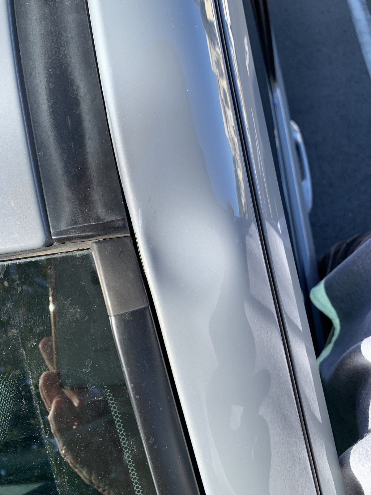

    Update? I joined the club today with a dam twig from a hanging tree on the side of the road

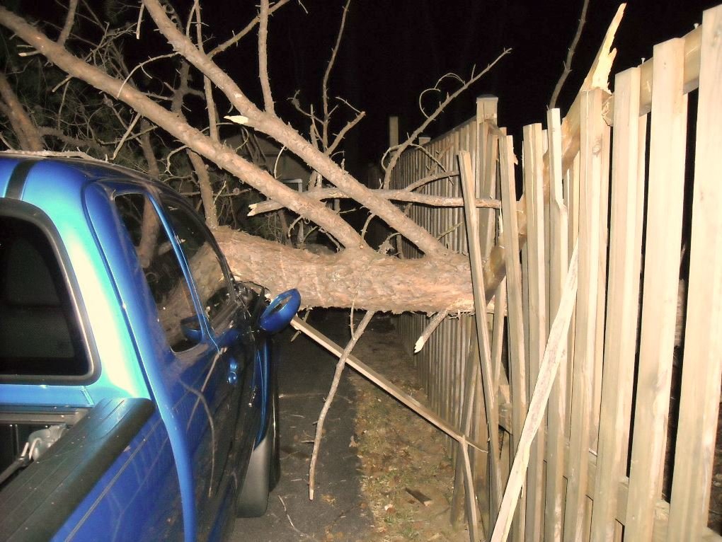

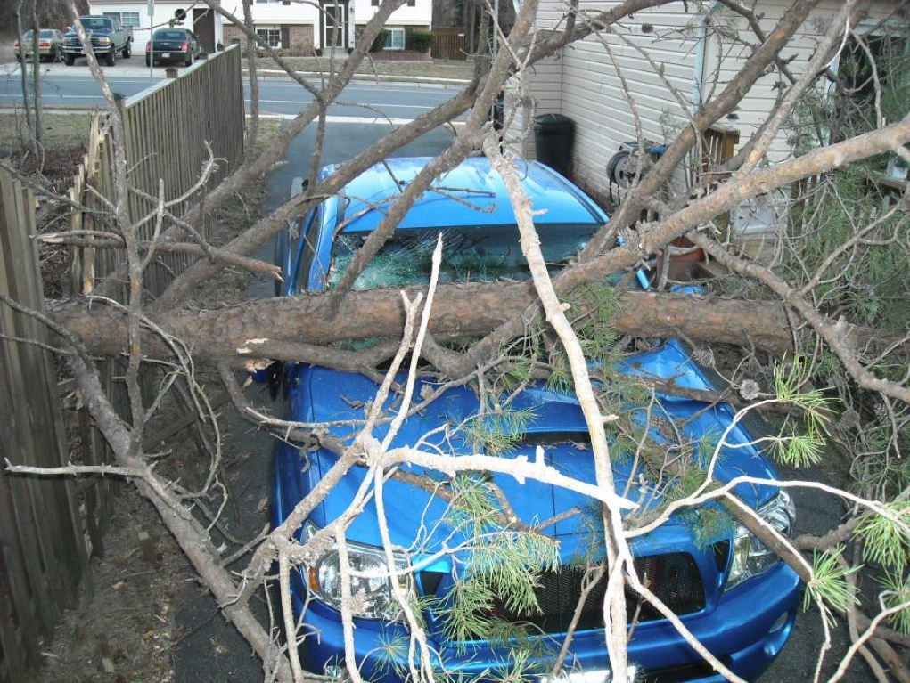

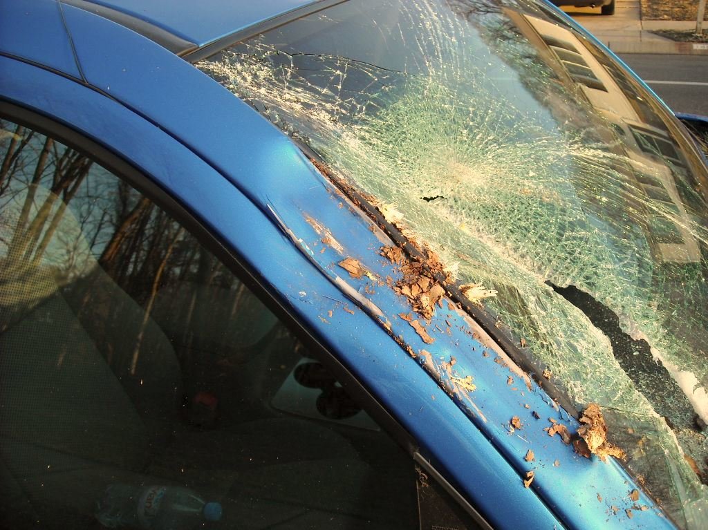

    Back in 2015 my previous 2nd Gen was attacked by a pine tree:
    It was repaired, not totaled:

    Honestly, I do not remember/recall. But it was just like new when I got the truck back from the body shop. They did a first rate repair job. It was over $7,000 in repair back then.
    I did cut down EVERY damned pine tree after that, to the west of me.

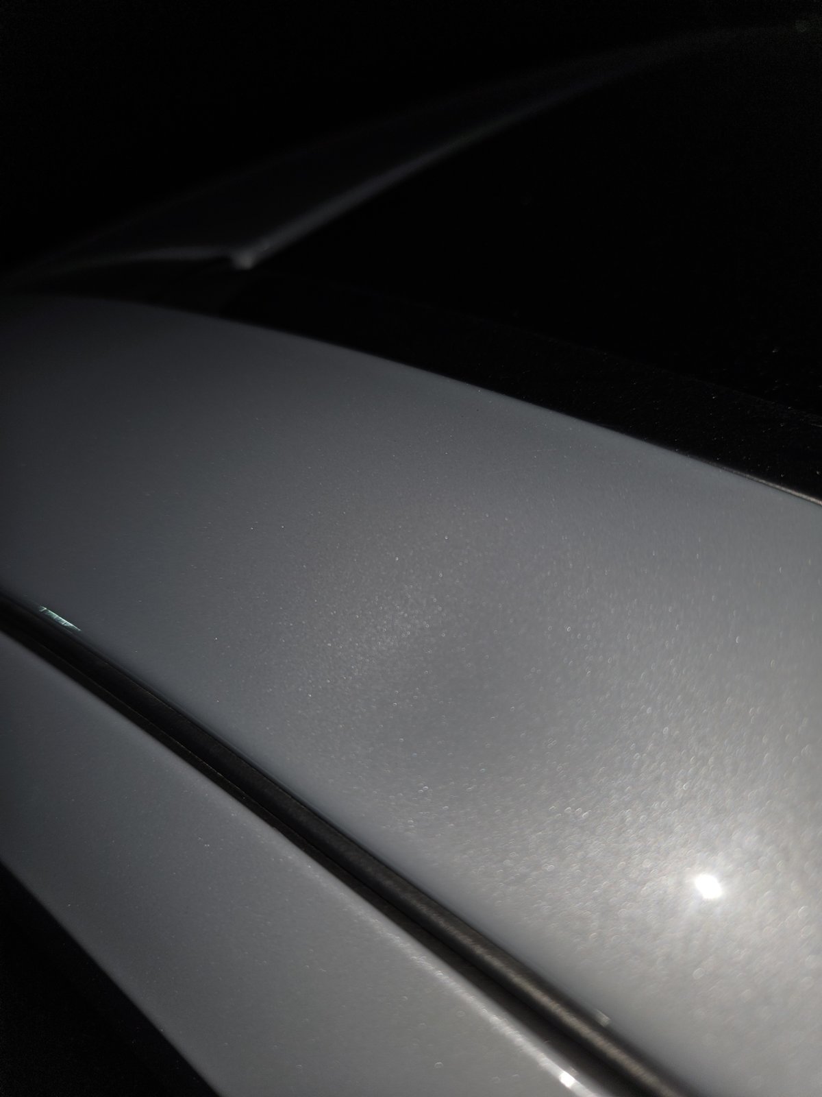

    Call around for a good PDR guy. I got this fixed with PDR and it is nearly perfect now. He spent hours on it but like I say, it came out great!

    I am of the strong opinion that can be repaired more effectively with a paintless dent repair technique.
    FYI, there is very very easy access to the inside of your A-pillars from inside the cab. Hundreds if not thousands of people who have changed out their front dash tweeters or hard-wired a dash cam or installed a D-side grab handle already know this.
    The driver side is a no-brainer. That is very correctable from inside the A-pillar IMHO and can be peened out from inside the cab. I could get to that from inside in less than 30 minutes and that would be taking my time. The pax side will be a little more difficult because it is lower to the cowl and might require more interior dash disassembly or some bent tools. But same concept.
    PDR shops are also doing crazy good things with glue sticks and heavy duty magnets. Again, I would absolutely NOT cut your A-pillars apart. And, no, neither one is metallurgically deformed beyond a yield point where structural integrity is compromised. Last but not least, do not discount the concept of body-filler and a localized re-spray if a PDR technique is not perfect. A-pillars generally take a beating from the weather - so some may disdain this concept and I would understand. But this is 2024, not 1974. The materials are so much better and paint matching is a snap.
    Either way, having your body hacked apart and the bed-removed is completely non-sensical. Even though the bed can be removed by 2 body shop trainees in <30 mins. It is not that hard.

    I got a guy come out today took him about 2 hrs but he got atleast 95% of it out most people wont be able to tell it's there now. He said since there if there was access to the back he could have done the repair in 30 mins
