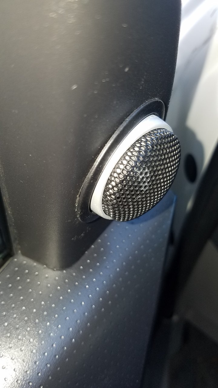

    I put my Tweeters in the black mirror back covers and the Sound Stage is amazing.

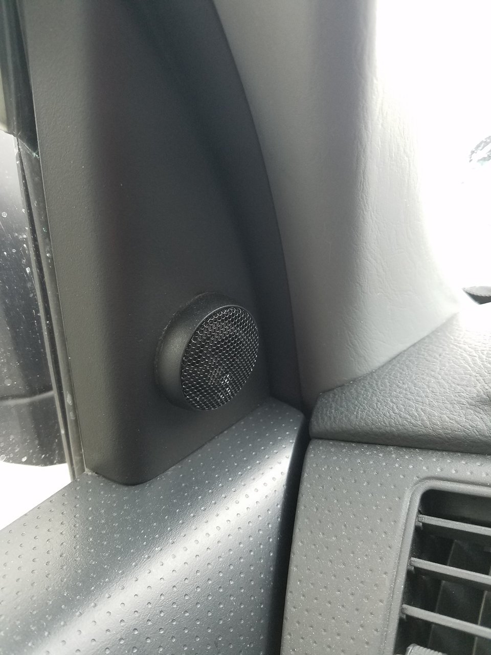

    Thank you sounds killer to, here it is installed

    Yes they would as the sound bounces off of the dash

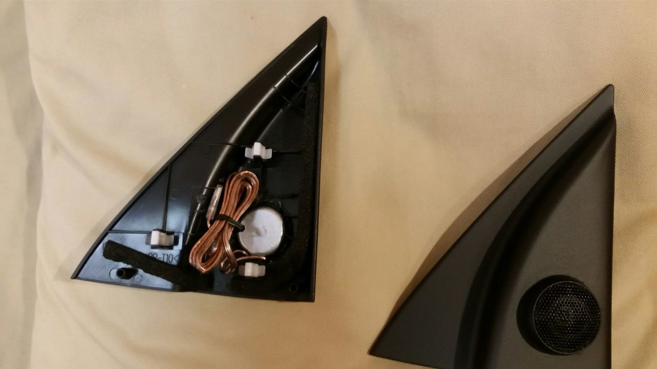

    You won't regret it, just be careful taking off the triangles as there are little white clips on the back of them. Sometime's they pop off, and sometime's putting the triangles back on the little white clips fall inside the door. If you need some throw down clips, I have a whole box of them. What I did was get a hole saw smaller than the circumference of the tweeter, super glued it on and viola. But after I cut the hole, I spray pained the triangle flat black to match the dull shade of the tweeter.

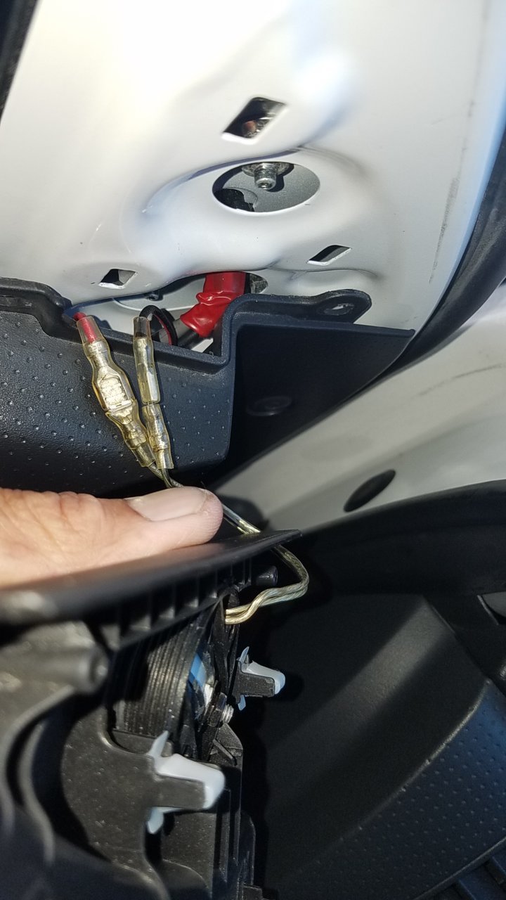

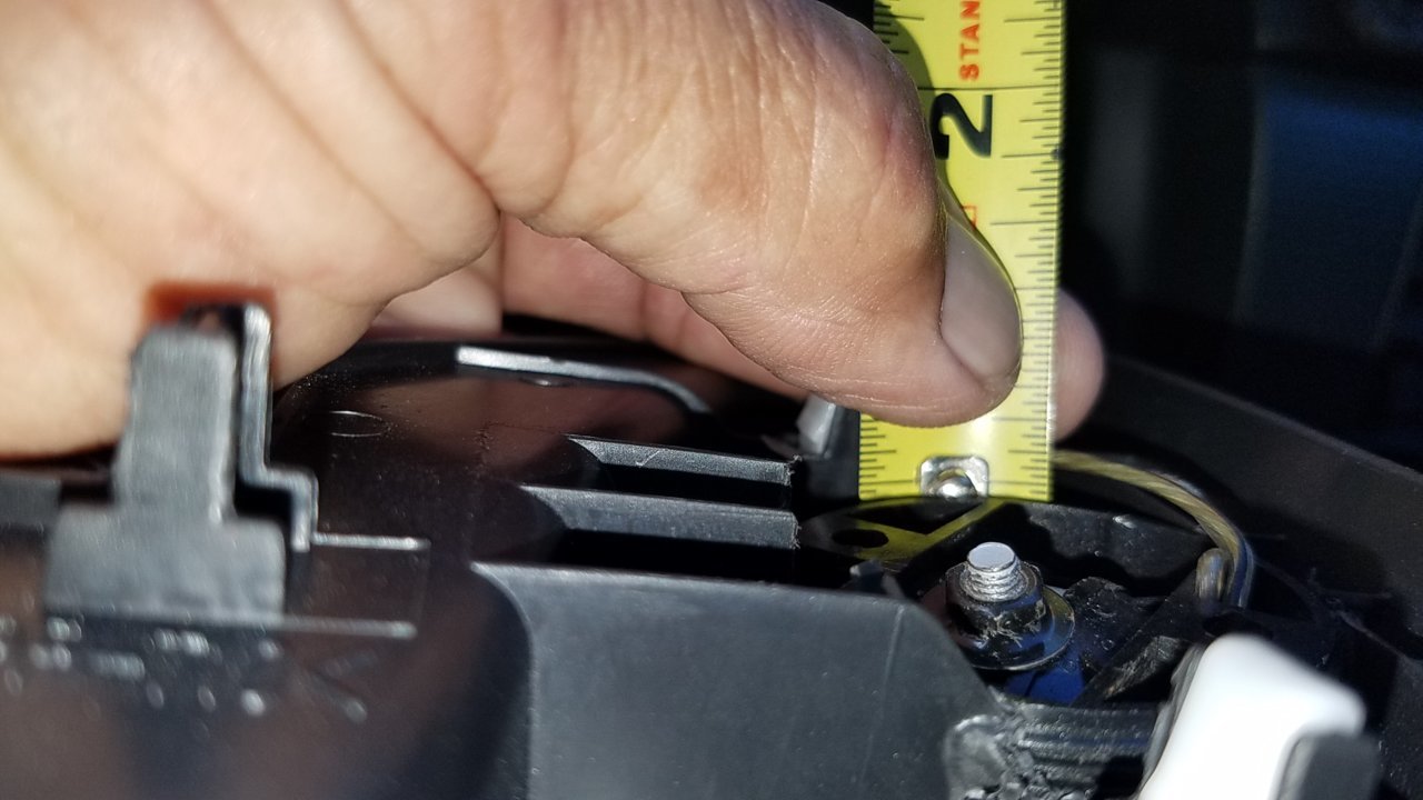

    Best bet is to take off sail panel and put tweeter on bottom of sail panel like how it would mount if you had cut hole and were to mount it or take off sail panel and measure how much depth you have to mount knowing the depth of your tweeters.
    Maybe latter can pop off mine and take pic of how much room you got to play with.

    Op you got about 1/2 in. clearance .Also be aware of were you cut whole

    Thank you!! That looks good!! I think my hertz tweeters will work..I see what you are saying now!
