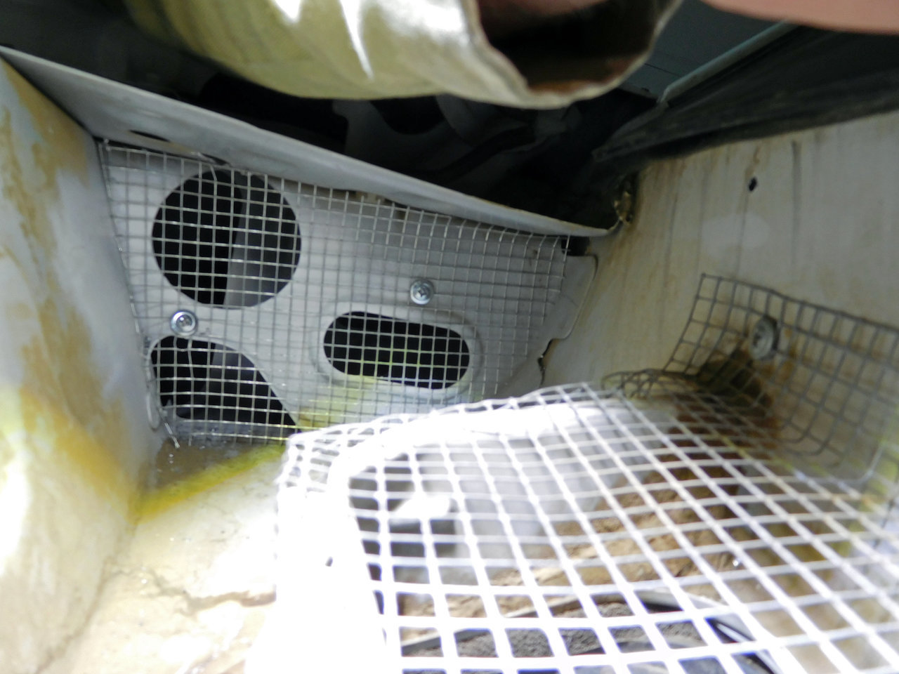

    I screened off my cabin air inlet, but yes, they get into the cowl and still create a problem. I would also suggest screening the entry into the cowl on each side. Better to keep them completely out of that area. See pic below.
    Natures miracle, as suggested for the smell.
    Then install these: https://www.amazon.com/gp/product/B074WLBMKZ/ref=oh_aui_detailpage_o03_s00?ie=UTF8&psc=1
    This multi-prong approach has completely eliminated all traces of rat and mouse activity. I mounted one of the sonic deterrents in the engine bay and one underneath the truck near the transfer case.
