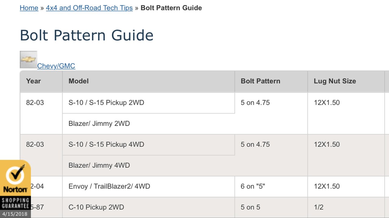

    Arent S10 wheels a 5x120 bolt pattern?

    All the places I have looked list S10 wheels as 5x4.5, same as Tacoma. All aftermarket though, such as tirerack. FYI, they (tirerack) do NOT sell any wheels that do not use adapters! I will not use any wheels that require them - fail tech inspection at most competition events, apparently not some off-road however...

    Yeah s10 isnt the same as us

    Wow, I don't know how I misread that - I blame doing my taxes, form 1040 causes brain rot.
    Saves me hoisting a wheel and doing the jiggle and wiggle until I notice the pattern is just a wee bit off, like me most mornings.
    I could have sworn the S10 said 5x4.5 - ah, well, I will put those rims on CL.
