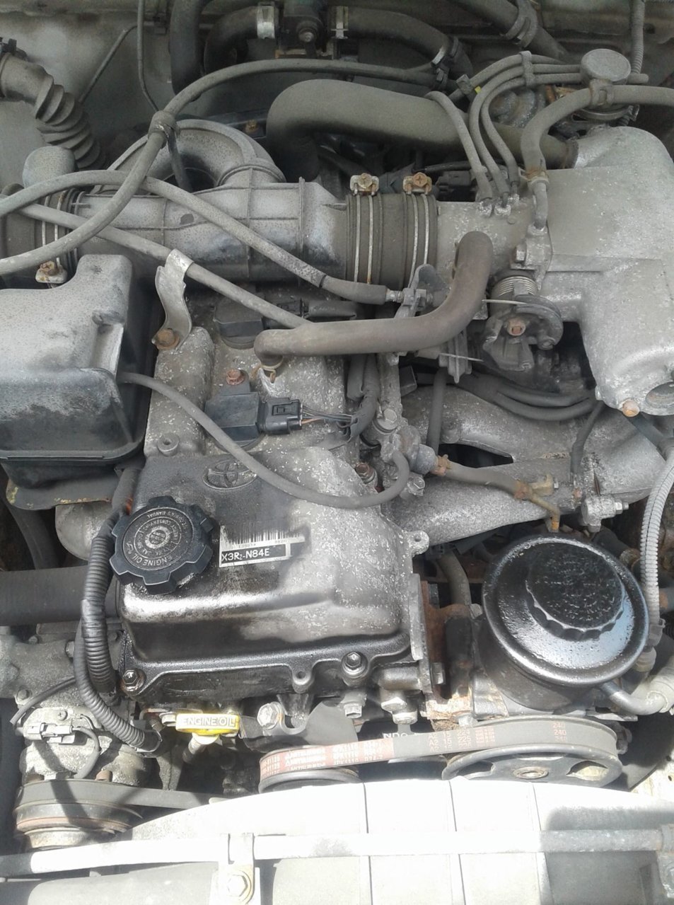

    I've been told that I have a valve cover gasket is leaking and I plan on going balls deep and replacing the gasket, the big quesion is should i change all the other gaskets on the engine, ive seen some kits for sale with a whole bunch of them.

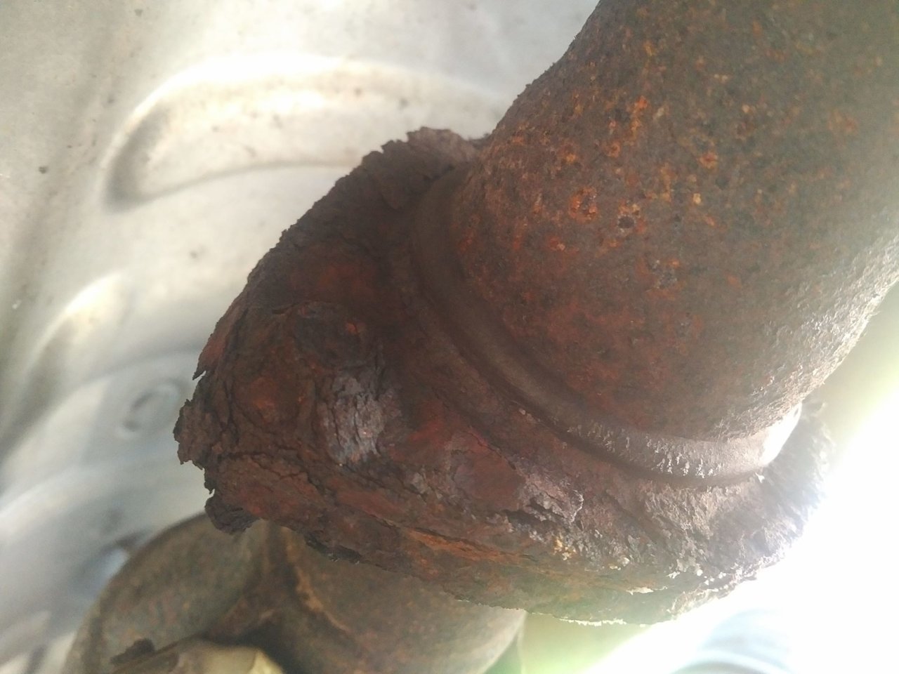

    Loking under the the beauty I'm greeted with this too
    the muffler makes less noise then my GFs honda civic, but damn this is rusted to shit, is it worth replacing/repairing?

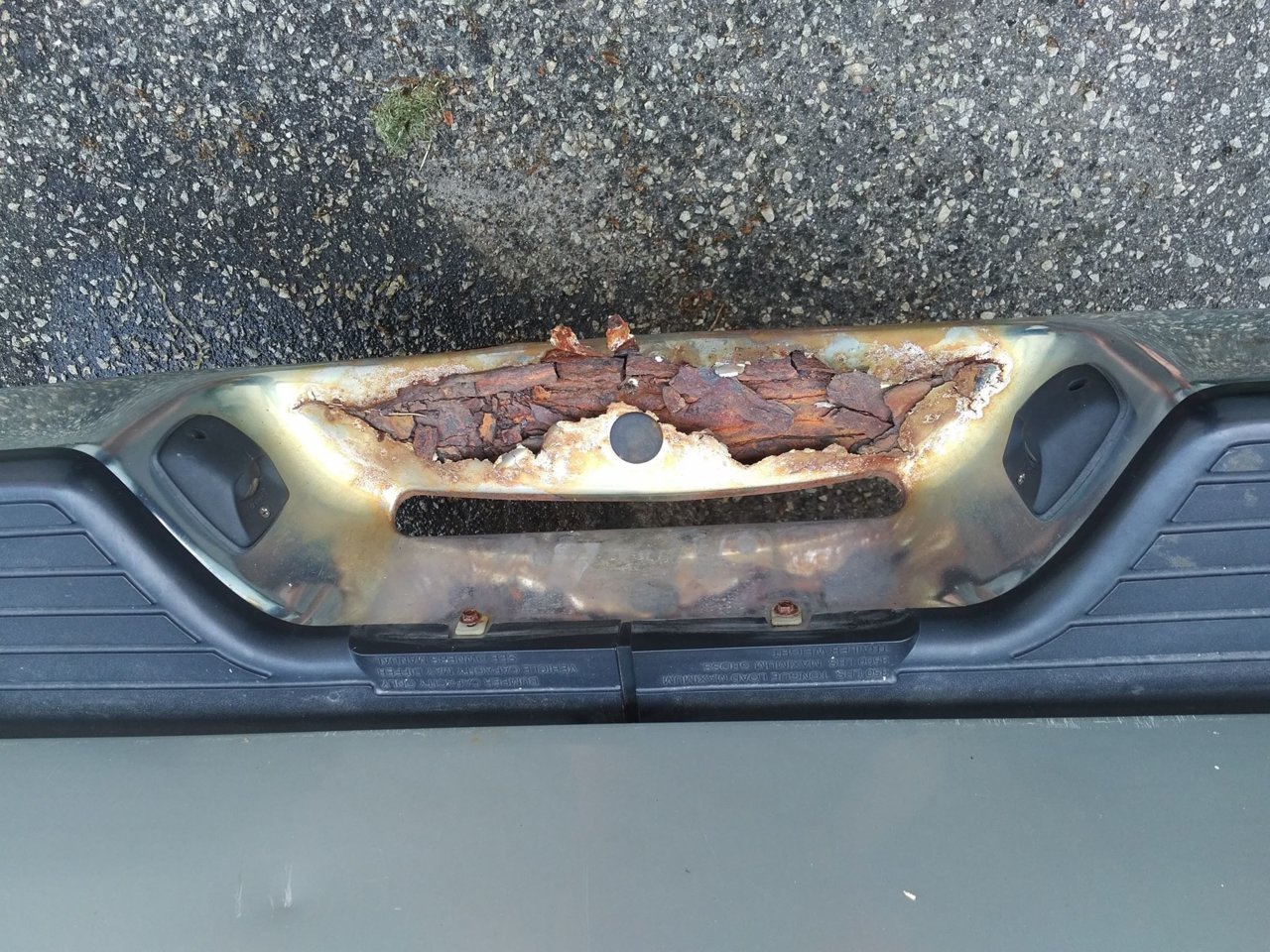

    My rear bumper has a whole rusted through it, the chrome is keeping the rust in. I just want to replace the bumper with anything really.

    Replacing all those gaskets in that kit is a really big job, especially if you're new to this. I think if your truck is running well, and doesn't have other major leaks, your best bet is just to do the valve cover gasket at this point.

    •Great after market rear bumper (on my truck). Almost identical to stock and great price:
    https://www.amazon.com/TKY-TY40342C...rds_browse-bin:4709468011&s=automotive&sr=1-8

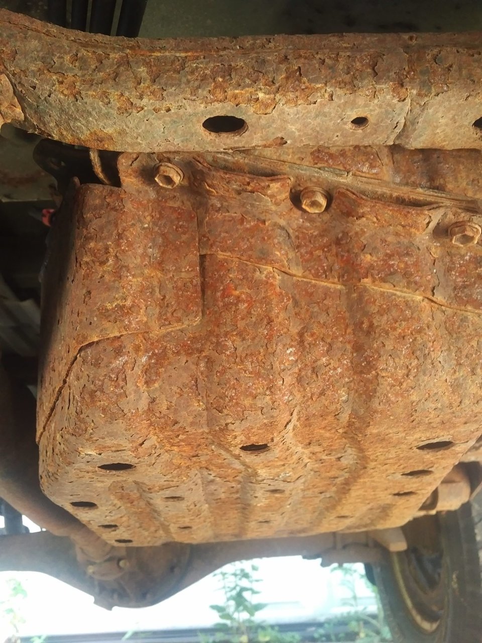

    Also what does your frame look like? That is heavy duty rust on the bumper/muffler.

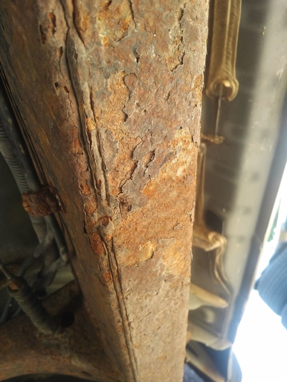

    @Currygoat the frame isnt too bad, or atleast not by my standards as a canadian.

    Your frame looks toast dude (or very near death). I would be worrying about that and not the valve cover gaskets and bumper.

    @Currygoat ive been tapping it rather agressively with a hammer there hasnt been anybreakthroughs yet and ive gone over most of it

    Get after it with a 4.5” wire wheel and go from there. If there’s solid metal coat it.

    Coat it and then plate it with Safe T caps! These frames rot from the inside out, I'd worry like crazy about that :eek:
    OP you say that's decent by Canadian standards?!?!
