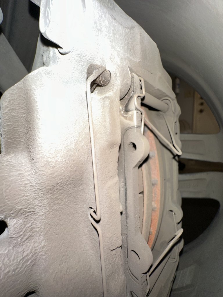

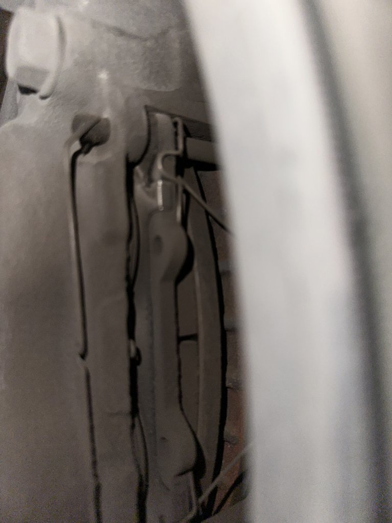

    OP. Here a couple quick pics. Next I could get with the wheels on. Also put my hands on the pads and there is no play in them. IMG_3180.jpg IMG_3179.jpg

    That is the perfect angle.
    It shows me that the spring should at least be clear of the pin.
    Do you have the part number for those springs?
    It's weird, because my factory springs definitely didn't look the same. And the crappy O'Reilly ones I'm limping on aren't right either.

    Thanks, I got em.
    Man, you really ~~can't thru~~ came through with that photo!
    Thanks a million, man.
