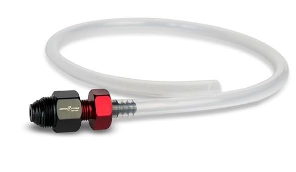

    Yep, you should be good. The O-ring on the larger canister creates quite a bit of drag in my experience. This drag surprised me the first time. The little drain plug should come loose first. Also, since I don't think it's been mentioned yet, the Motivx filter drain tool works really well to drain the filter canister before removing. Super clean and easy. Toyota provides a little plastic drain tool that was much more messy for me. Good luck.

    get the MotivX kit

    The MotivX tool helped pre-drain some oil before I removed the plastic housing.
