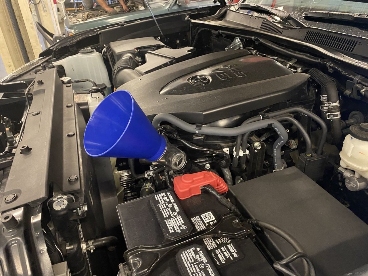

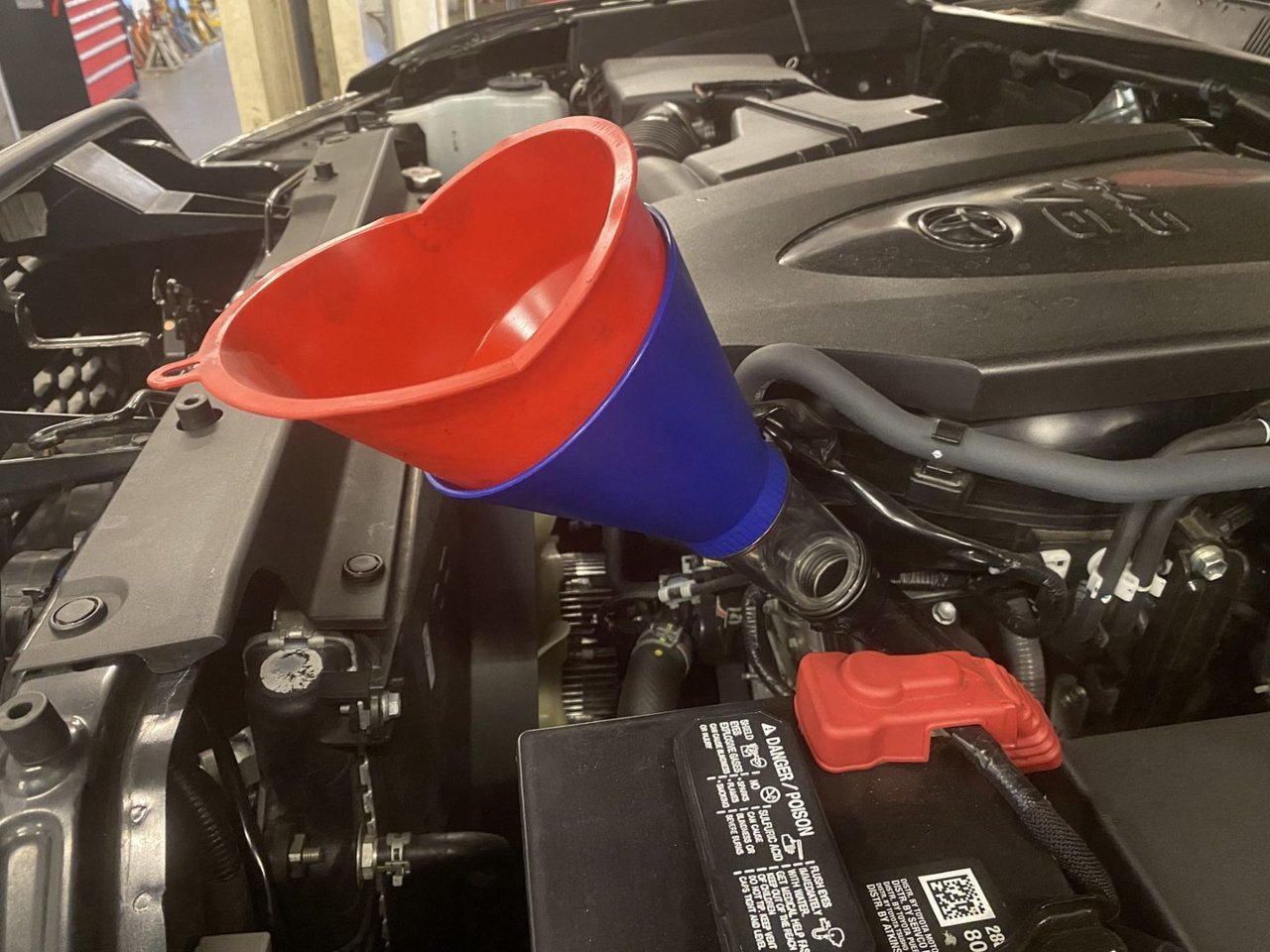

    I used an additional funnel at the Auto Hobby Shop on Dover AFB. It provided less mess when I went to pour the oil.
    BEFORE
    AFTER
