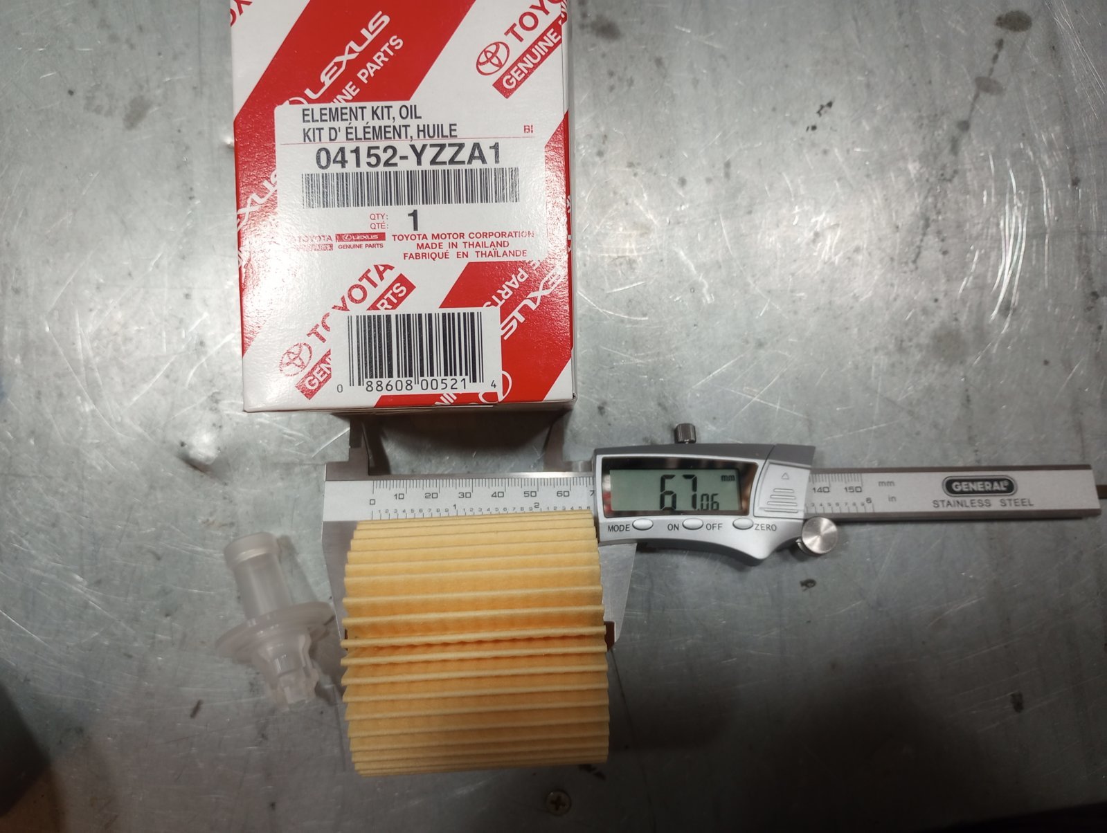

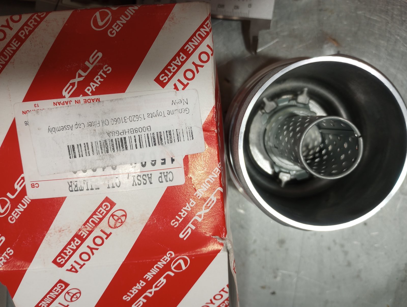

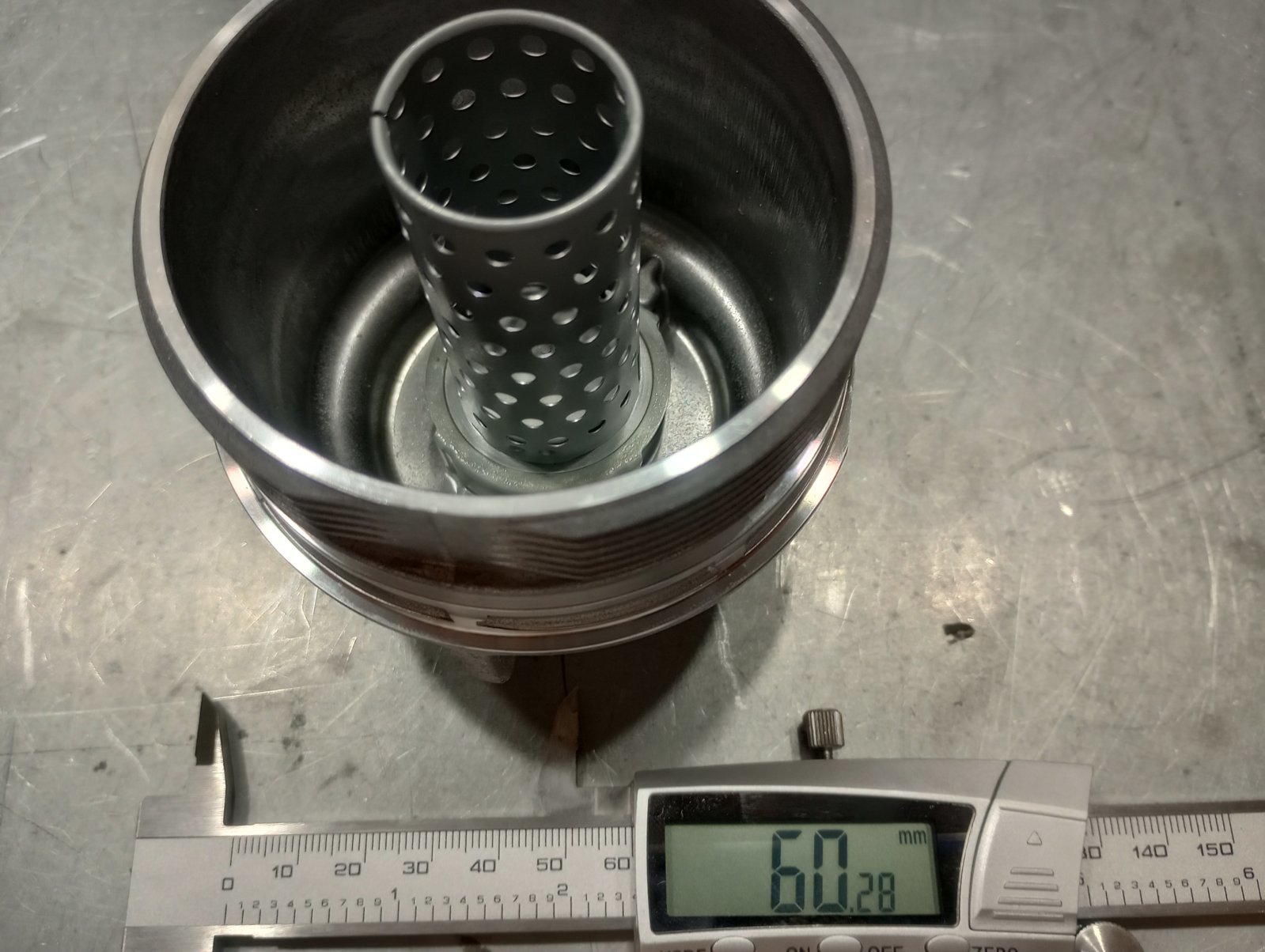

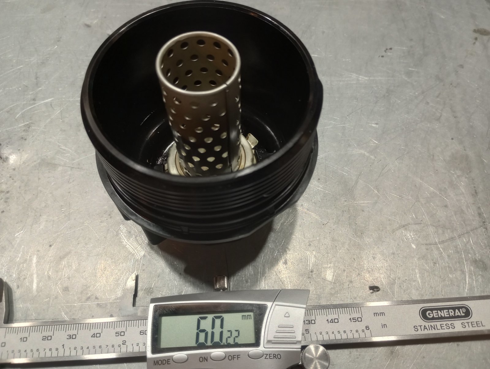

    I had more time today
    I have not taken off the plastic oil filter housing on the Taco. Dealer did last Toyota care oil change on it today.
    But 20014 I4 RAV4 and Taco call for the same filter.
    So I measured the center tubes in the RAV4/Taco aluminum and plastic housings and filter.
    Sizes are in Milimeters.
    Filter was measured from the glue ring to the glue ring, the longest part of the filter.
    Support pipe was measured along the side, outside the pipe to its flange.
    IMG_20231120_160315214.jpg IMG_20231120_155650519_HDR.jpg IMG_20231120_155739198_HDR.jpg IMG_20231120_160255128.jpg
    TacoTime55 likes this.

    1,855
    NW GA OTP
    Manufacturing or measuring tolerances. I could have made those numbers be the same if I had applied varying degrees of pressure on the micrometer. Central pipe is the same in plastic and aluminum
