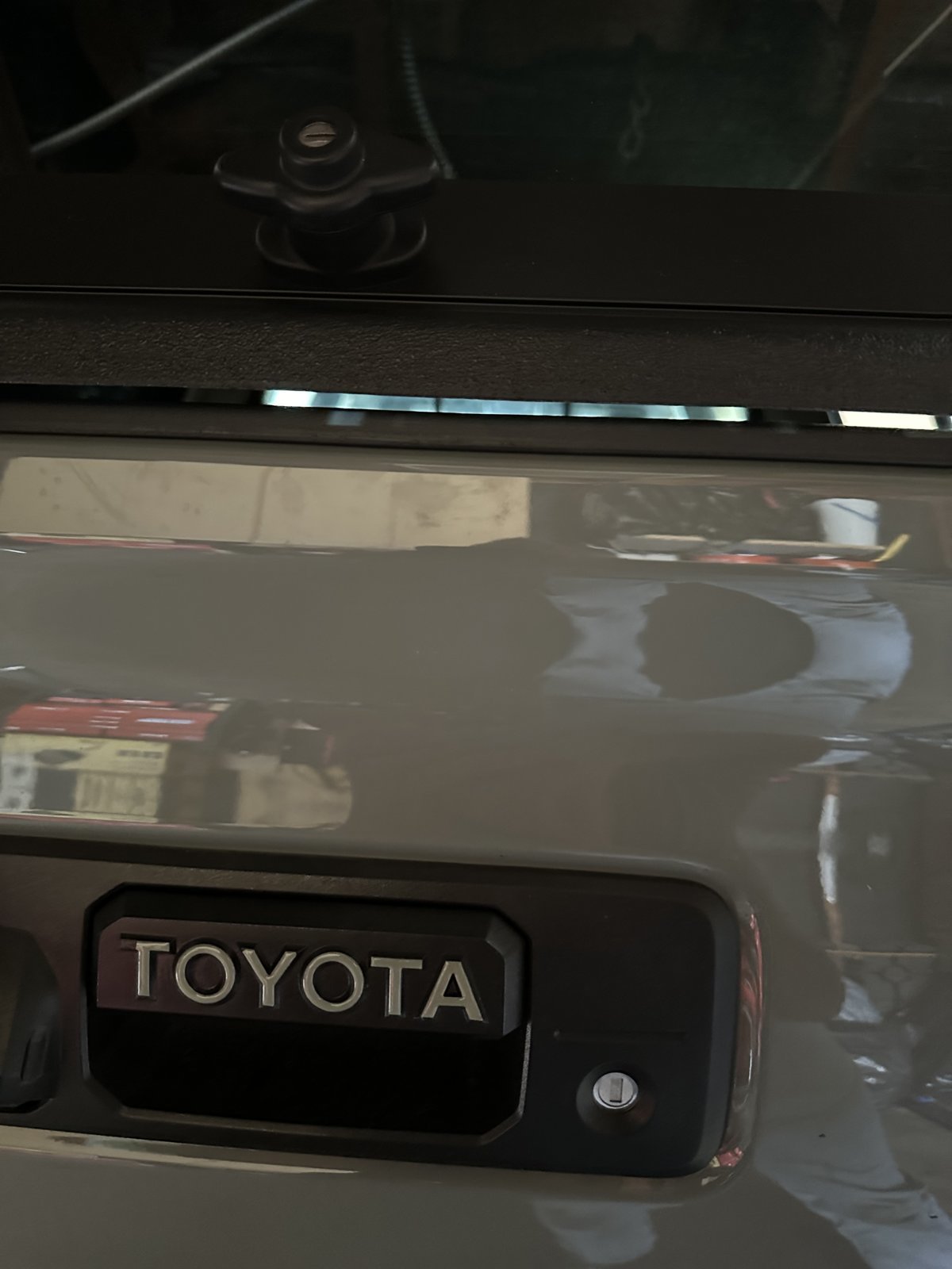

    I bought a used A.R.E V series cap and put it on the truck today and the trim piece on the bottom of the back window sits just above the tailgate which leaves a pretty big gap, the whole shell seems to sit a bit high.I’m using the double bubble seal. Is this right or is something wrong here?

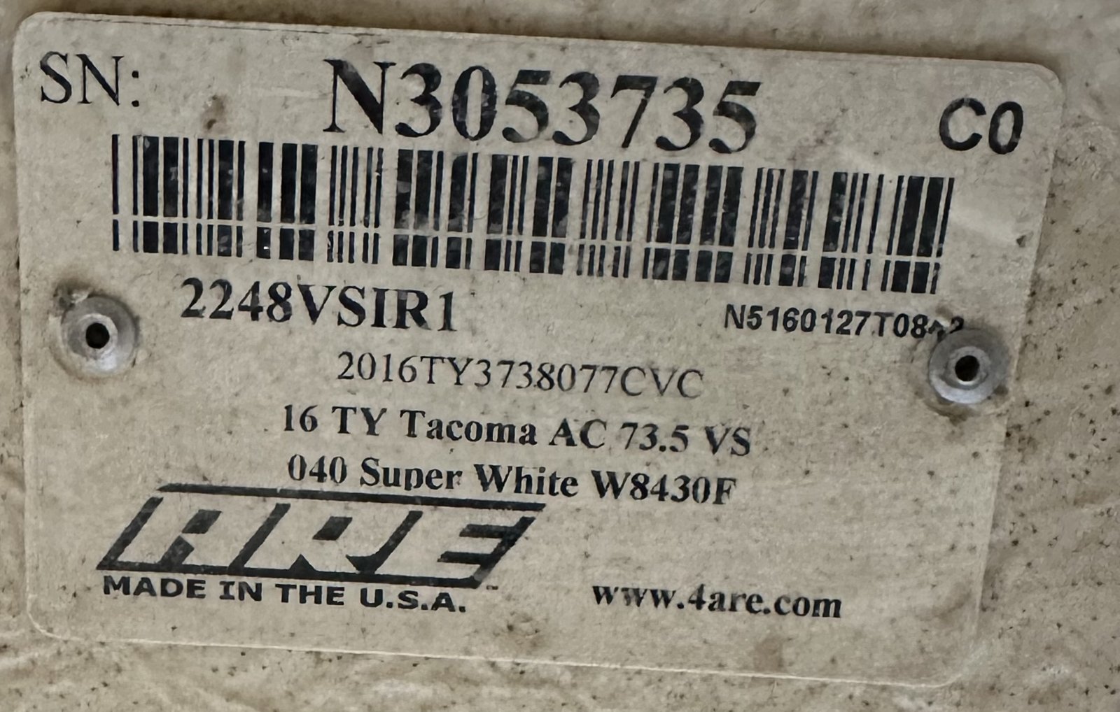

    Tag has a 2016 mfg date and says Tacoma. I’m using that double bubble seal.

    The label says that shell is made for Access Cab Tacoma.

    Yes ,but I can’t see what difference it makes with how it sits on the bed, the beds are the same and according to my research AC and double cabs shells are the same

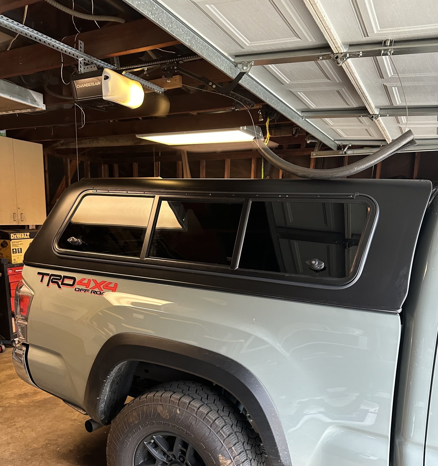

    Side view, best I could get at the moment as it’s pouring rain

    Looks like it sits too high, take it to the dealer and they will take the shell off and replace something underneath the shell.
    I noticed the gap between shell and bedside.

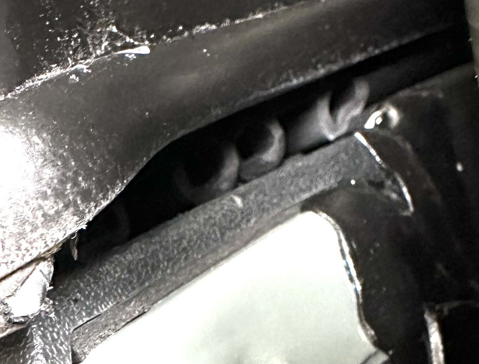

    As you can see here the seal is barely compressed even though the top is snugged down pretty good. Not sure if it could be the problem but I ran two strips of the seal side by side, I had 35’ of it so thought what the hell

    That's the problem, too much of seal. Try replace them with one seal strip all the way around.
    Edit: No need strips on tailgate, though.

    I didn’t get a great price on it but didn’t get screwed either but I did put some work into it. I’m thinking the seal is too thick and too dense of rubber, the ESI brand I used before on a different shell was a lot more squishy than this stuff
