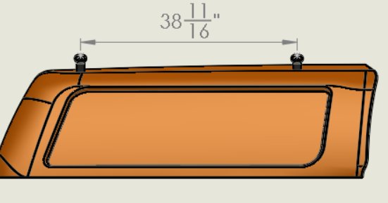

    Hey everyone, I placed an order for my truck a few days ago (TRD Pro 6MT). I'm looking at caps right now and the CX HD seems the way to go because of the roof weight capacity (moving the RTT from my Sportwagen to the truck). Does anyone know the approximate weight of the CX HD and distance between the stock HD crossbars? I've looked all over A.R.E. and can't find the info. Thanks.

    Thanks Broccoli. The CX-HD has an optional stock crossbar connected to the skeleton with a rating of 550 lbs. They're not on rails like a "normal" setup. My tent has a max distance of 3ft. Not sure of these are within that range - they look pretty far apart in the photos. Would be nice if A.R.E. provided detailed specs. Any idea what this cap weighs? Trying to calculate payload stuff.

    This is what the supplier sent me when I asked the same question about distance between the HD bars on the ARE CX HD . This would be for a short bed truck .Capture.jpg
