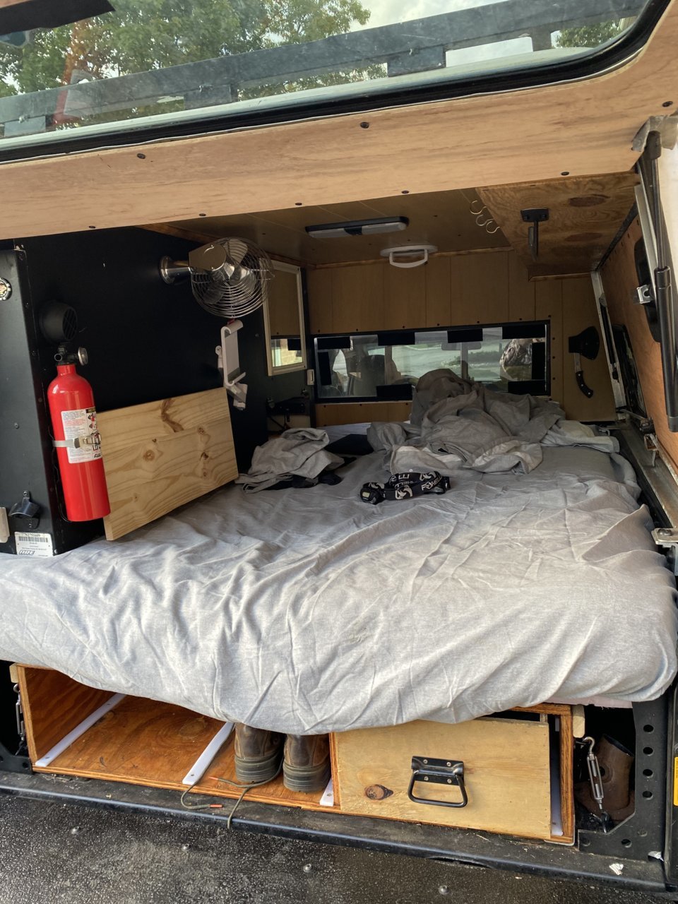

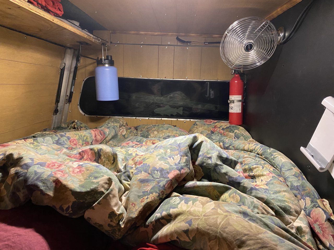

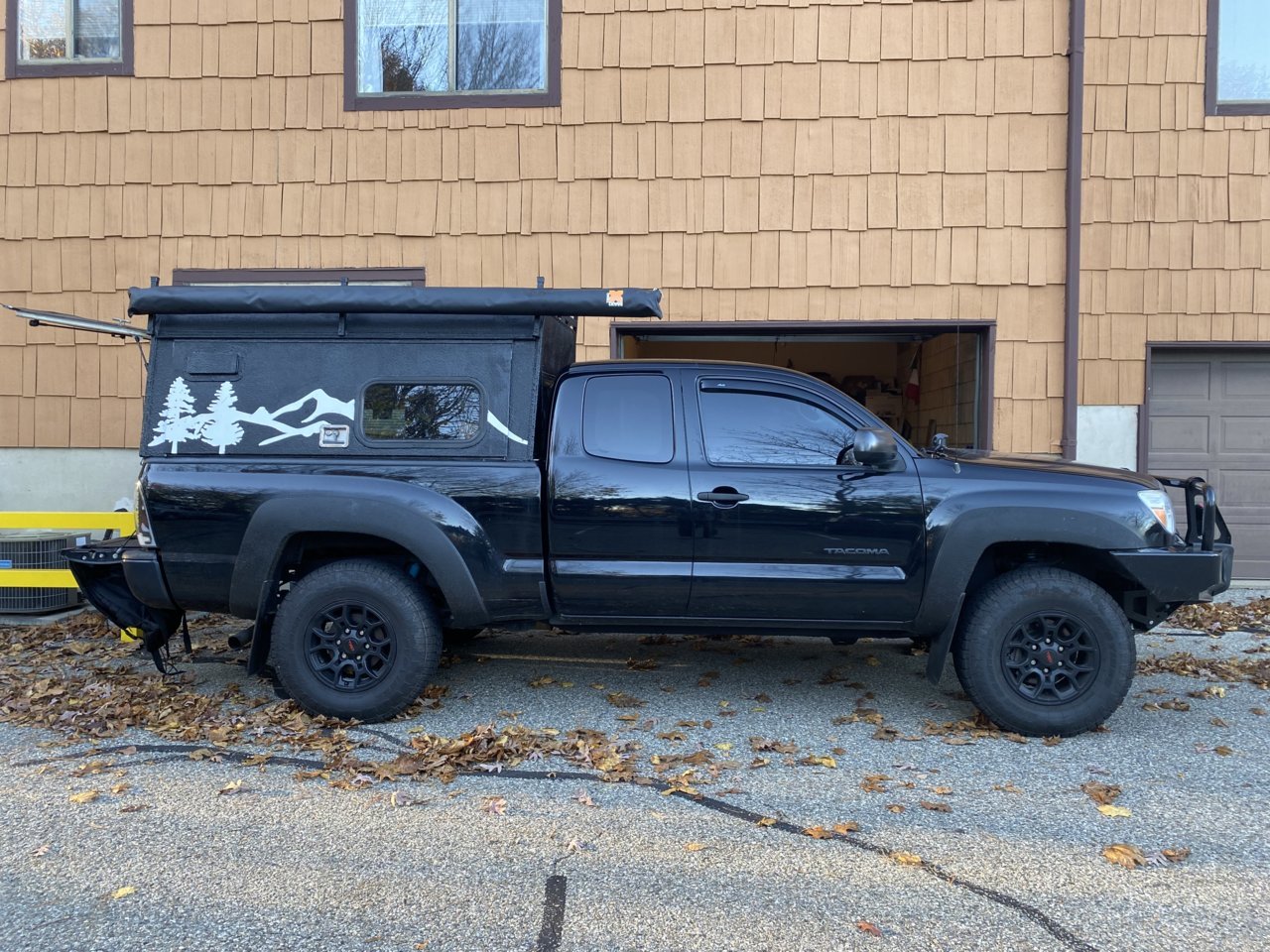

    Been a little while since I updated, but the camper has done two trips so far this year up to Vermont and New York. Stayed super comfy and the cap stayed well insulated and comfy (no less than 68 degrees all night on ~52 degree nights). Enough room for me my girlfriend and dog to sleep comfortably. Not spread eagle by any means but I wasn’t cramped at all, even with the toolbox.

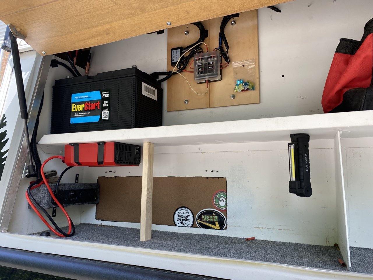

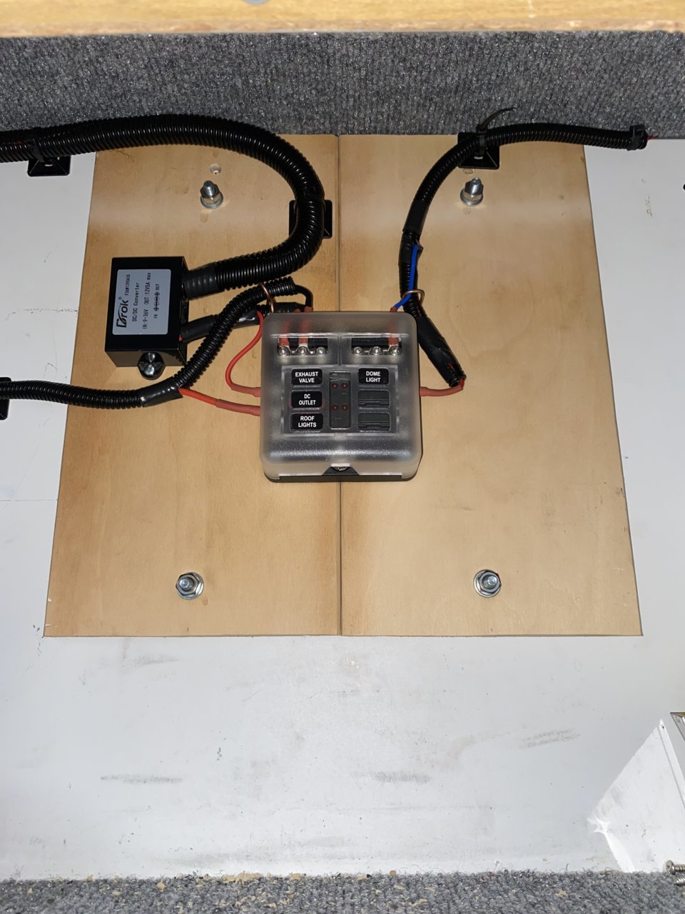

    Wired up all the electrical things and purchased a deep cycle 107ah battery. No solar or anything yet but I can do a few days trips on a fully charged battery.
    Added a fan, fire extinguisher, and an iPad mount.

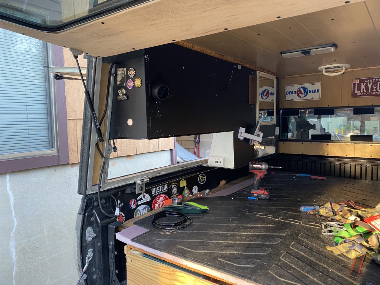

    Some serious stuff in the works. I’ve gone ahead and ordered all new D shaped seals for the windoors. Seems to be holding up well. Passenger window leaks in the shell, I’m thinking some silicone will do the trick. Also a front rail seal, and butyl tape/silicone for where the cap meets the bed.
    I’ve removed the water damaged panels (just the 3 doors) and intend on replacing with some 5mm plywood I bought which will be sealed with an all natural low VOC sealant. Each panel is going to be put in with a bead of silicone behind it. Made some reflectix curtains that stick to the windows with Velcro.
    Also going to be adding a locking folding shelf to the passenger windoor, as well as pop out aluminum vents on both windoors (for cross ventilation and help exhaust fan). Toggle latches for the inside door so we can lock ourselves inside.
    But what I’m most excited for is 100w of solar + 40a MPPT controller from Renogy to recharge my 107aH deep cycle battery. Panel should fit perfectly on my roof rack between the supports.

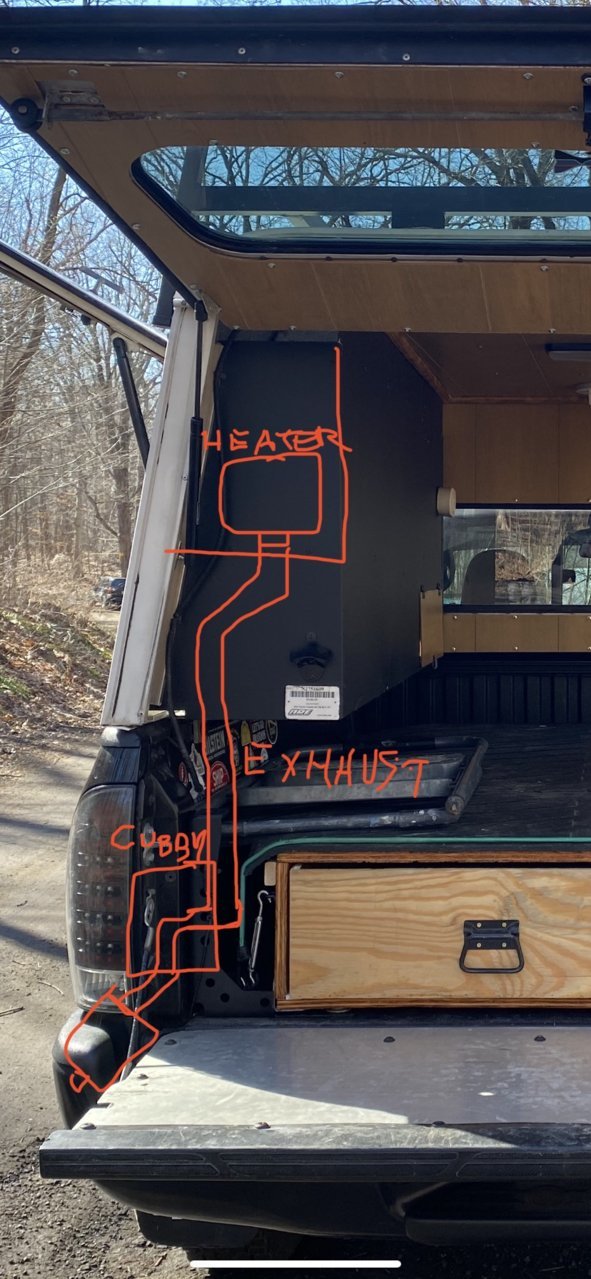

    All of this is going to power my electronics and fans, but also ordered up a diesel heater. Still figuring the exact routing of this, but the toolbox seems a good candidate for where I’ll mount it. Routing the exhaust is going to be the biggest challenge, but I’m stoked nonetheless.

    Went up to Vermont again this weekend. Dropped to 32 at night but stayed 52 in the camper. Still, there was condensation on the single pane windows and a tiny bit on the ceiling. This is with 2 humans and a medium sized dog breathing in it without the exhaust fan running, just popped open. Fairly impressed how little there was.

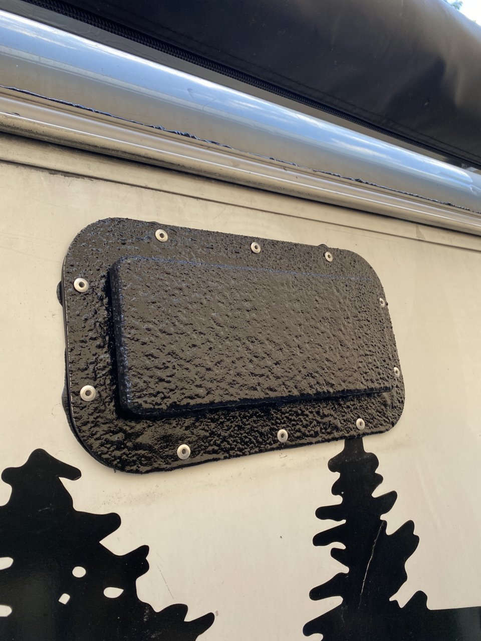

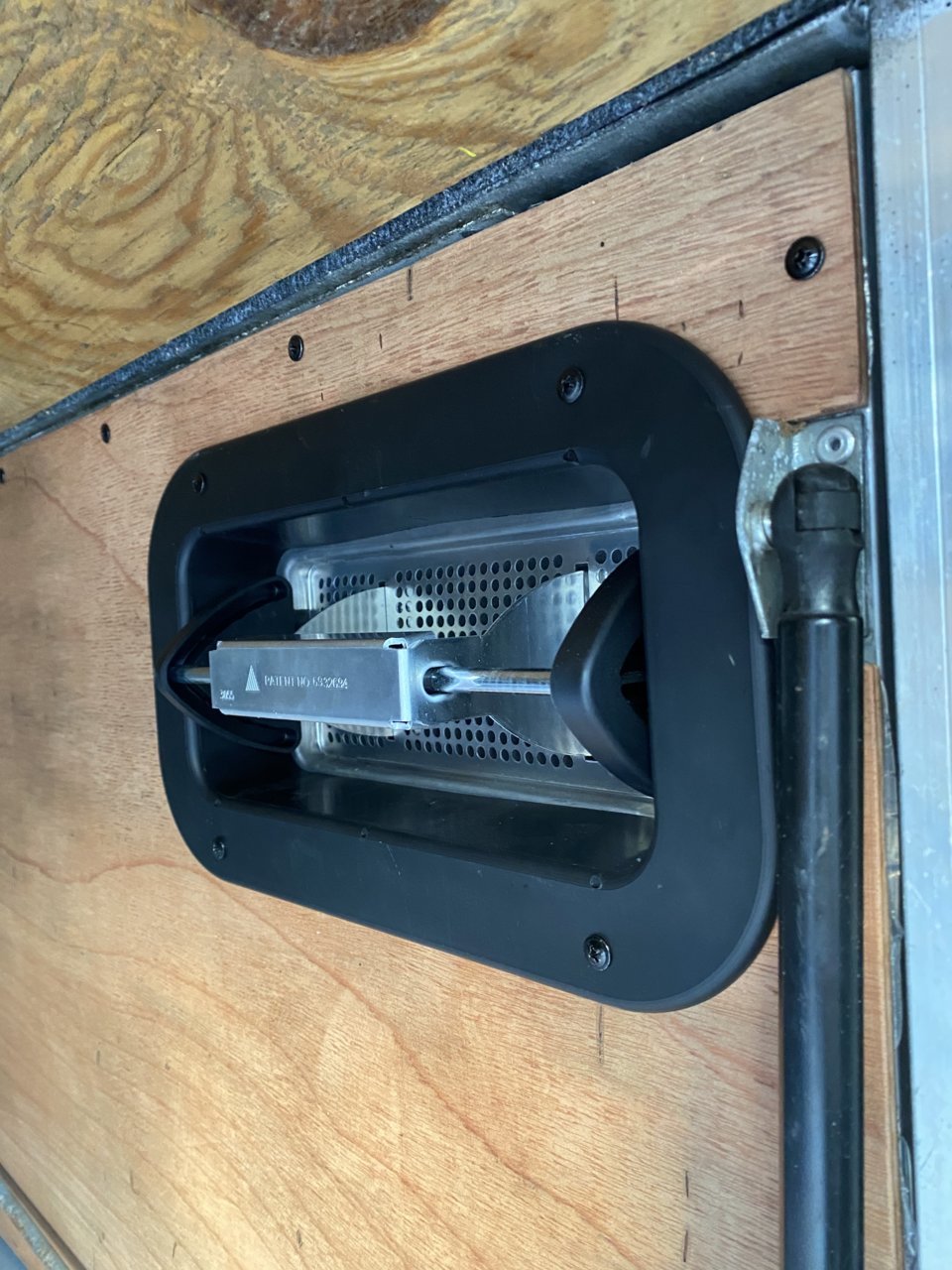

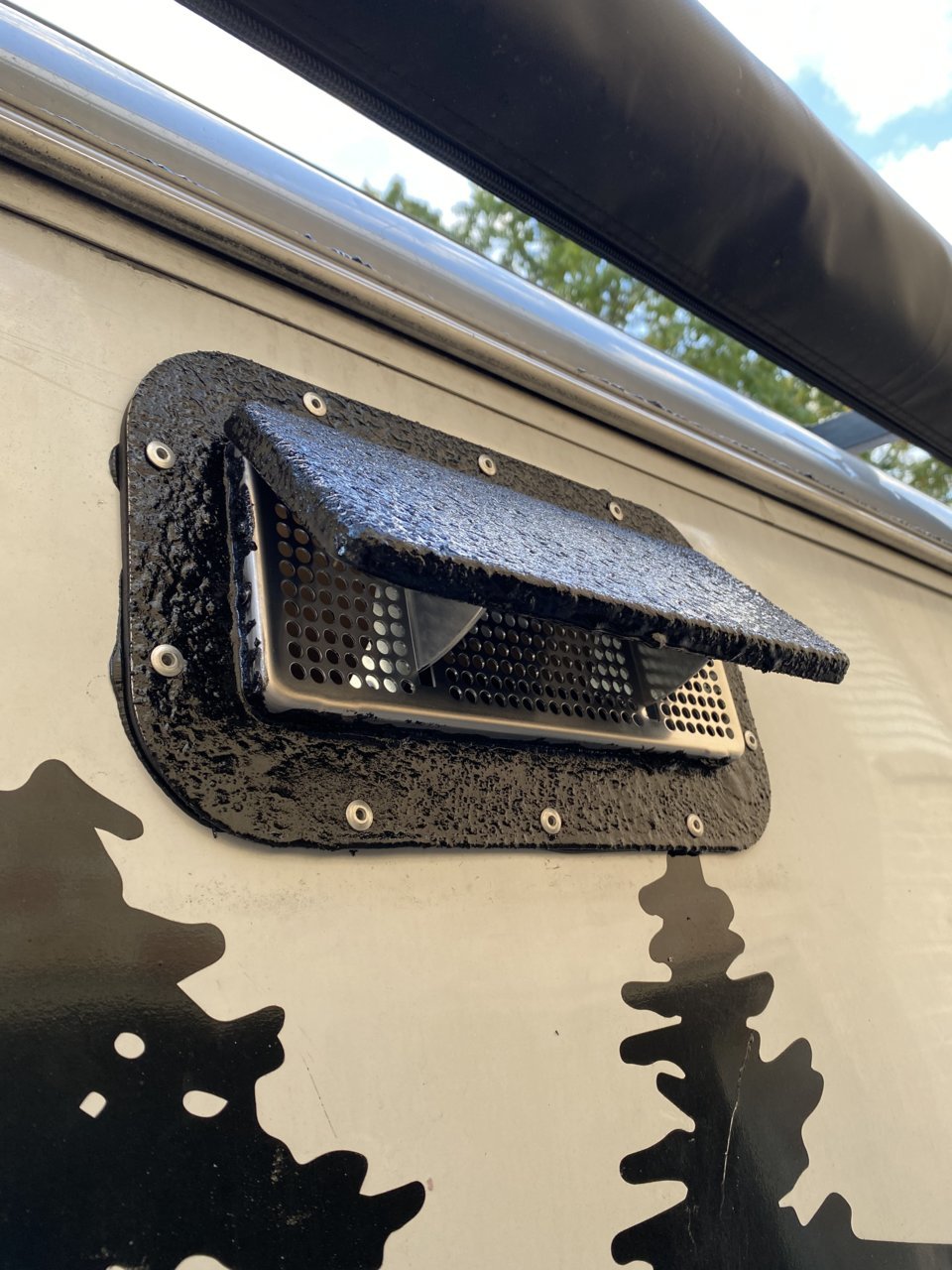

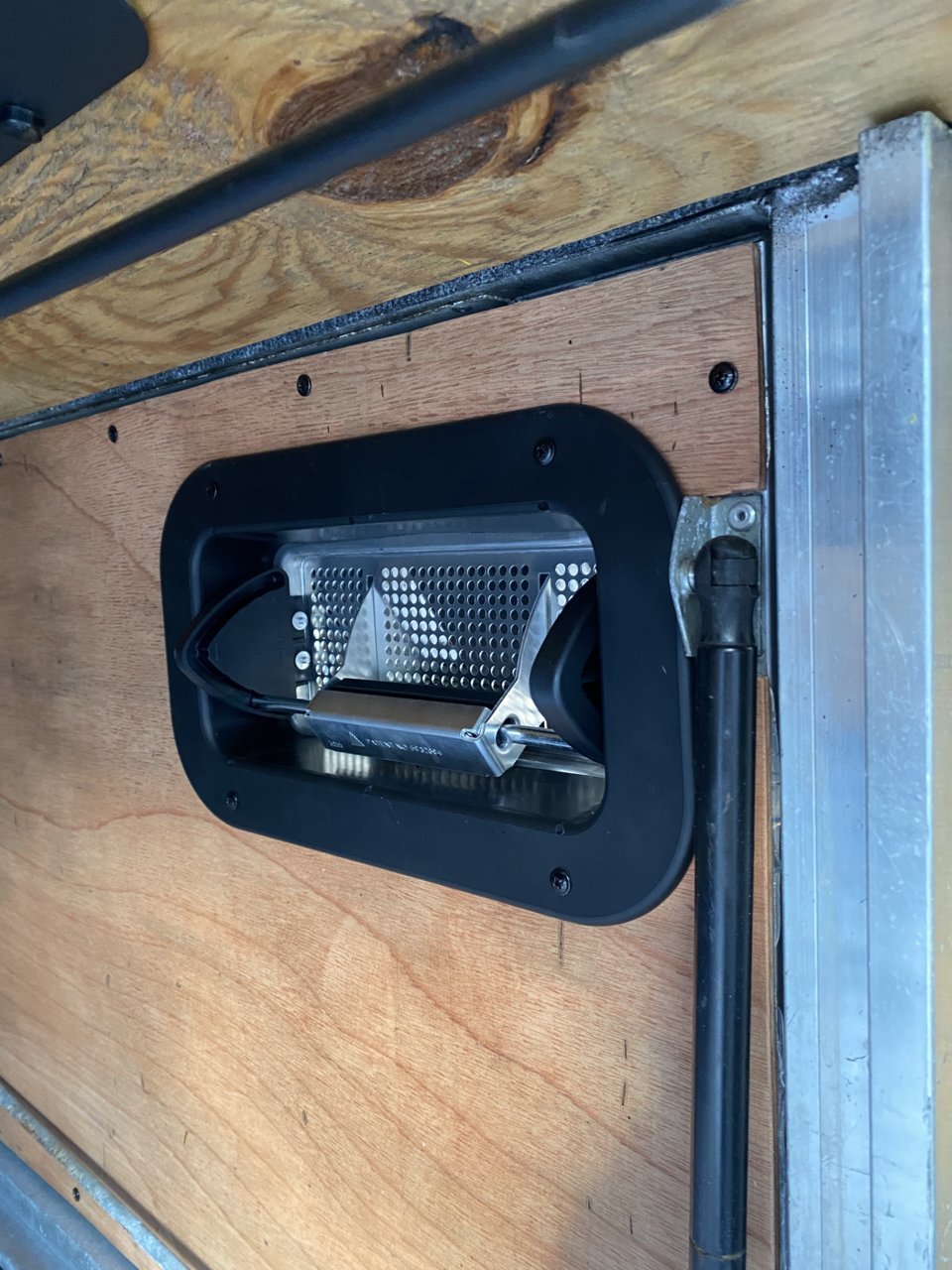

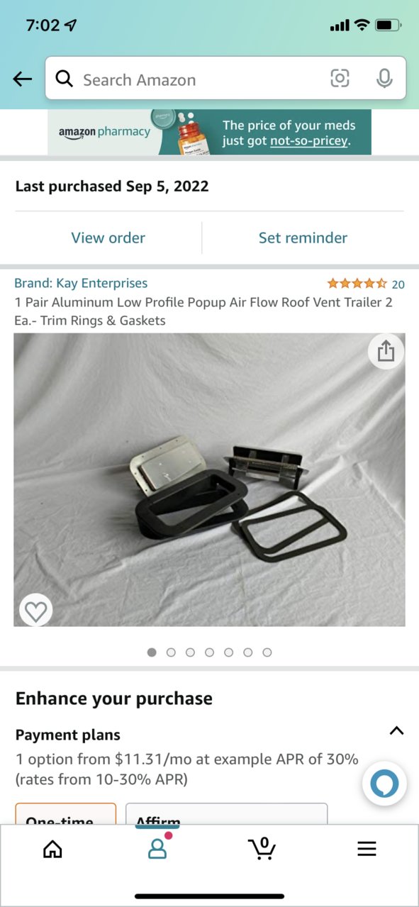

    Got me motivated to install the aluminum pop out vents today anyway. One on each side, driver side vent is low so that I can access it from that cubby cutout in the toolbox. Hopefully the lid is pretty waterproof (it has a neoprene gasket behind it).
    Also added a folding shelf and remounted my fire extinguisher. The diesel heater is in the works, I still have to cut the hole out the cap for the exhaust, mount the tank and run the wiring. The hot air vent for the heat exchanger is right above the fire extinguisher. Solar controller was mounted inside but I haven’t put the panel on the roof yet. More to come in the next couple weeks.

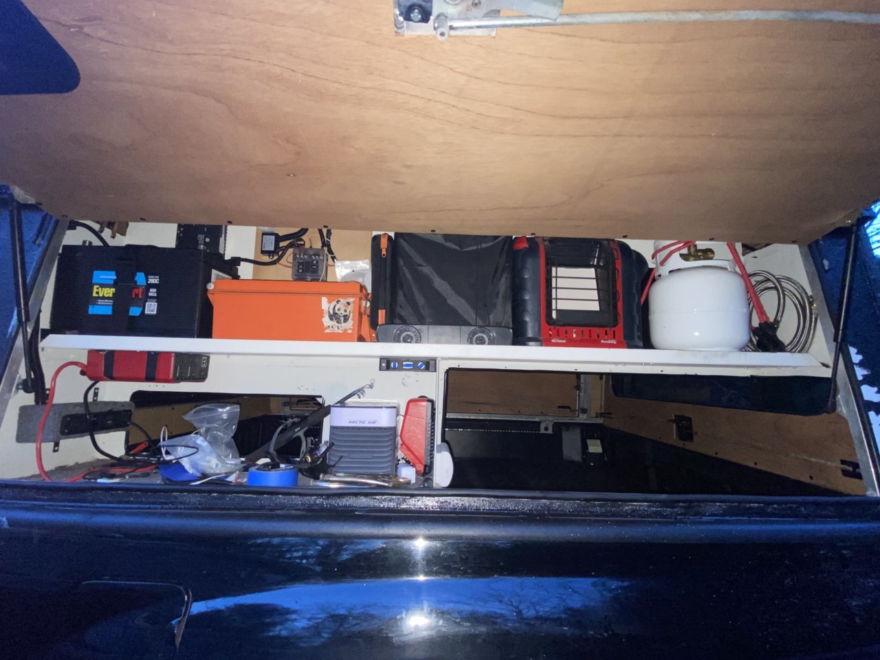

    Few things have changed with the camper. We actually painted the whole thing with bedliner. Leaking was an issue and I couldn’t pinpoint it to one source. I caulked every gap/crack/joint on the outside of the cap, as well as the roof rack, and then sprayed it all down with Flex Seal. After that we bed lined it. Currently the passenger window still leaks a drop, but I’m considering taking it off and resealing or just tightening the screws holding it in.
    Where the cap meets the bed rails also got sealed. Used 1” wide butyl tape under the cap with a bead of silicone, and then put 2 more beads of silicone on the inside and outside along the gaps where it sits. I purchased a front rail seal, cut that at a 45 to taper where it meets the side rails, and used silicone on top of that where it meets the cap.
    Lower shelf got cut out for more space for me, girlfriend and dog. I could either cram more useless stuff into that shelf or stick my dog over there. Chose the extra space. The folding shelf was put back into place after the photo was taken. Still unsure on where the fire extinguisher will go.
    The diesel heater idea is getting ditched for now. Between the extra fuel source and likely the excessive heat it would put out, it’s not worth it currently. 2 humans + a dog and a 0 degree bag should be just fine for most of where we’ll be. My 5lb propane tank will take its place on the shelf. The hole where the vent is will be where I pass thru my 6’ propane hose adapter to work with the stove and a small buddy heater on the shelf when needed. I know the controversy about buddy heaters and CO, but it will only be used at night to warm up the camper & in the mornings getting dressed. Also will be properly ventilated.

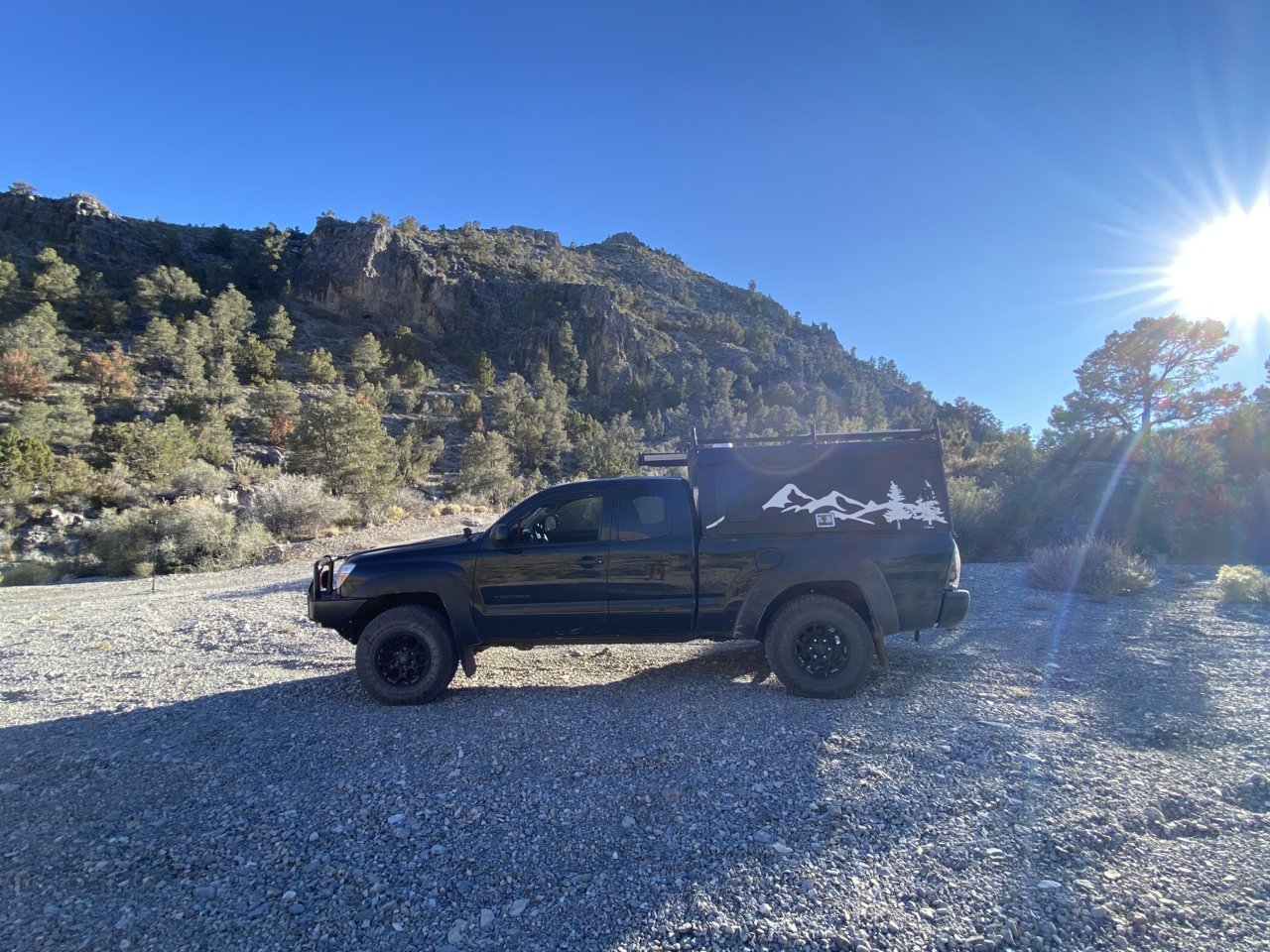

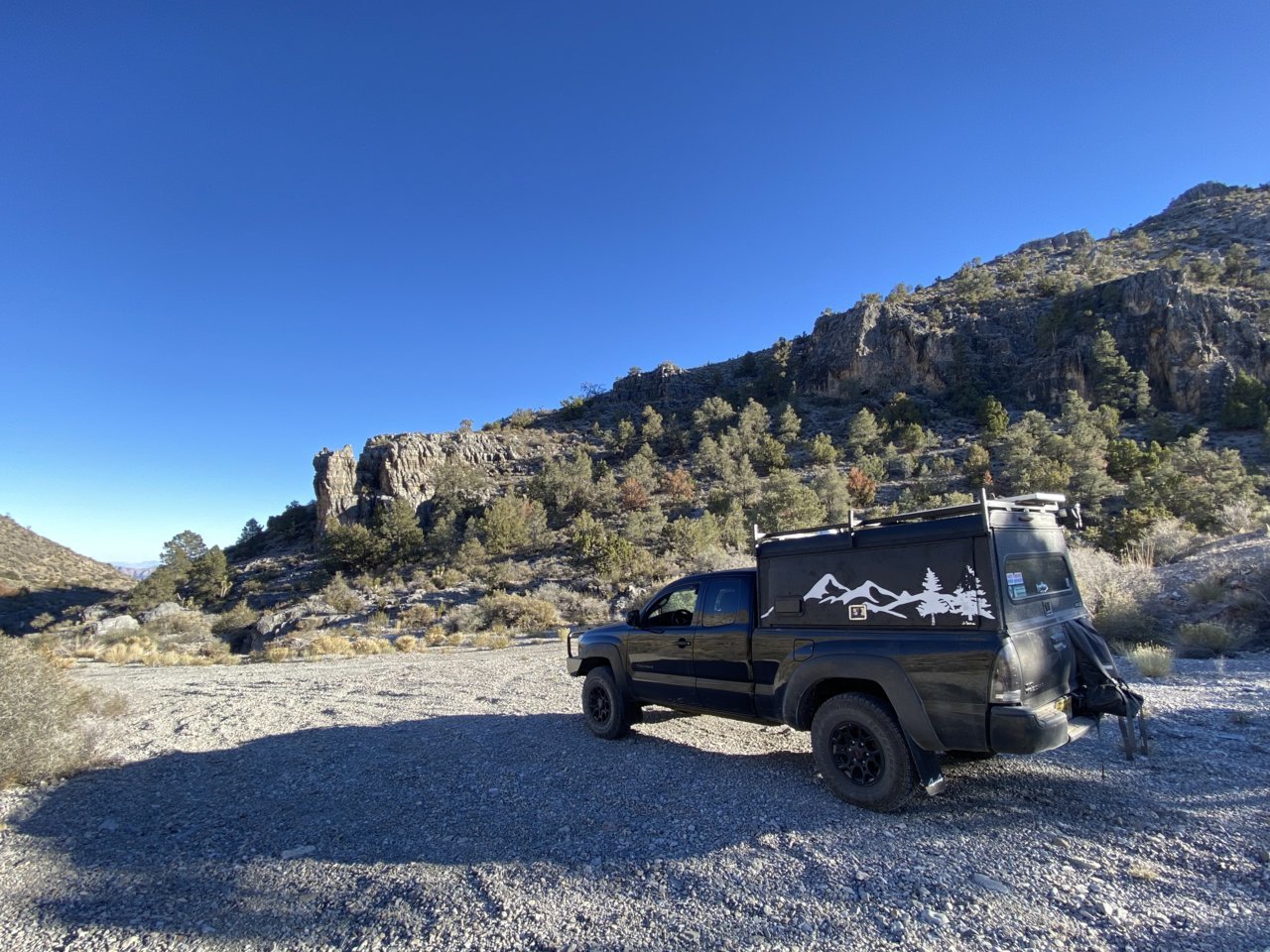

    That being said, I’m living in Vegas now indefinitely. We did the 2600 mile ride from NJ to here in 3 days. All driving done by me since my girlfriend can’t drive stick and I’m not too keen on teaching her on my baby :rolleyes:
    Gave the camper a good shakedown test on a 45 mile dirt road with some technical spots. Definitely got the truck shaking and rolling in some spots, as it was my first real offroad experience. Read a member here once saying their ARE DCU welds cracked after minor offroading, I already had a few cracked welds to begin with and everything else is covered so who knows. I do know that the paneling + insulation board I added must add some rigidity to it. Might have to tear her down one day and rivet some 90 degree brackets in some spots. Not too concerned as there’s lots holding this thing together, and she did 80mph on the highway just fine on the way home. What a relief because I really did a number on the whole truck today lol. Tacoma handled it all like a champ..
