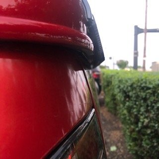

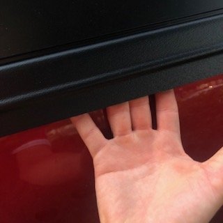

    I recently purchased an A.R.E. CX series truck cap for my 2013 Tacoma d.c. w/ 5ft bed. Overall, I'm pretty satisfied with it, however one concern of mine is the fit at the rear. There is a small gap between the cap's rear glass door and the tailgate (see pictures). Most caps I see on the road the rear door of the cap is flush with the tailgate. I would prefer this as it would create a seal from the outside elements as well as potential intruders.
    Does anyone has a similar set-up, and want to share their experience? Is yours flush with the tailgate or is there a gap?
    Thanks in advance!

    Maybe your cap needs to be moved forward a bit? Is the glass closing properly against the canopy/frame/seal?

    Hey, I thought about that, but the fit looks good at the front, so I don’t know if I want to do that. Might be an option though thanks.

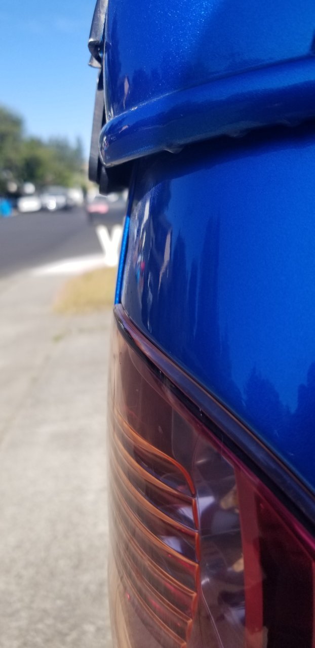

    Mine looks pretty similar to yours, but I have a kb voodoo tailgate cap, so it closes up the gap. I got the cap before I put the shell on, so I don't know how mine would look stock. The ARE on my 06 won't let you push it into the truck, the ends use the bedsides as stops. Try unclamping the shell and give it a good push to make sure its sitting as far forward as possible as hr206 mentioned. Unless you're the hulk, you won't send it into the back of your cab. I'll snap a picture of what mine looks like tomorrow.

    Here's mine for reference, enjoy the maco paint job :D20210609_173403.jpg

    Thanks everyone. I took it back to the dealer and they pushed it forward a bit. They also installed a thicker gasket where the gap was that practically sealed it off. Issue resolved!
