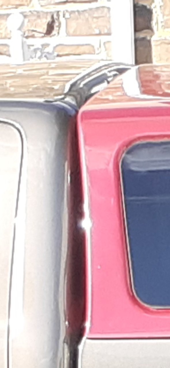

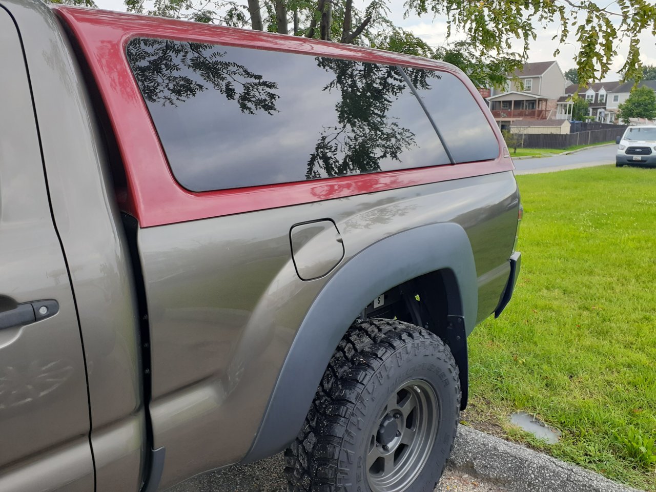

    I had this Leer cap on mine I'm almost certain it wasn't for a RC, it sat to close to the cab for my comfort and got rid of it.
