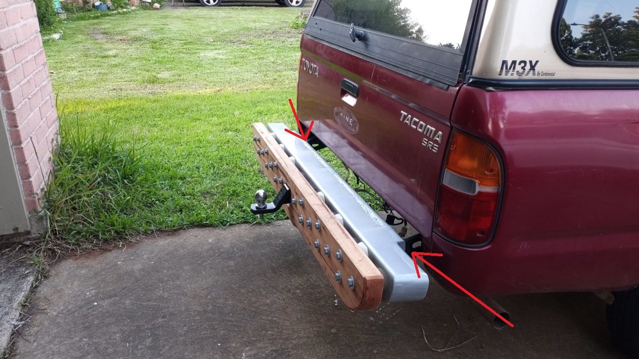

    Infinitely more than most bumpers, which are designed to crumple, not "spring" back. For any but minor impacts, these balls will compress to destruction, dissipating energy that would otherwise bear on the brackets; there is ample room for the bolts to recess back as the balls are sacrificed.

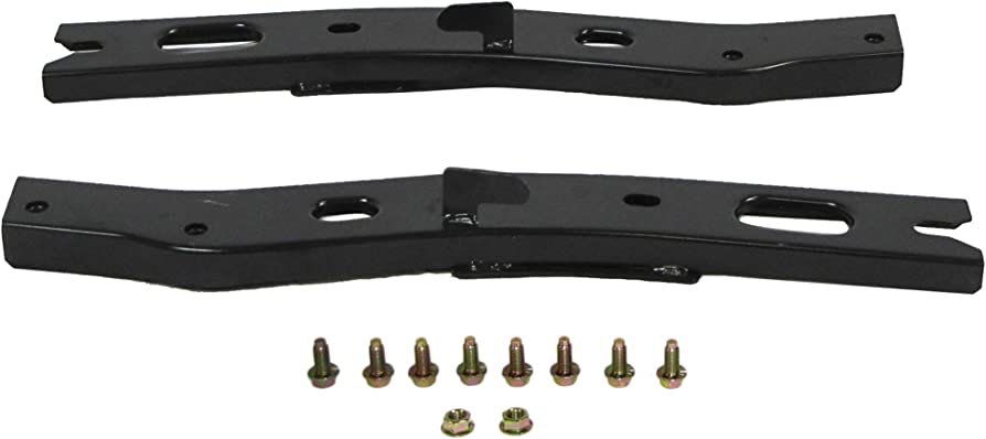

    What 'OEM' brackets are you referring to? You mean these?
    At most, those will support whatever the ball that attaches to the bumper is rated for. And that's when using the factory bumper.
    Your bumper is far from factory, and with it weighing as much as it does, you've already given up much of that capacity.
    We didn't even cover it from an engineering standpoint, how do you counteract the deflection when pulling something or when you have to hit your brakes?
    I bet you can hit the top of the bumper with a sledge hammer and it'll start angling downward; imagine the force of a trailer under it's own weight? This thing would crumple with it only being attached where I'm pointing -

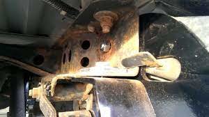

    Here's some constructive reflection you need to take. That bumper has no business having a receiver in it. End of argument. You literally keep going back to brackets not rated for towing. Example:
    YOU'RE LITERALLY EXCEEDING THE DESIGN LIMITS OF THE BRACKETS AS THEY AREN'T MADE TO TOW! Toyota load tested those brackets to hold your body weight as you climb into the bed, not haul a trailer down the road.
    THIS is not going to keep your trailer attached to your truck.
    Let's take a gander at an ACTUAL INSTALLED RECEIVER and see how it's attached!
    That's odd, doesn't look like its attached to stamped steel brackets but actually attached to the frame. That's so weird. It's almost like Toyota knew that the frame is stronger than the bumper brackets and decided it'd be much safer to attach it there and then test its load ratings with a proper setup.
    TS4x4, 0xDEADBEEF and CygnusX191 like this.

    As previously stated, there is no intention to exceed the rated capacity of the brackets. I weighed both bumpers, and am armed with the power of subtraction. Your protests are baldly defensive, featuring predictions of imagination.

    Toyota rates these brackets for towing 3500 lbs, and 350 lb tongue weight, and came attached to the the tow bumper of this '98 SR5. I don't doubt the robustness of your tow system- but this isn't a contest: yours having a higher capacity doesn't mean these have none. Again (and again.. and again...), they are purpose-built by Toyota. It's not a class-3 hitch- nor is the rest of the vehicle built to pull class-3 loads.
