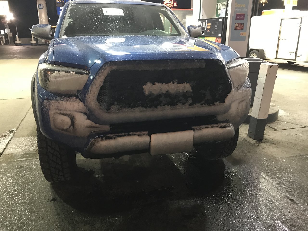

    350 mile trip In heavy snow yesterday. When I got to a rest area, my headlights, along with everything else, were iced over with dirty interstate snow. I had little holes in the ice on my headlights where the heat from the bulb had kept them reasonably clear from the ice. LEDS would not have produced enough heat to keep the ice from covering them. A pic of the truck at the hotel last night:20180130_175752.jpg

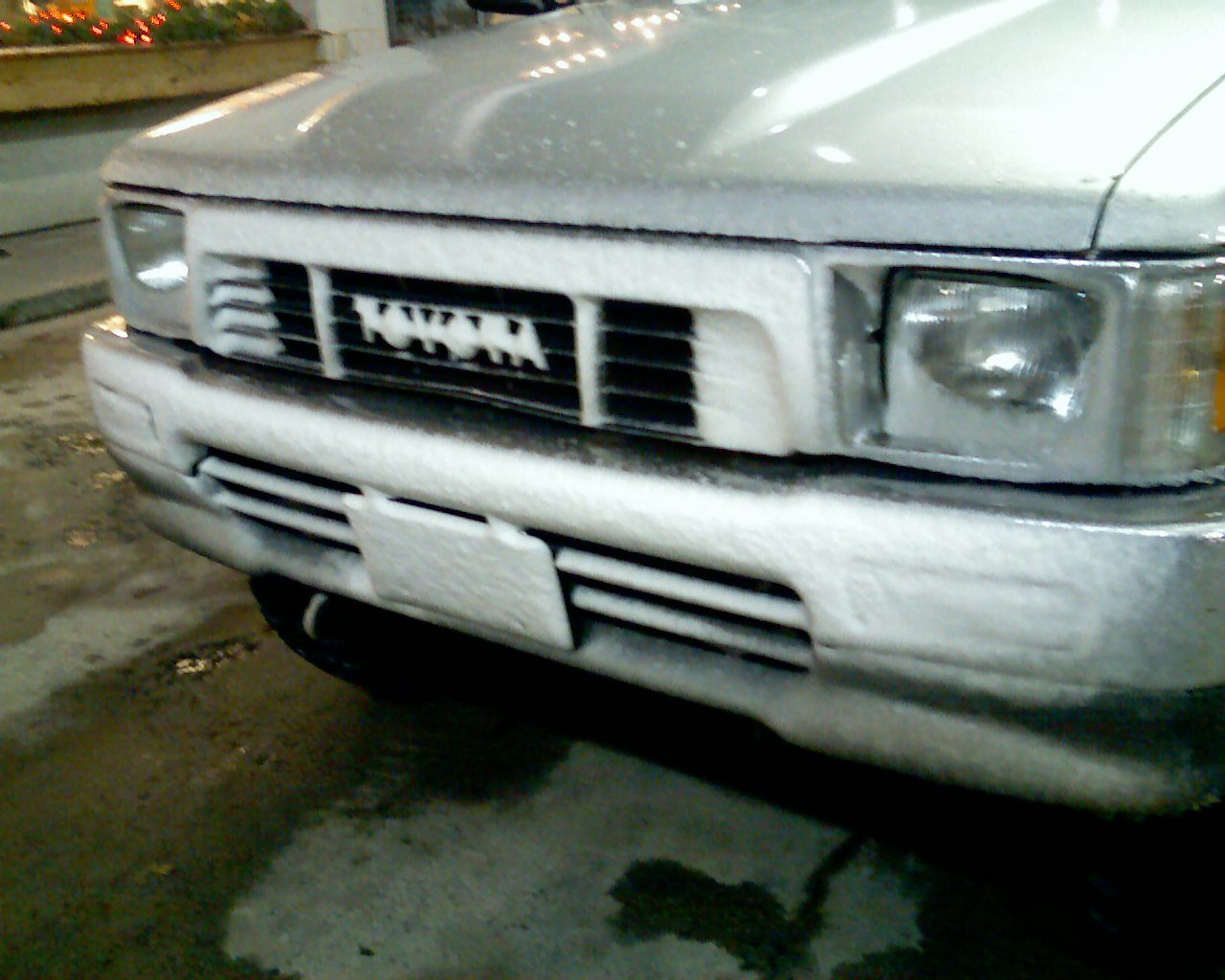

    LED icing is a real issue in cold weather climate areas. If you look at legitimate LED headlamp conversions used in the trucking industry (there are no legit conversions for a Tacoma), they have built in auto detecting defrost heaters in the lens to prevent this from happening.
    Here is a picture of my old Toyota pickup after driving through a snow storm over the pass. These are hot 85w headlights. LEDs would have easily frozen over.

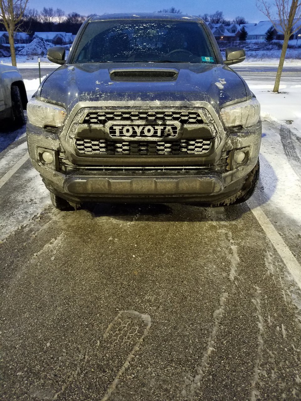

    My truck is a good example of this. Recently did a 3500 mile trip and had my headlights snow over. It took a few hundred miles for them to get to this point, and to be honest I didn’t realize it was happening because the transition was so slow. Drive safe!

    I appreciate all the warnings, it's great to a see a community that wants to try and keep one another safe. But I am still going to run LEDs, because them not melting snow just proves how cool they really are.:wink:
    Maybe I'll find myself in a position of immense regret at some point but this issue to me seems more like a small problem resultant of LED headlights rather than a major concern. I mean unless I find myself in very extreme snowy weather conditions, this is a be aware and clean off your headlights/do something to try and prevent it from happening sort of problem. If my LEDs rapidly and unexpectedly turned off while driving in the rain, now that would be a major concern, to give an idea of how I rank my concerns. However, if I lived in a very snow-ridden place and frequently drove at night my opinion would probably be different.
