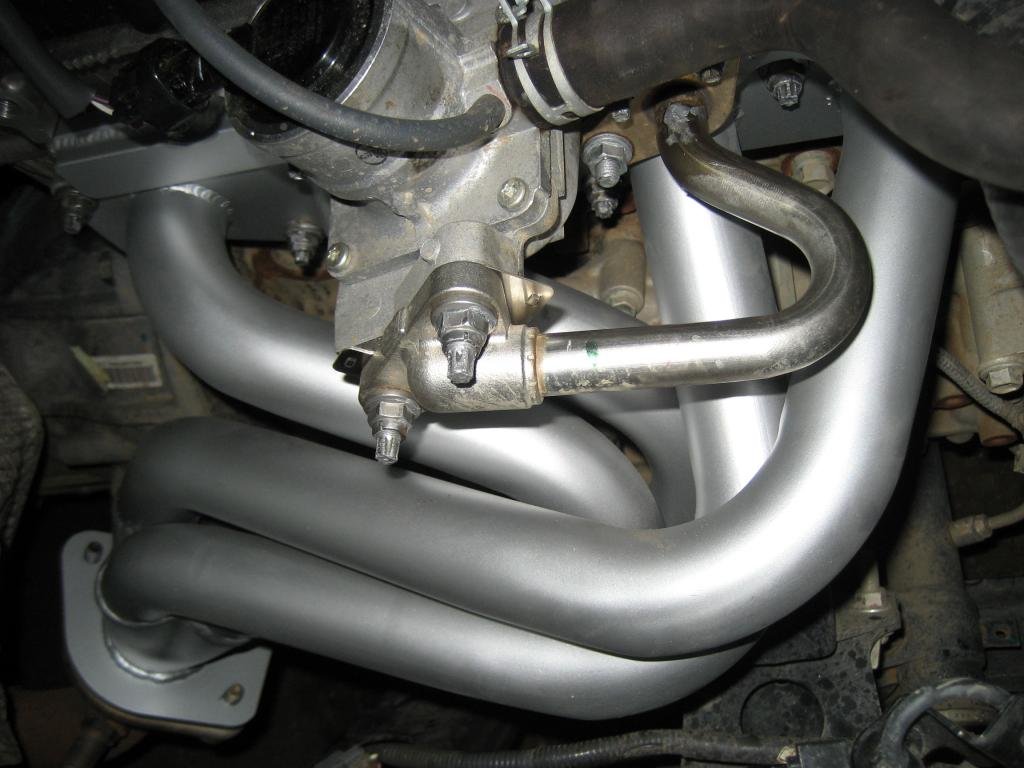

    Built for maximum low end torque, tooter II.VII intake manifold spacer, LCE long tube header, Injen long tube intake, 2,900 rpm torque peak.
    I also have a 2.7, and the best mod I've found for more low end torque is a LCE long tube header ($450 plus shipping). Combined with the stock exhaust it will help you get up the hills better and will also help your off road drivability.
    63eecebd-d227-4758-af55-202fc9a4543c_zps_c76abb5afe56ac871da739345075a31da92c58db.jpg
    The other things you referred to would only waste your money.

    The link only shows an empty shopping cart, so I'm not sure to what you're referring.
    Even if you got a header now and did happen to get a supercharger later, the header would just make your engine run even better because it can easily handle the increased exhaust flow of a high performance engine.
    Because my truck is used every day for work, I like to keep the engine normally aspirated for the sake of simplicity, longevity, and reliability. So instead I use a variety of simple bolt on intake and exhaust mods solely to enhance the low end torque with no regard for top end horsepower.
    To date I'm running these mods (and how much each lowered the torque peak)
    LCE long tube header (-650 rpms)
    Tooter intake manifold spacer (-250 rpms)
    Flowmaster 50 Series Delta Flow muffler (-100 rpms)
    Bone stock 2.7:
    133 ftlbs @ 3,800 rpms
    My 2.7 :
    162 ftlbs @ 2,800 rpms
    This particular combination of mods increased the absolute torque value by 29 ftlbs... while lowering the torque peak by 1,000 rpms.
    The mods make the engine feel much larger than it really is,
    because it pulls so strong at low rpms. :)
