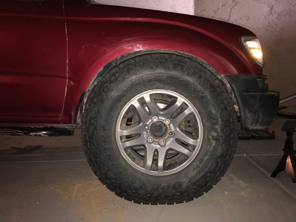

    This is on my passenger side. I ran out of light to continue. Just a rough cut with a cut off wheel. I have removed a bit of where everything comes together but it hasn't intruded in the cab yet. I just bought a flapper wheel for my grinder so that I can clean it up a bit. I am going to flex it this weekend and see if is just enough to clear. I don't rub anything in the front of the wheel. Driver's side seems to be into the metal more and I might have to cut into the cab there. Hopefully I can get away with not having to and finish it up this weekend. I know your tires are about .4 to .6 inches bigger.
    It is dark out now and this was just with flash on my phone.

    Sweet! That helps quite a bit!
    Is that picture at stuff or just wheels turned?
  9. Dec 15, 2016 at 8:49 PM
    #49
    stumbles
    stumbles 1 eye
    Aug 18, 2014
    #136442
    4,391
    bryan
    mesa
    2002 White Double Cab
    Just wheels turned in my driveway.

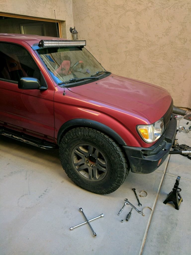

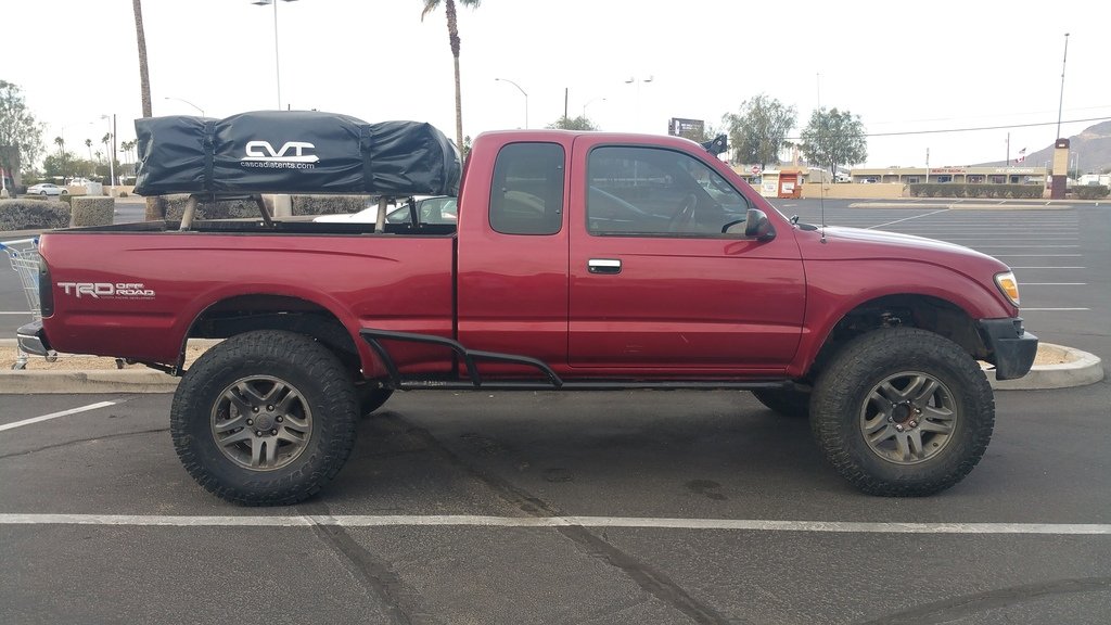

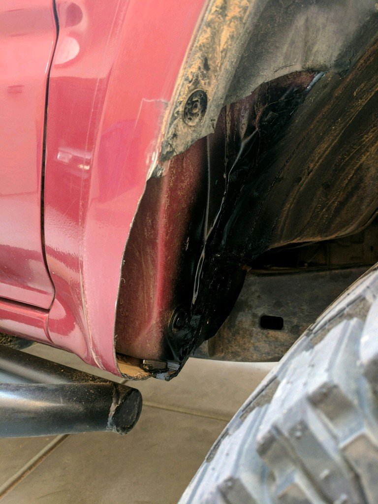

    Bump before any work:
    Bump after cutting and tubbing:
    You can see the electrical tape I used to cut along the fender.
    Some closer shots after:
    Everywhere it was painted I had hammered back:
    And an updated shot. I am trying it out to see how I like it without the flares. Still undecided.

    Oh,
    And @justlookin. Cutting went easy. Little nerve racking as it was the first time I cut into my body, but after the first cut it was simple. @4Running Daily was there to help me and showed me how far back I should cut and tub. I also painted my sliders where they were showing metal.
