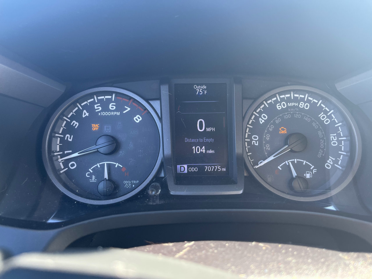

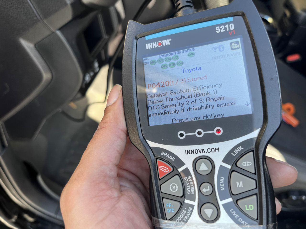

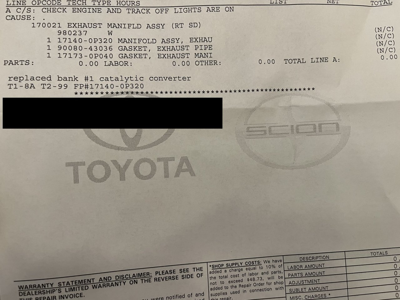

    Well, this might be it boys and girls. Was doing errands yesterday and CEL and trac off came on. Was hoping it was just the gas cap, ran the code, code was for cat failing. Took it to toyota, and low and behold the cat was done for and needed replacement. Thank heavens this was covered under 8/80 Emissions warranty.
    Just crossed 70,000 miles and have had power steering pump fail, timing cover fail, and now catalytic converter fail.
    I've always had VWs until my '10 Tacoma, and then traded for this '16 and this has been the most disappointing car purchase I've made. I maintain it and do everything right by it, but it hasn't been to the standard of Toyota. It makes me afraid to even explore other Tacomas if I'm being honest, it's soured my confidence. I moved to Tacoma to get away from expensive fixes from my VWs once they reached higher mileage (150k+), and low and behold I've spent more money and time on this Tacoma than anything else.

    Has your truck been burning oil? Because normally a Cat wouldn't just fail on its own it would get clogged up over time and that usually wouldn't happen unless you're burning a lot of oil.
    Also do you live in a state where they do emissions inspections? Because if not you could always just take it off and leave it off and do a straight pipe but if you are in a state where they do inspections then yeah you're going to replace it.

    In reality it may just 02 sensors. If it's seldom driven on the highway and the cats don't get up to temp regularly I can see them failing though. Seen it many times on BMW's.

    Is this 8/80,000 mile emissions warranty STANDARD or is it an add on you purchased????? I have a '16 with just over 65,000 miles and my passenger front/main cat converter is needing replaced......about $450-500 for the part only - if you can find it!!
    BUT, if that warranty is standard, I will be calling my local Toyota dealer early next week!!!

    It's standard :)

    It hasn't been burning oil but it did have the timing cover issue. I actually just got my throttle body cleaned and serviced and new spark plugs in July. It wasn't the o2 sensors. Yep we do emissions.

    Yes it's tied to the vehicle not the owner. It's the Federal Emissions Warranty
    So you're another early cat-failure then? Darn. Well I was in and out in under 2 hours so fingers crossed for you too
