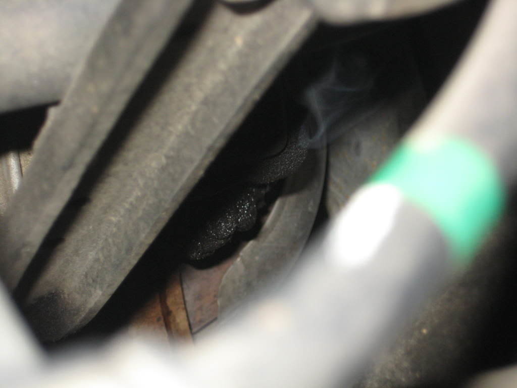

    At about 155k, a small oil leak developed under one of the valve covers, causing oil to drip onto the exhaust manifold and burn from the heat:
    The problem became more and more evident. I would drive the truck into the garage, close the garage door and come inside. After 5 minutes, I would walk back into the garage and it would be pretty smoky from the burnt oil. This happened just as I was getting ready to leave the country for 10 months.

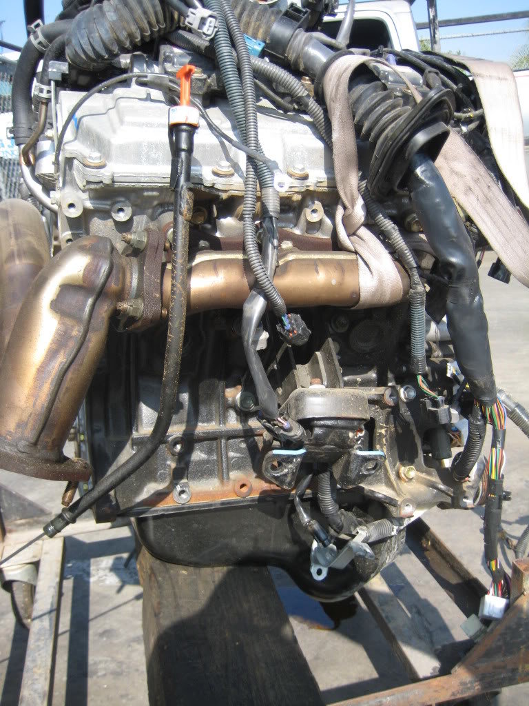

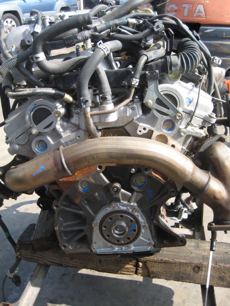

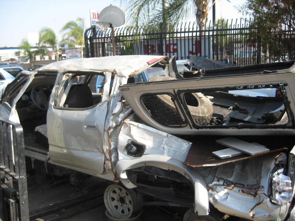

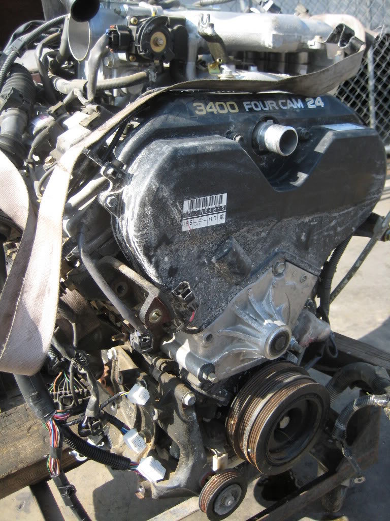

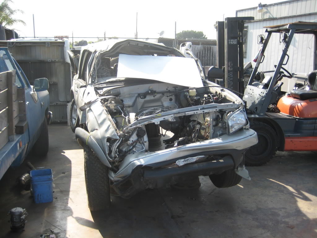

    My dad and I drove over there and right away and this is what I saw (the engine is missing because this picture was taken after I told them I wanted it):
    Notice the engine compartment is hardly touched. The electrical system was still good so the guy turned the key to power the cluster 5622 miles on the odometer. My dad and I inspected the engine as best as we could and everything checked out. He wanted $950 dollars - a bargain. We charged it on a credit card (a little insurance policy) and asked them to remove the engine so I could come back and take a better look at it:
    Everything looked great! A friend recommended a mechanic in Riverside. He gave me his number and I called. The mechanic wanted $450 to remove and replace but I asked for a better price :D He did it for $400. I made the arrangements and had my truck towed (free - thanks AAA) to the mechanics shop.
    After all was said and done, I blew my engine, found a used one with less than 6,000 miles on it, swapped the engines, installed a new clutch plus other misc parts for $1,800 total. A rebuild would have cost closer to $3,000.
