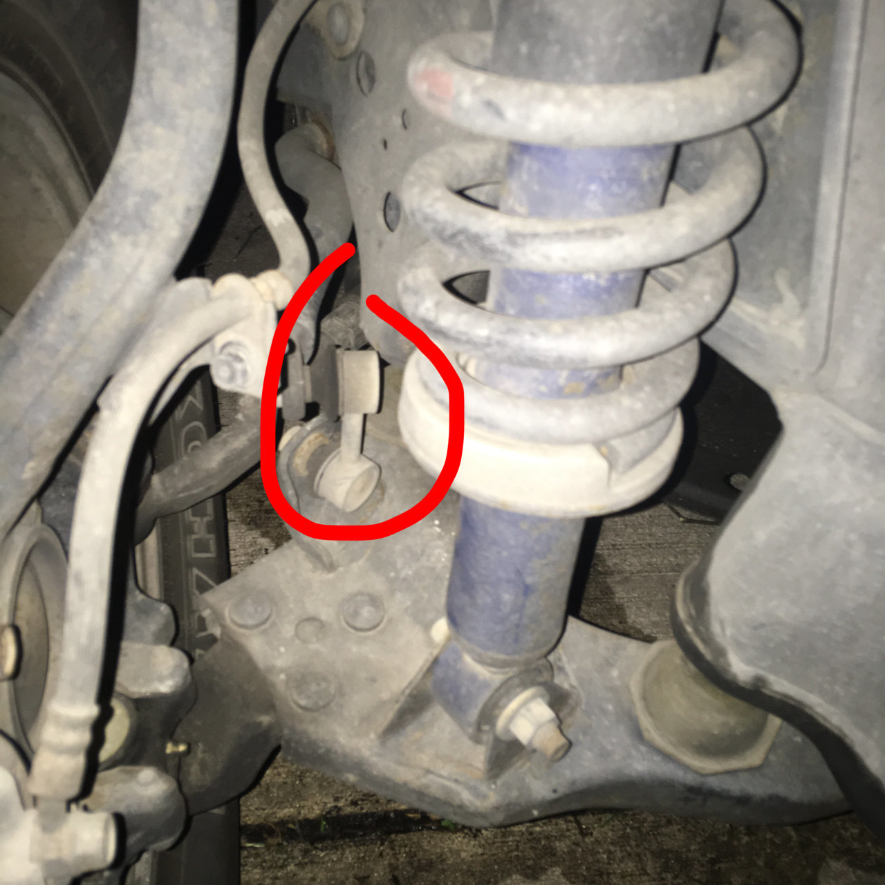

    I am going to upgrade my front suspension in the coming weeks.
    Currently, my set-up looks like this
    I am currently thinking about getting new:
    - Spring Coils
    - Upper Control Arms

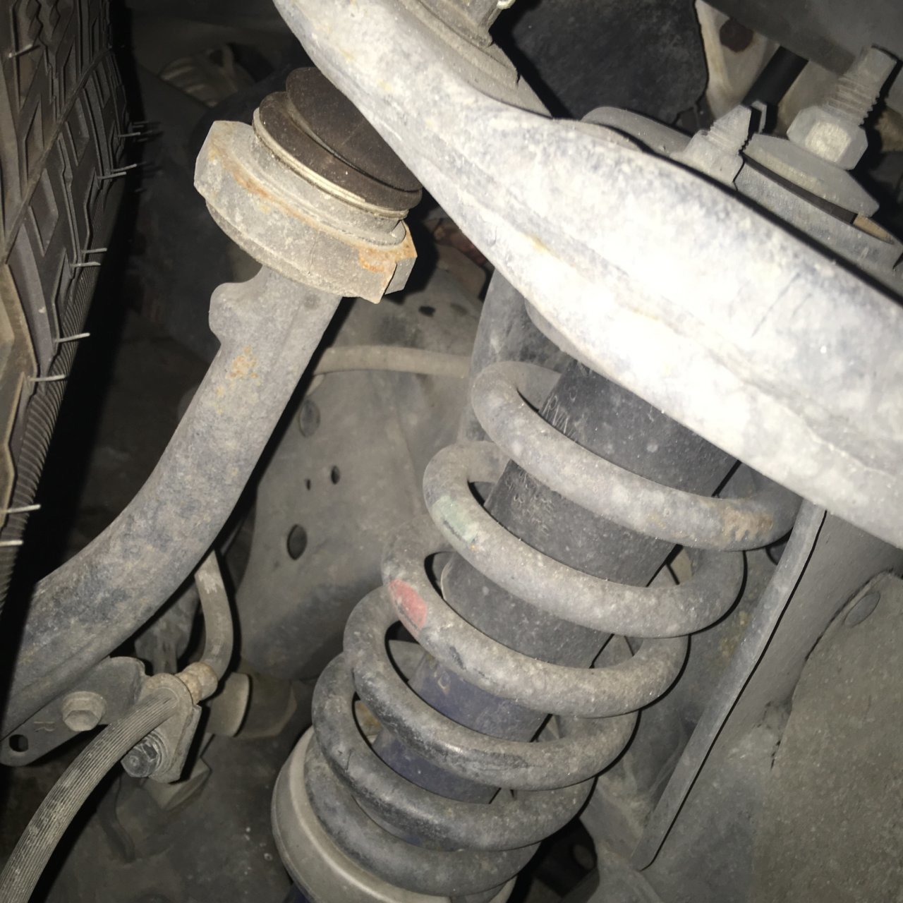

    - Suspension bushings (I don't know what specific part #'s or what they're even called (I highlighted them in red on the second picture) )
    - Shock absorbers (Bilstein 5100)
    My questions are:
    - From looking at my pictures, what else do you recommend I replace?
    - What brands do you recommend that offer great quality, but not over the top in price?
    - Do I need a specific spring coil pack to go with the bilstein 5100's .. OR could I use these ( ) Eibach 14 coild spring pair for 2.5 ?
    - When replacing the upper control arms, do I need to purchase additional bushings for them?

    The thing you circled is the sway bar end link. In my opinion, Napa makes the best replacements under their Napa Chasis brand for like $30 each. They come with grease zerks and have flats for an 18mm wrench (youll understand why you need these after you get your old ones off).

    Also, make sure you have either a 5 or 6mm allen socket to remove the old ones. Clean out the holes with a pick first to ensure the tool seats all the way in. Removing those guys can sometime be the most annoying part of a front suspension job. And start hosing everything down with PB blaster a few days in advance.

    I didn't even waste my time stripping the Allen head(mine were 6mm) out and trying to remove the previous link ends. Got the angle grinder out and cut them right off after 10 seconds.

    Thanks for letting me know about the lower control arm bushings! I'm not sure whether or not to even replace the one I have, but it is stock, so maybe I will. I'm a bit more concerned with the upper control arm because I believe it gets more "action."
    I recently changed all ball joints (lower, upper, and tie rod)
    So far, the things I need to add according to your comments and above:
    - Control Arm bushings (lower and upper)
    - Sway bar end links (includes the stabilizer links)
    - Sway bar bushings
