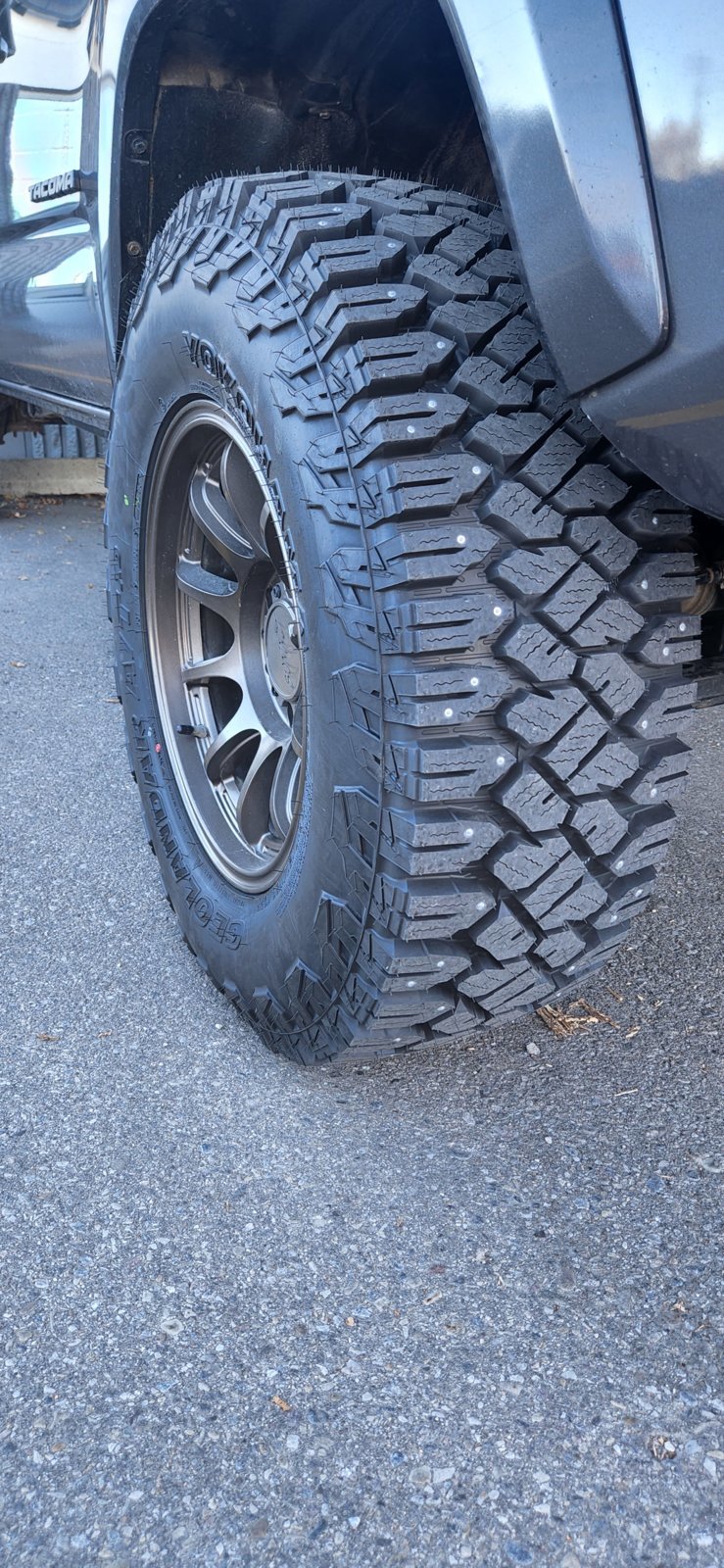

    It's -35 in the prairies right now, ideally get a set of winters. I live in this winter wasteland.
    I ran a 4 season all terrain (cooper at3 4s) for one year then immediately put on winters again.
    If you can only do one set look for the most amount of sipping (the thin squiggly lines), tires like the Cooper AT3 4S.
    Toyo AT3 and Falkens are good in snow but lack the sipping to help on ice and packed snow.
    [​IMG][​IMG]
    In contrast here's a mid grade winter tire.

    To be fair the siping shown on the Toyo in that pic is for the LT model. P- and euro-metric have significantly softer rubber and a lot more sipes. So choosing non-LT Toyo probably would achieve about equal winter performance to some other better winter performance all terrains.

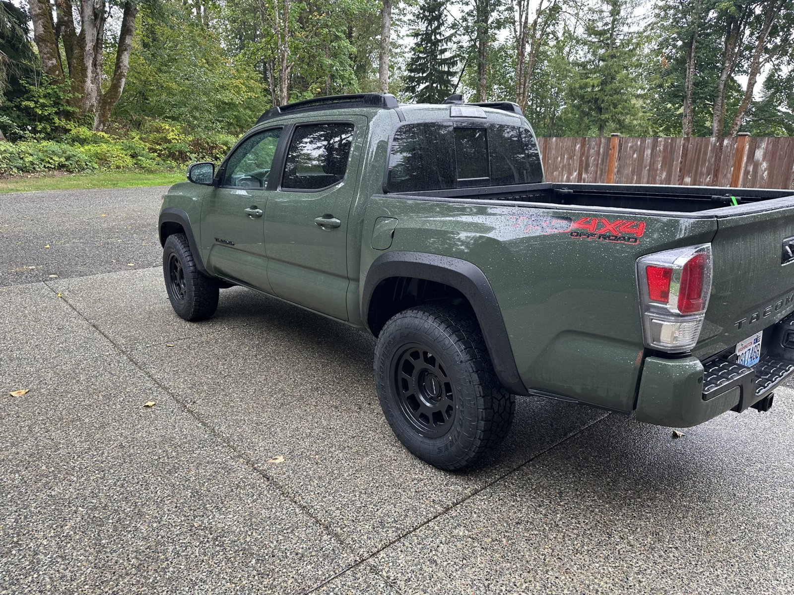

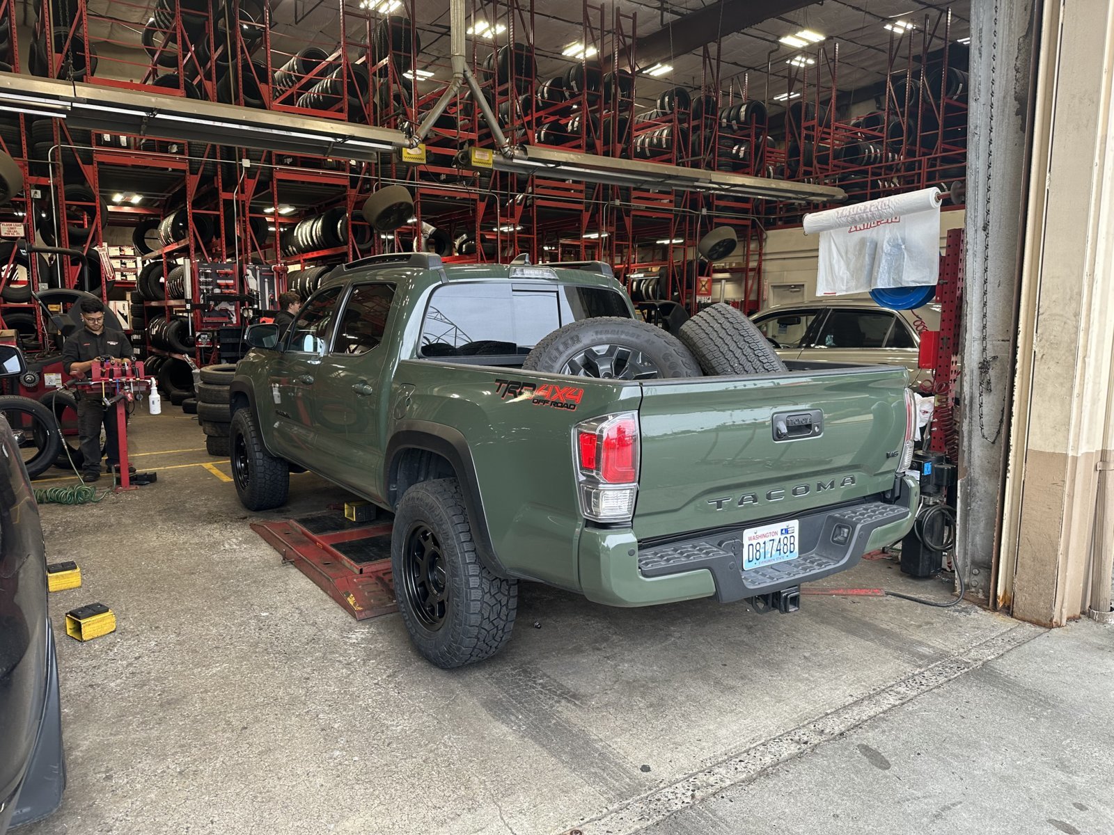

    I have the Toyo AT3 and they’re pretty darn good on wet,snow,ice, packed snow. Have the SL version and keep them at 30 pounds ea. very surefooted. Another thing I got wider wheels (8.5”) therefore wider tires allowed. That wider footprint really helps the center of gravity. Now to go deeper down the rabbit hole I got 0 offset so they stick out a little. Making an even wider stance. This little bit helps the side to side control of the vehicle. Wider, softer AT tires with not so much air pressure in a key on frozen roads. upload_2024-1-17_21-24-26.jpgupload_2024-1-17_21-25-18.jpgToyota has an already advanced winter driving 4WD system (believe me i’ve owned multiple other brands) so the right setup will get you cranking down the road with confidence. If I wanted an excellent winter AT for Canada I’d look at the Michelin Defender ATX. They have a crap ton of siping and last forever. The only issue use I see with my Toyos is tread life. The Michelins are made to last and have lots of tried and true rigs that go through some tough winters year after year
