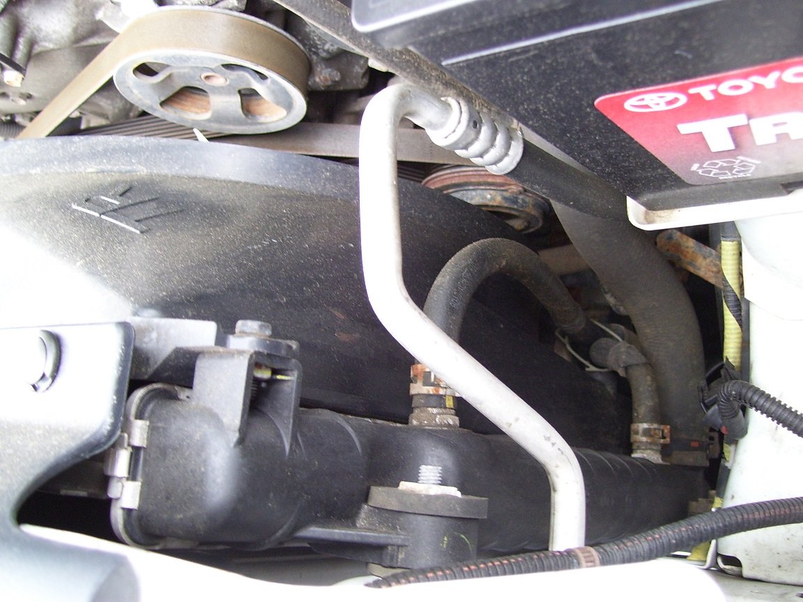

    OK - I'm a little confused? Your truck came from the factory without a cooler.....This pic, is this after you bought the parts from Toyota's parts dept, & did the installation?...One of my original questions was: are the lines from the transmission to either the radiator, or the factory cooler, the same with or with out the factory cooler? Thanks

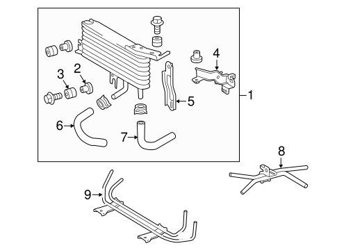

    No, that was a picture of a truck with the factory cooler, not my truck. The factory lines are rubber hoses that connect at the radiator. When you add the factory cooler, there is a short rubber hose that connects the cooler to the radiator and one of the factory lines gets rerouted to the cooler instead of into the radiator. Here's a diagram of the factory cooler and parts. There is a short hose that connects 8 to the radiator and I don't think you need 9.
    Here's a picture of my truck showing the 2 rubber lines going into the radiator. I think the top line gets rerouted to the trans cooler to part 8.

    You may still want to look into parts 4, 5 and 8 as a way of getting the lines through the radiator support without the risk of a rubber line rubbing somewhere.

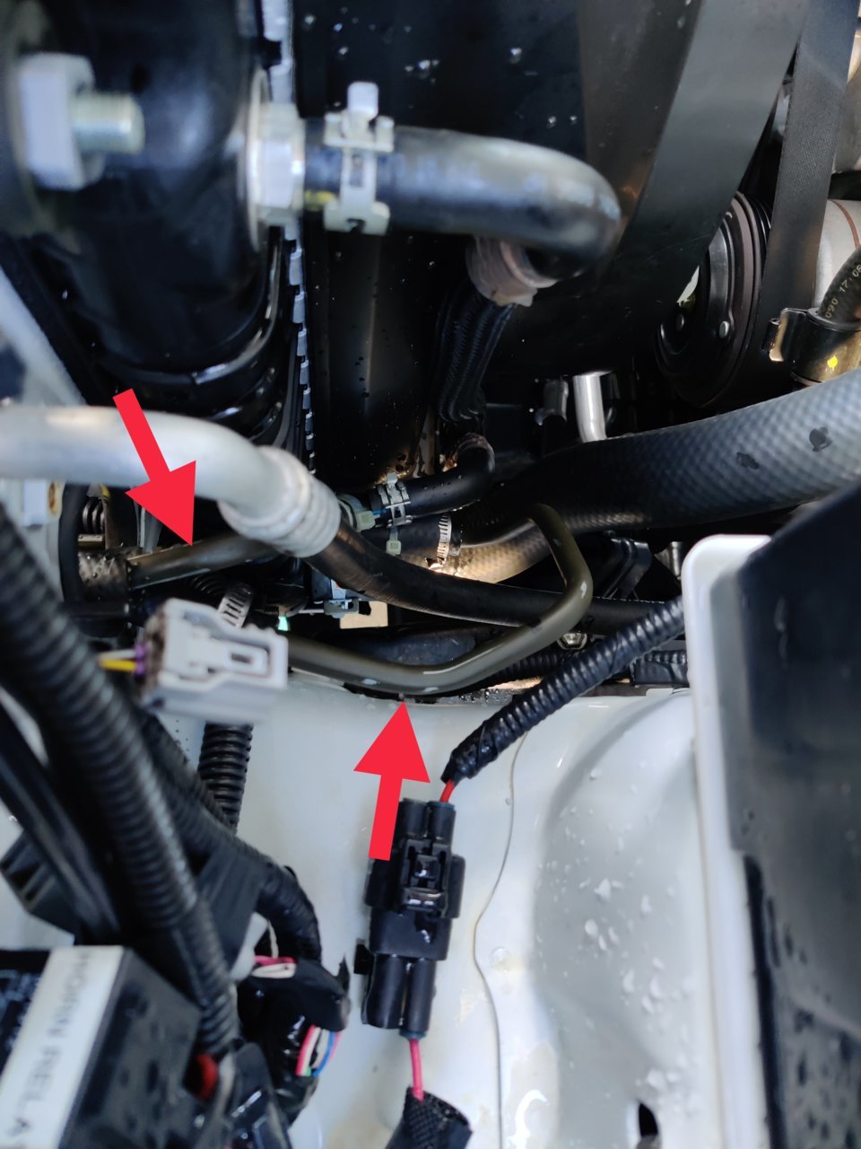

    Allow me to share my personal trans cooler solution.
    I'm using the Derale cooler. Fairly straightforward install but I used segments of metal tubing instead of all rubber hoses. I connected lines at the lower radiator cooler line. Just me going overboard...
    Not sure if you can see it in the pic but I made an oversize grommet with hose and placed it in the radiator support to reduce the chance of chafing the lines and causing a leak.

    So you have the bottom radiator line going to the external cooler and then where does the return line from the external cooler go?
