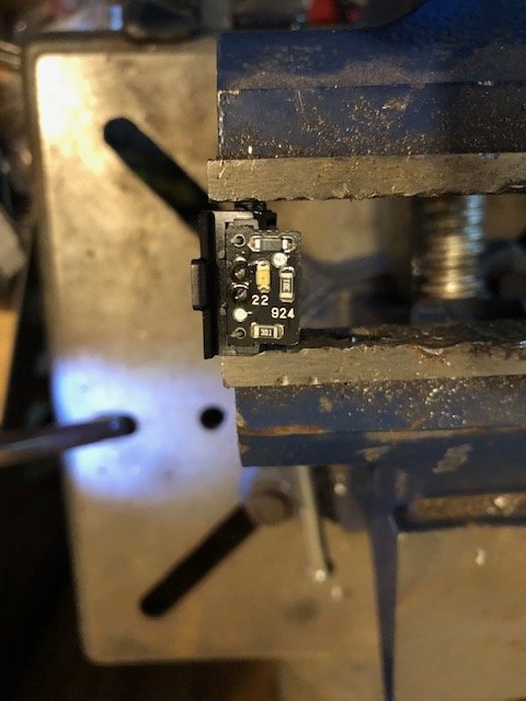

    It's hard to tell, but there is a tiny green indicator on the side of the LED closest to the "22" printed on the board. Orient the new LED the same way. Be patient with desoldering the old LED. This took me some time and patience but finally got it off. This is what the circuit board looks like:

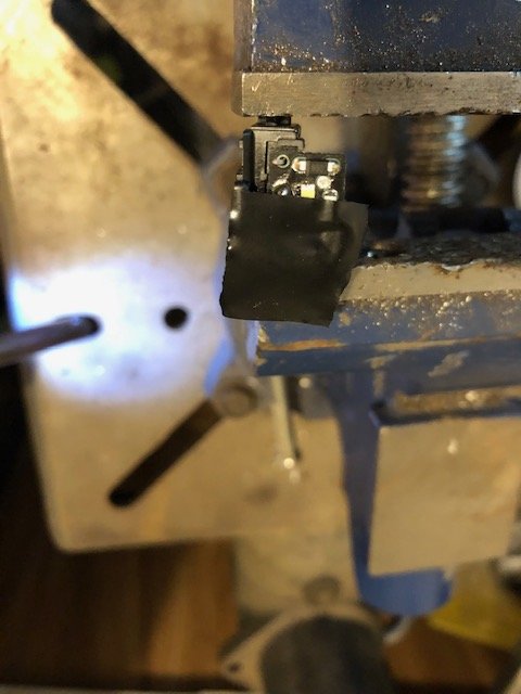

    To help solder the new LED on I used electrical tape on half the LED to help hold it in place like this:

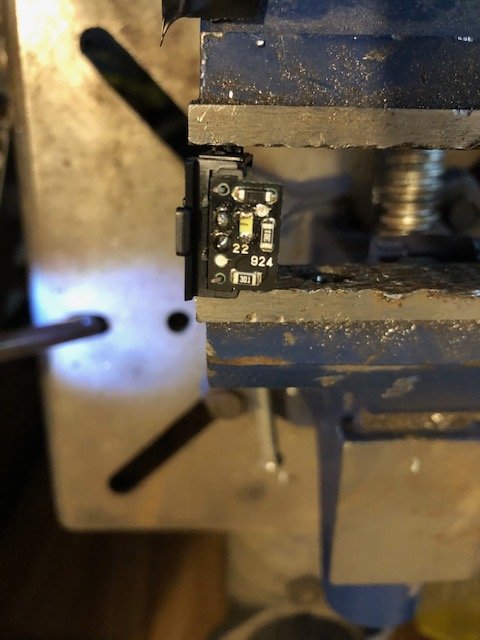

    Once you get one side soldered on, then take the tape off and get the other side. Be quick with your soldering since these are delicate boards and LEDs. I was paranoid about breaking something. This is the new LED on the board:

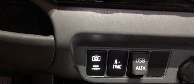

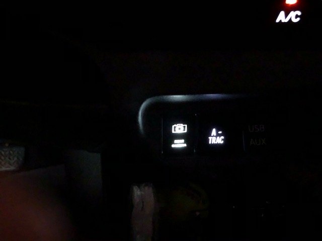

    And here it is lit up. I like it next to my anytime backup camera switch!
