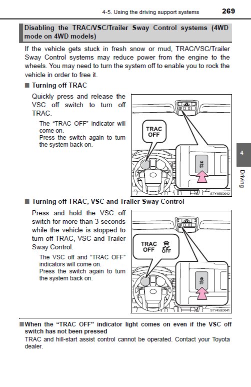

    I think we are actually getting pretty good at describing it. Unfortunately, it is difficult to use 'Proper Terminology' when Toyota did such a bad job of defining the terminology in the first place.
    From the owner's manual (this is 2017 owners manual shown), the SR/sport, etc have TRAC, VSC, and Trailer sway by default in 4LO. Quick press turns off TRAC, long press turns off TRAC, VSC, and trailer sway. Note, it says "4WD MODE" in the title
    NOTE, per my testing, the Off-Road DOES NOT HAVE TRAC in 4LO. 4LO in the Off-Road defaults to TRAC-OFF. This is why people are saying there are 'two systems'. Let me put it this way, there are two sets of default settings and settings choices. One set for SR/Sport, etc and One set for Off-Road/Pro. They are not always the same, for some modes they are the same.​
