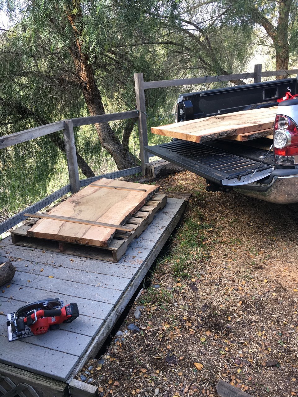

    Only picture I have of the ‘12 OR, lol. Oh I know what a I had, but John’s description made sense as to why it shuts off with the locker on. I just never liked it. I believe what YOU should do is get into a 3rd Gen non OR and feel the magic quite a few of us are experiencing with the alsd on all fours. I think you will be totally surprised like I was.
