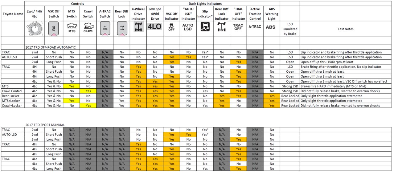

    I am trying very hard to only speak from actual repeatable test data from my 3rd gen OR automatic.

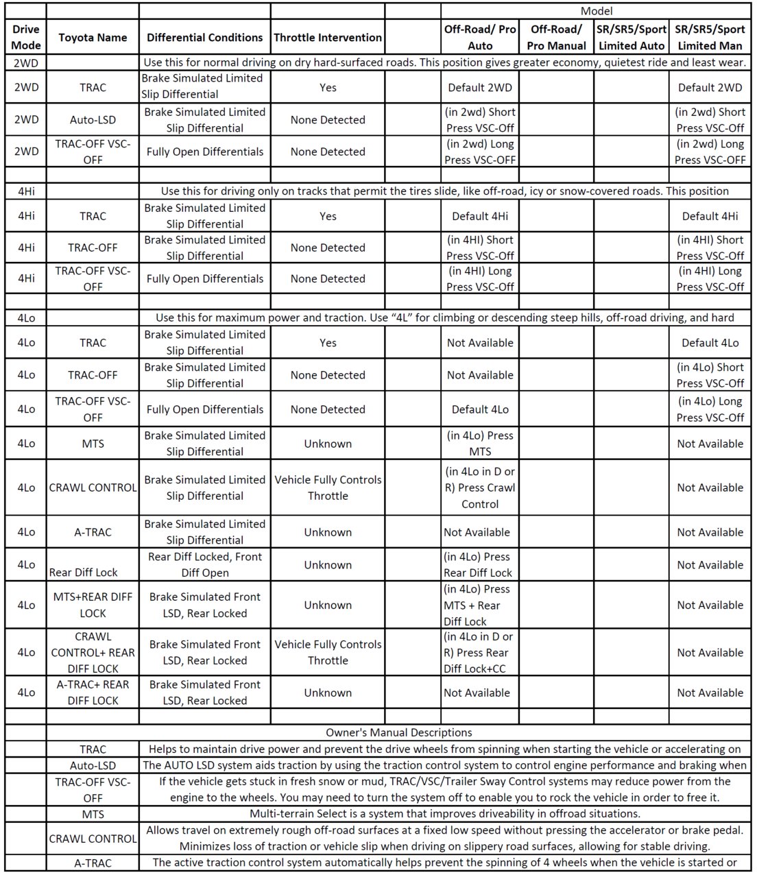

    So I haven't made a new thread YET. I want everybody to throw rocks at it. I know this data is directly contrary to what people with previous generations say but I am becoming pretty confident in it. Have at it, but please please please have some backup for any input you have based on a 3rd Generation test bed (such as all the great videos everybody has been making, or more garage testing like I did).

    @BigWhiteTRD awesome work with the above charts.
    But let me just double check what people are saying regarding 4hi TRAC-OFF, are people saying they do not get the slip indicator light in this mod? As I do in 4HI with a single quick push of the VSC off switch(TRAC-OFF light turn on), if I'm going in a straight line and spin nothing happens but the instant the truck starts sliding or bumping off ruts the VSC system activates. 2017 OR manual if it matters(don't think it does)

    I think the SR/SR5 guys would debate the 4HI TRAC OFF Differential Conditions cell. Edit: and @Cold_Toad for that matter who is in a TRD OR. The differential conditions need a different definition in that cell because it's no longer a brake simulated LSD. It's Stability Control that uses brakes.
    My additions to it would be as follows:
    ATRAC differential conditions should be re-worded to Brake Simulated Lockers. Giving ATRAC the same description as TRAC is unclear.
    You can change all the Throttle Intervention for ATRAC and Locker cells in 4Lo to None.
    The OR/Pro Manual cells would go like this
    2Hi
    Same as Auto
    4Hi
    Same as Auto
    4Lo
    Not Available
    Not Available
    Default 4Lo
    Not Available
    Not Available
    In 4Lo Press ATRAC Switch
    In 4Lo Press Rear Diff Lock
    Not Available
    Not Available
    In 4Lo Press ATRAC Swtich + Rear Diff Lock

    This is exactly what I would expect to happen in 4HI TRAC OFF according to the way Toyota has described their systems.

    The first video you made squashed it all. People just have to pay attention to the MANY things that are occurring. Tell tale signs all over the place.
