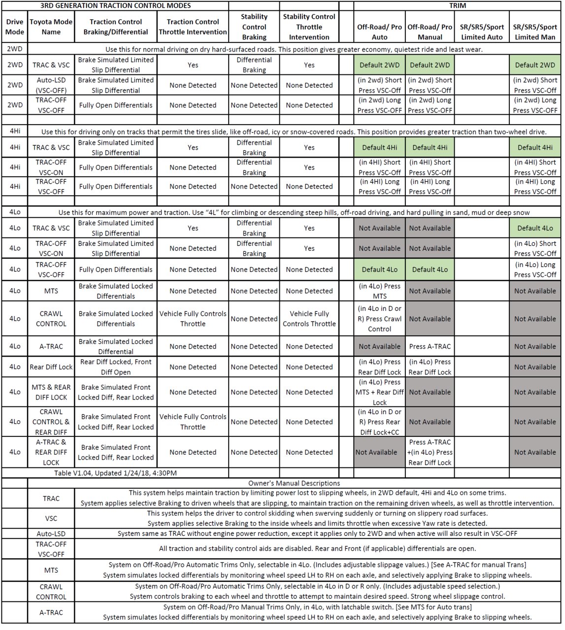

    I think understanding the VSC-OFF and TRAC-OFF lights were really where it was all at. I think you have it correct, and possibly more elegantly than I have now. I am not happy with the addition of columns for throttle and braking for stability control... but
    [Edit, latest data see https://www.tacomaworld.com/threads...non-trd-offroad.437814/page-22#post-16989593]

    "4Hi TRAC OFF and VSC ON. In this mode TRAC is off from 0-30mph and on over 30mph."
    TRAC is to get you moving when a wheel spins.. ie. from 0 mph. Why would it not be on until 30 mph, for what purpose? This is the point VSC comes on after being off from 0-30 mph in AUTO LSD MODE. I actually have not a clue as to why VSC is shut off at all in this mode (to 30 mph).
    TRAC or TRAC OFF has no purpose once you are moving or lose momentum as they only kick in if you are stopped or begin to stop moving from a loss of traction.

    Latest summary picture is in post 322. Want xls file? I will have to go get laptop out of car, be a few minutes.

    Latest XLS file (one tab is summary, other has all dash light observations)
