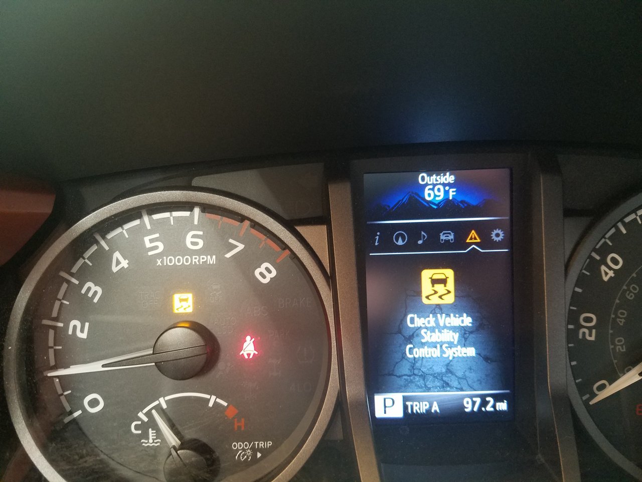

    Ok, I attempted a VSC braking and throttle intervention test. I definitely got braking firing on the test, but never got bad enough to get throttle control. So it definitely doesn't cut the throttle until trying braking or maybe gets really bad (As @tonered noted).
    However before I got thru the test matrix, truck got pissed at me. Fail safe for accelerometer and rate gyro fail I assume.
    Fixed by just taking it down, power cycle, and driving it around.
    Back to the drawing board. (Still hoping we get some diagonal tests or jack tests from some others soon, because I won't feel we have proven it all beyond a shadow of a doubt until then...)
