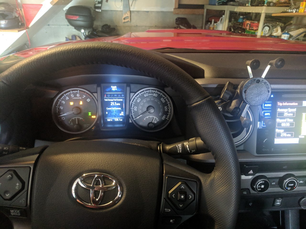

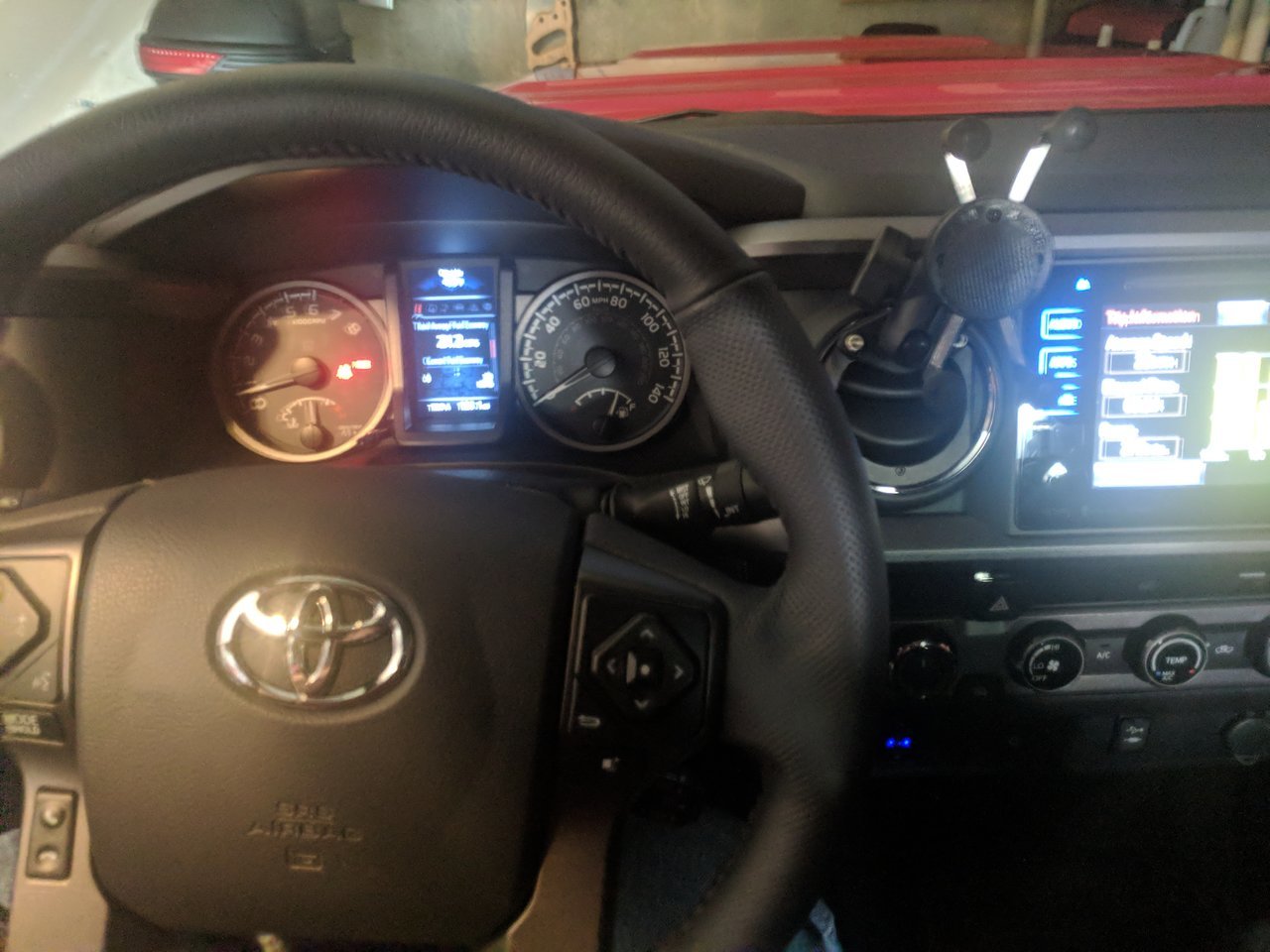

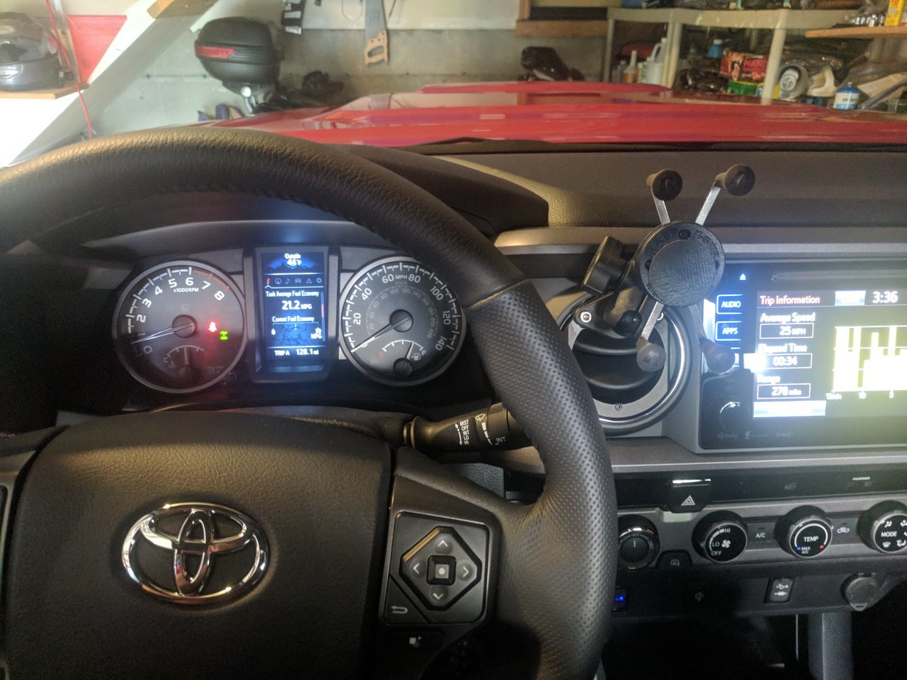

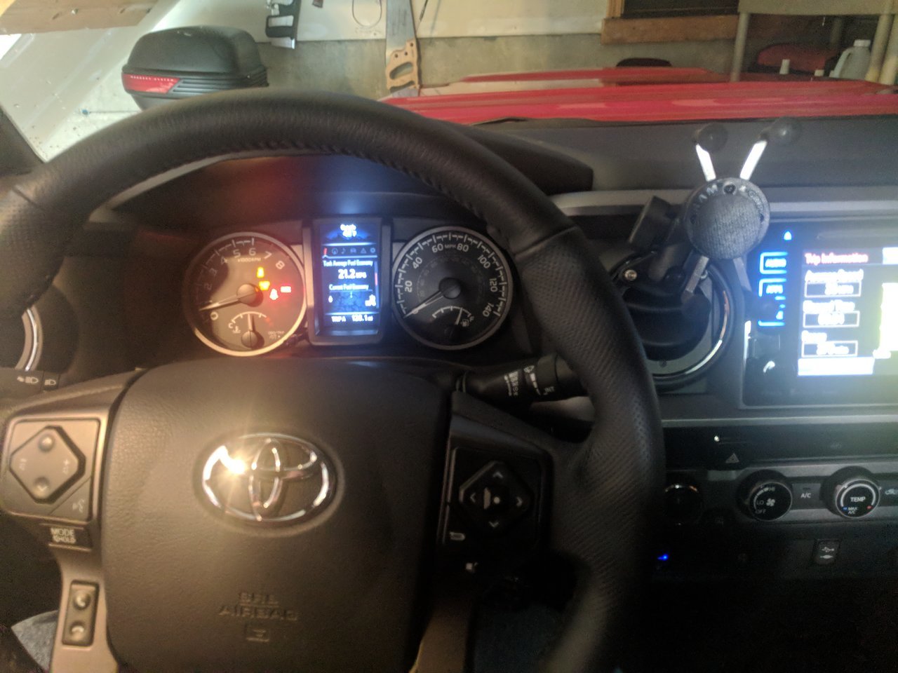

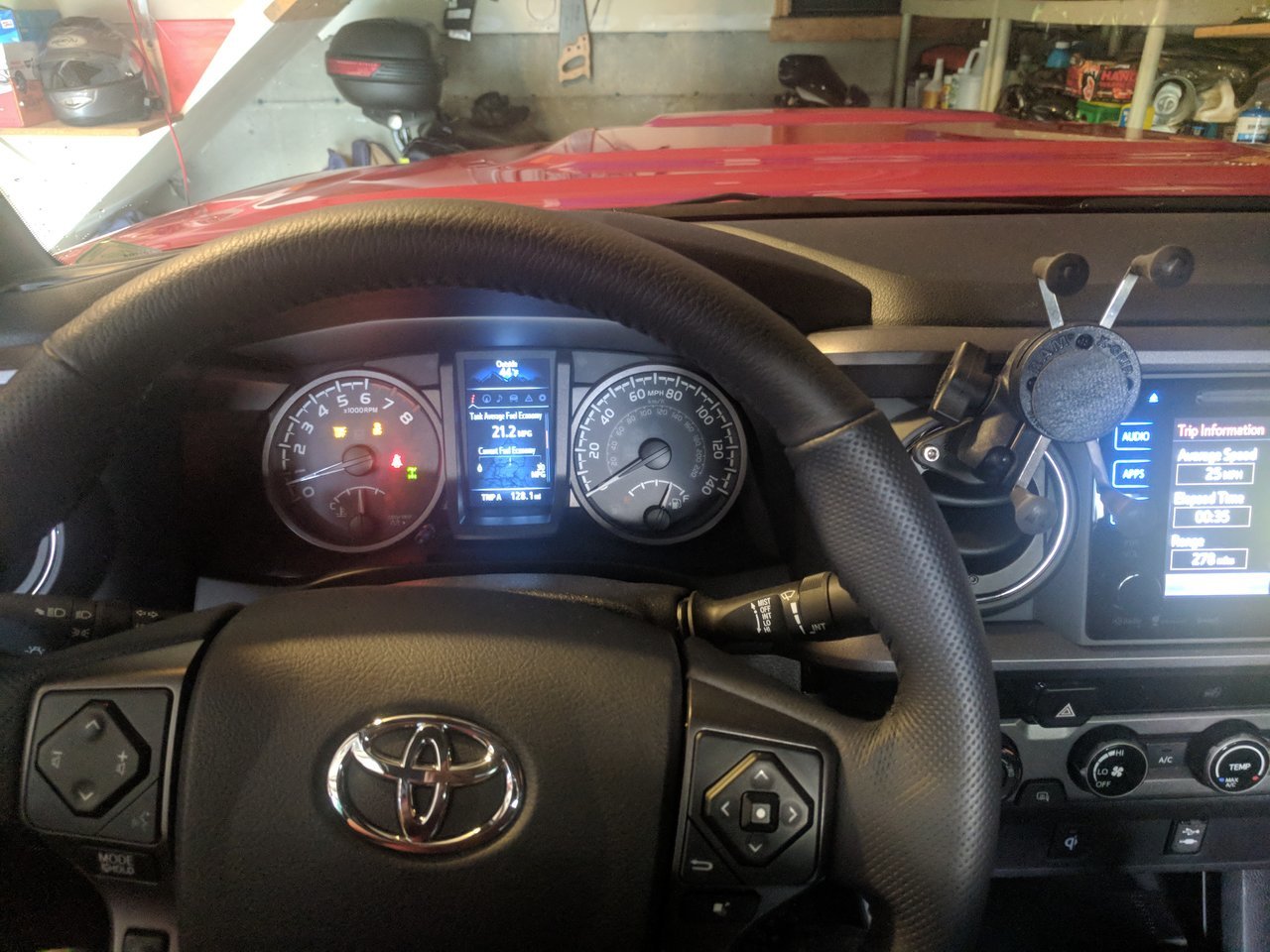

    Here's mine:
    2Hi Start Up:
    2Hi Quick Press:
    2Hi Long Press:
    4Hi Start Up:
    4Hi Quick Press:
    4Hi Long Press:
    4Lo Start Up:
    4Lo Long Press:
    Edit: whoa! Sorry about the crap pics.

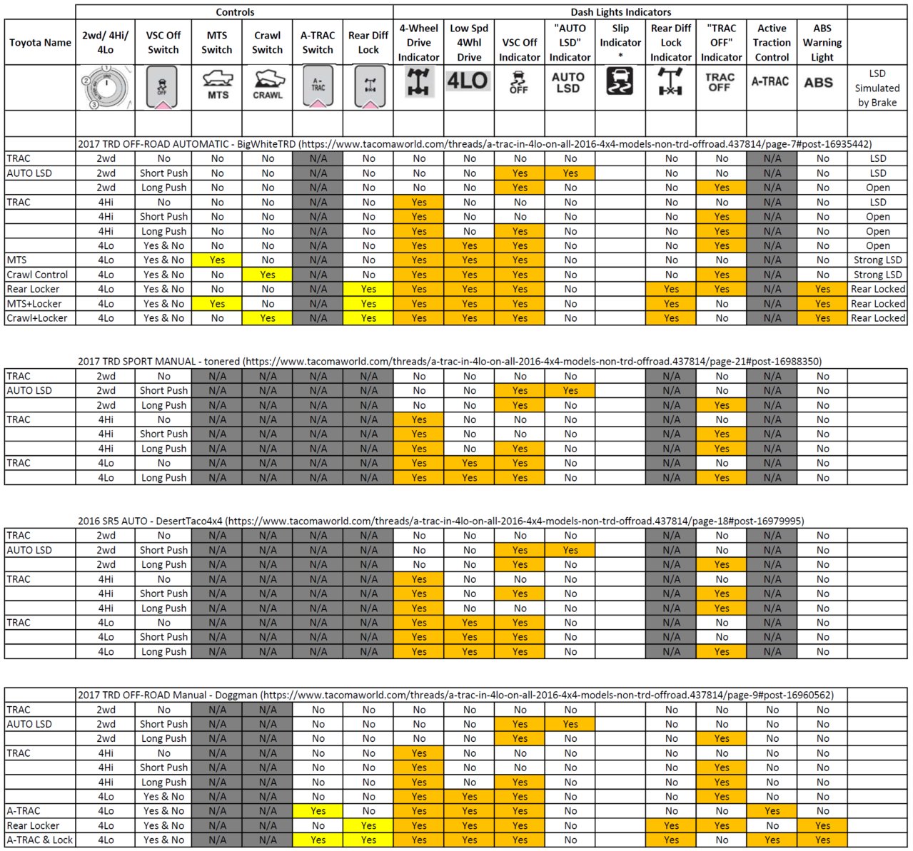

    Still Good Enough Pics. Much Much thanks.

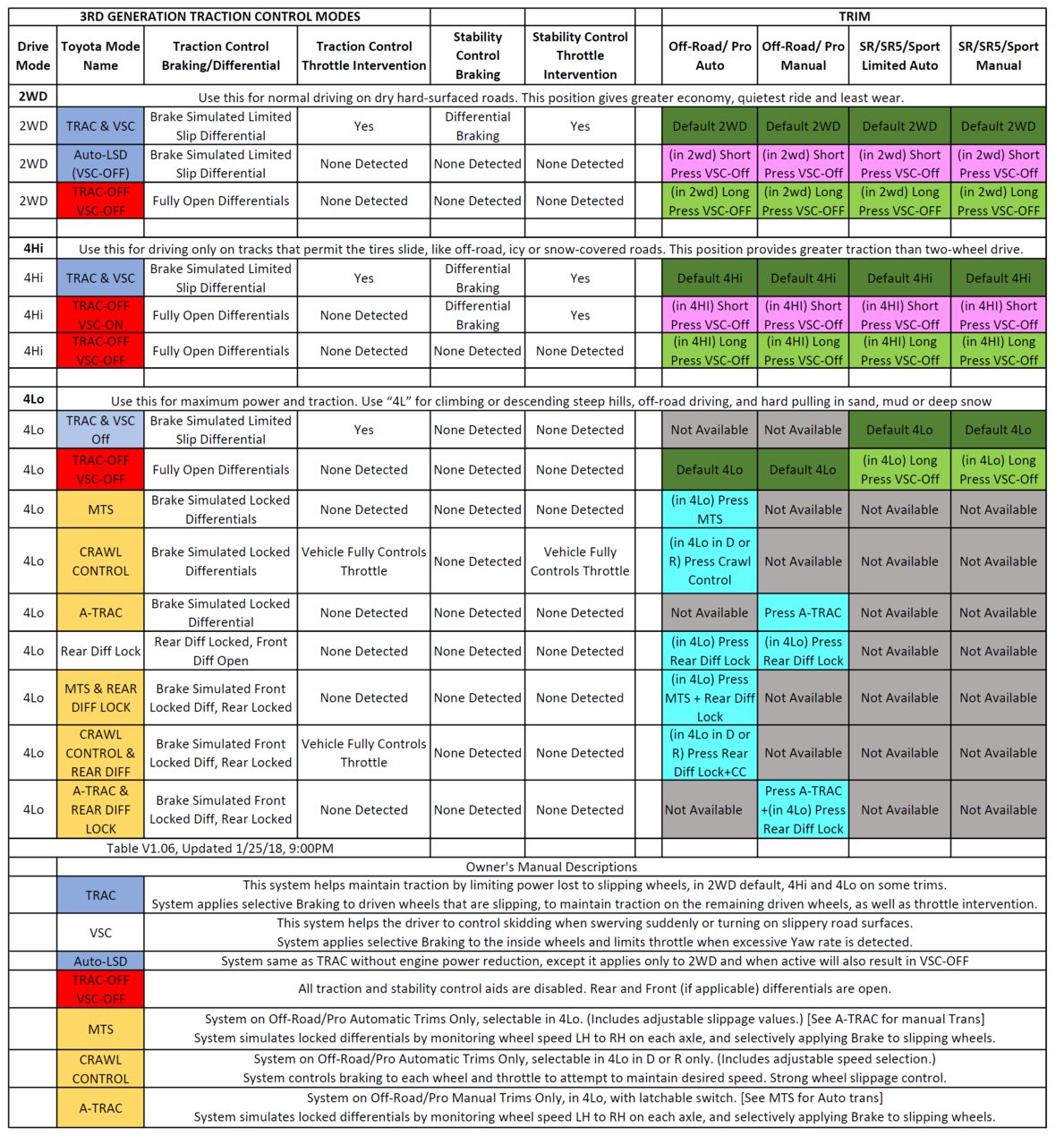

    So I had at least a few errors, (which people have probably pointed out, but I have not been up on fixing).
    I hope I didn't break anything that was correct.
    Well I don't know if we will ever prove it much better than we have now. How about some double-checking guys. New thread time?
