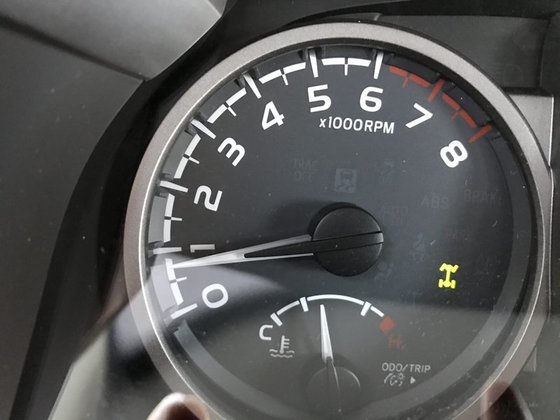

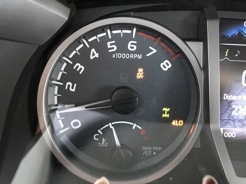

    L4 at startup: green drivetrain diagram light indicates 4wd
    Press squiggly lines car button, nothing happens
    Hold same button for a few seconds (3-5),
    TRAC OFF light comes on.
    I'm still thinking that in some capacity there is some of the auto LSD love going on in 4lo
    I will mess around with 4H next time I drive it, 4hi is further down the list since I only ever use it in the snow, and it doesn't snow often here, and I'll probably drive the jeep in the snow because it's already undercoated and has aggressive tires, and is less likely to get messed up in a crash (my fault or otherwise)

    That is the VSC OFF light on in L4. Your photo does not show AUTO LSD or any TRAC function (in L4).

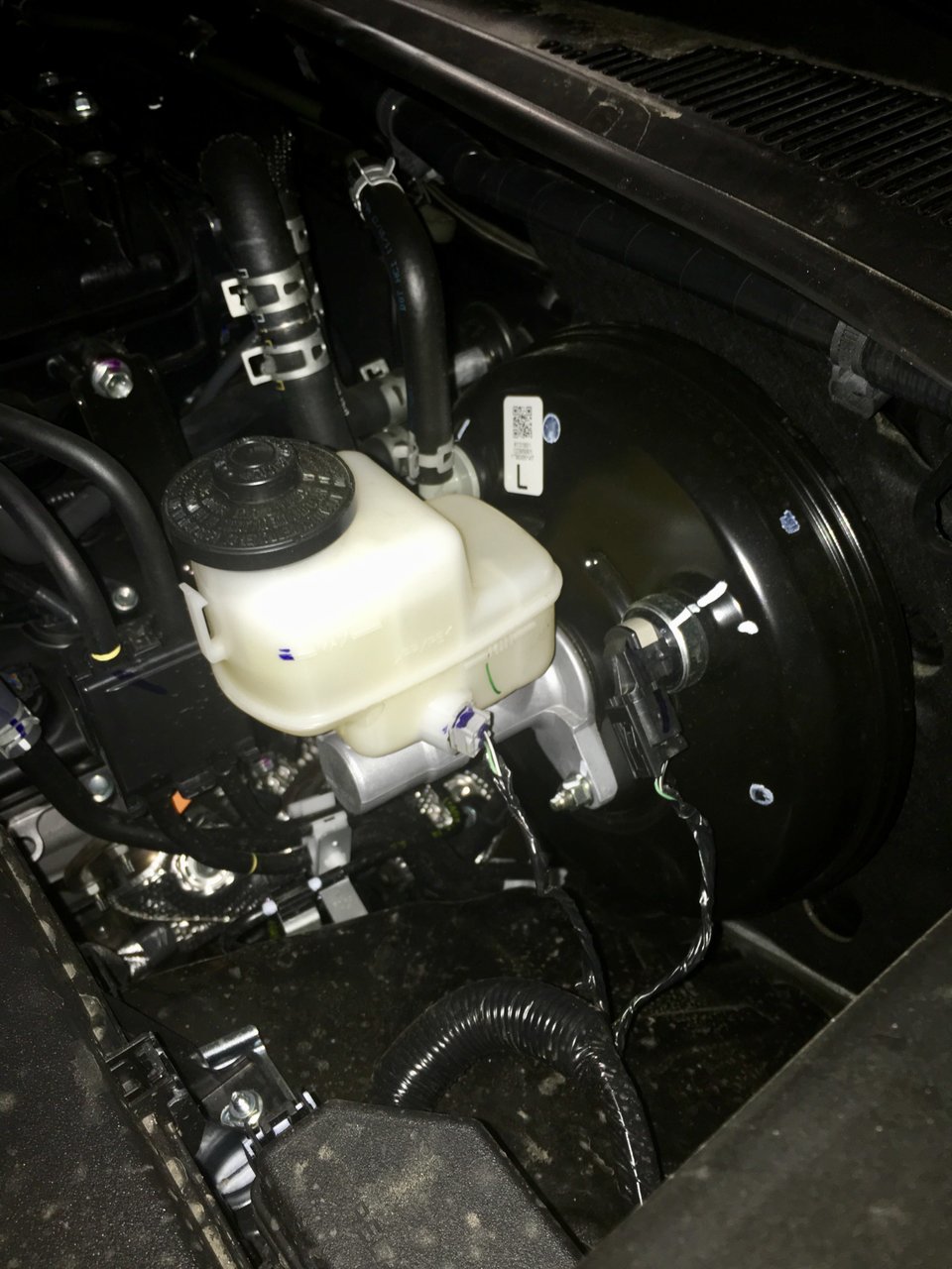

    Sorry for the hiccup members. I slipped past post #5 which explains the electric booster. But here is the picture I posted
    TheChief, if you stumble into the auto lsd saloon by chance, care to share how the system has handled so far? Brake wear and all. Can’t wait to go wheeling this weekend to find out how it works.

    This Picture is of the Normal Style Vacuum Booster, not the Electro Unit Type that operates the A-TRAC or Crawl Control Systems.

    This stuff is mind boggling. Thanks for the clarification.
