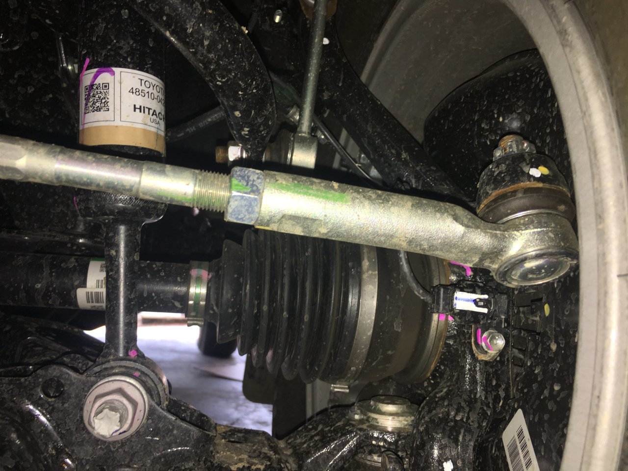

  4. Jan 19, 2018 at 11:26 AM
    #124
    BigWhiteTRD

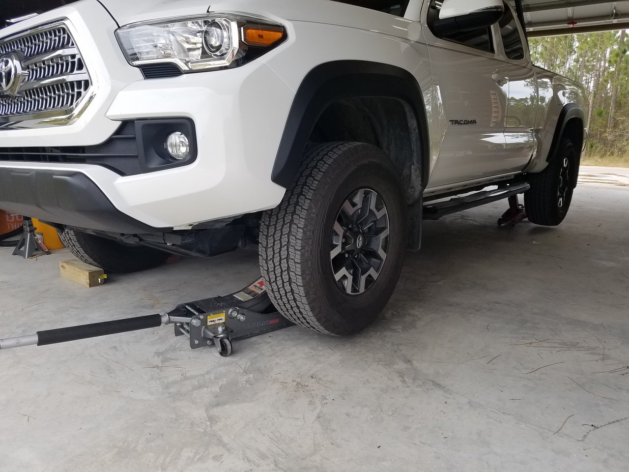

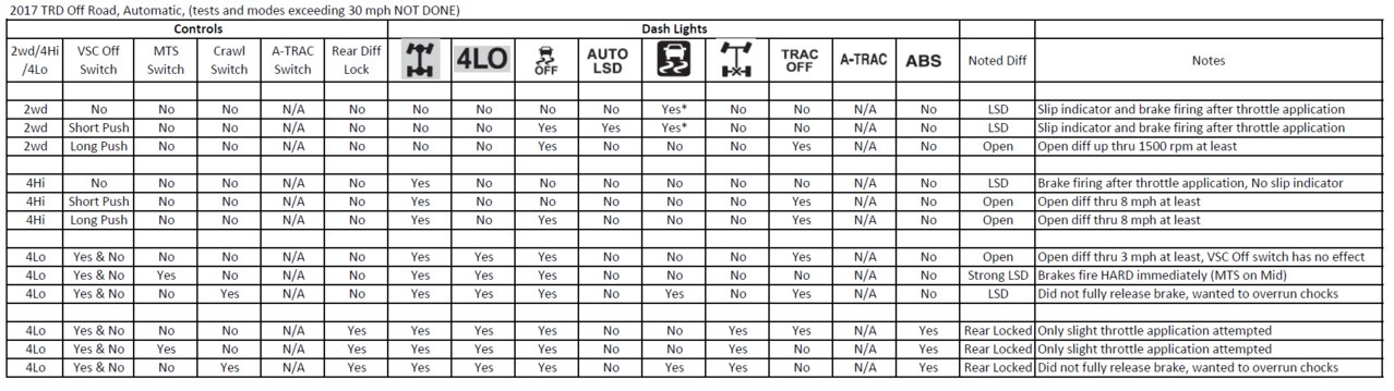

    So I am trying to do a pseudo scientific examination of the modes. To try and do the work logically, I always prefer to start with a bench test (if possible). A bench test isn't necessarily going to tell us everything, especially after big wheel spin or when throttle regulation occus, but I think its a good place to start. For my test I am using my 2017 TRD Off-Road (access cab) Auto. I hope somebody will repeat the test using manual tranny and using a non-Off road/Pro.
    I am primarily examining open-diff vs brake enforced limited slip operations, at low throttle settings that can be simulated on the bench.
    To do the test, I jacked up both left hand tires clear of the floor using floor jacks, with the jack wheels set fore-aft. Both RH wheels were carefully chocked. The steering wheel was maintained straight forward or all tests. For the test, I placed the vehicle into the test condition (by manipulating the drivers controls), placed it in drive with my foot on the brake, observed the dashboard lights. I then took my foot off the brake and observed the dash lights and speedometer, and the tire movements thru mirrors. I then applied a slight amount of gas while monitoring. If the I heard/felt the hydraulic brake actuator fire, I terminated that portion of the test, and assumed some Limited Slip Differential was in effect. If no LSD was observed, additional throttle was applied up to about ~1500 rpm maximum, at which point the test was terminated if the brakes never fired.
    For tests that are known to have strong LSD or locking, only very light throttle application was used, to avoid overrunning the wheel chocks, which would have been easy. These were a bit scary. An interesting note, for all modes of brake LSD, the brakes only fire after applying throttle. In drive with LH wheels in the air, no throttle speeds of 4 mph were noted without computer intervention. Only after applying additional throttle did the LSD system activate brakes. Even with MTS active, the speedo indicated 1 mph with the LH wheels just turning away happily with no throttle application, and then even a tiny amount of throttle causes huge hammering.
    (Edit to note, I won't absolutely guarantee that this table is error free. If anybody disagrees with any of the noted observations, please let me know and I will double check that particular observation)
    My obersvations

  5. Jan 19, 2018 at 11:47 AM

    Very good, Big White!
    As soon as I get a day off without snow or rain, I shall attempt the same experiment with my 2.7 SR manual, and report back.

    Nice test! I agree that the setup is nervy though. You do have some safety margin using rolling floor jacks.
    I have been thinking of trying something similar using my ramps (I only have one floor jack). One right front and one left rear? That way I can observe the LF tire as the suspension flexes out.
    All of the TCS systems that I have seen will allow free movement at idle in 1st gear. Your results there, even with MTS engaged, makes sense. There has to be some built in threshold to account for turns and/or an underinflated tire.

    So in the sport in 4LO, with no button pressed, you DO NOT have the "TRAC OFF" light, correct?
    That is definitely different from my 17 automatic TRD Off road, which does have "TRAC OFF" light on in 4LO, until turning on MTS, etc.
    I think it is probably time for a new 4wd traction control thread, because it definitely looks like the plot is thickening.

    Exactly. In 4Lo at startup, I only have the 4wd and LO lights. With my uphill two wheels in snow and two wheel on pavement experiment, I got a TCS light to flash up when pulling out. The Taco moved without hesitation and didn't pull to the right. It might not be a strong function because I could not get a light when playing in snowy parking lots. So, it might let Sports get a bit more initial wheel spin?
    I wanted to repeat the experiment with the long push / TRAC Off, but I was in someone else's neighborhood and didn't want to get anyone angry.
    I agree. A new thread for all Tacos would be good. Your post and comprehensive spreadsheet would make a good initial post.
    It seems that MT SRs and SR5s have the same functions as the MT Sports. So, it might just be SR, SR5, and Sport in on group and ORs and Pros in the other. It seems that AT versus MT might only be the OR A-TRAC function?

    Would you be willing to fill out a copy of my spreadsheet, just with the dash lights at least. With those two data's, I will post up a new thread.
