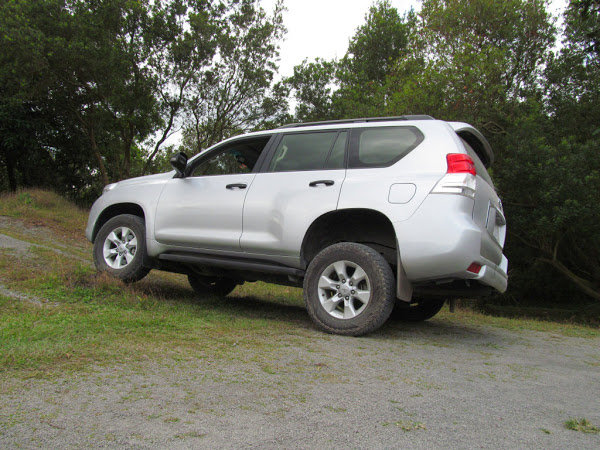

    Yep, sheetmetal is mostly common between the Prado and GX. Those two share the same frame and suspension as the 4Runner, though. Depending on country, the Prado also lacks much of the GX's luxury equipment and is priced closer to a 4Runner. Rented one in Costa Rica while on vacation. Pretty cool!

    I really like the lower part of the Bumper/Skid on the truck!
