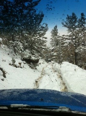

    You can ask me, via the PM here if you wish. Could you be more discriptive of just what happened to make you say A-TRAC 'failed you' in snow. Have you been successful with it in other L4 situations? In other words, did you put your foot into it when the truck seemed to stop moving? Most who complain just give up instead of making it work.
    I don't get to do too much snow four wheeling, but did a couple times last winter... When I was in need of slow going because the snow and mud was deep, I had A-TRAC on (always in low range) and I also engaged the rear locker (mostly to put it to some use, since I normally don't use the locker with A-TRAC).
    Anyway, I did just fine with A-TRAC in snow... but again... we are talking not very deep.

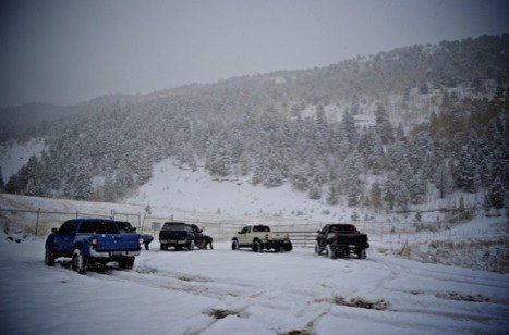

    a6cd8d67-0192-e06b_1163ea5520862e94e49410d8edd6d7155026c0e3.jpga6cd8d67-01aa-1ddd_e85c46eade4706b12d5c65202f80507ae877ca8a.jpgIt was in the hills and fairly deep. At the time I was climbing a grade and was stuck. No matter what I did it would not keep moving. I stopped, disengaged A-Trac then it kept on climbing

    Good thing it is just a quick button push to turn off... Did you lock the rear differential?

    Yup rear was locked
