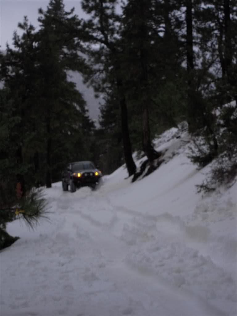

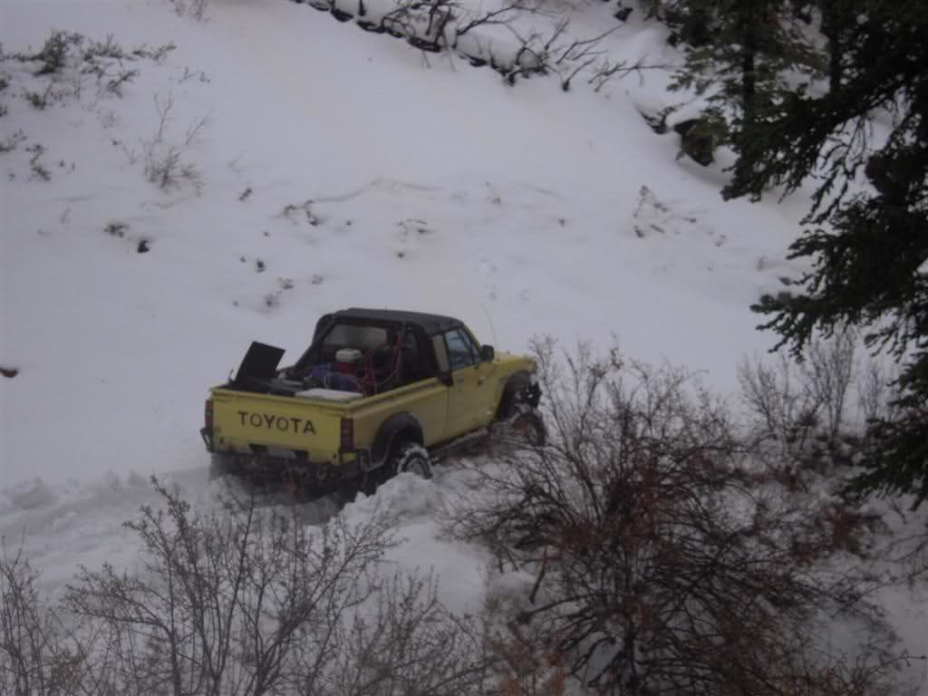

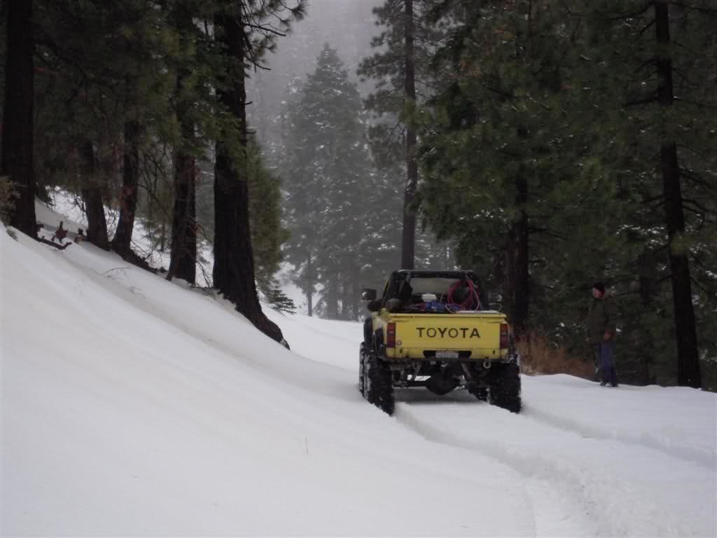

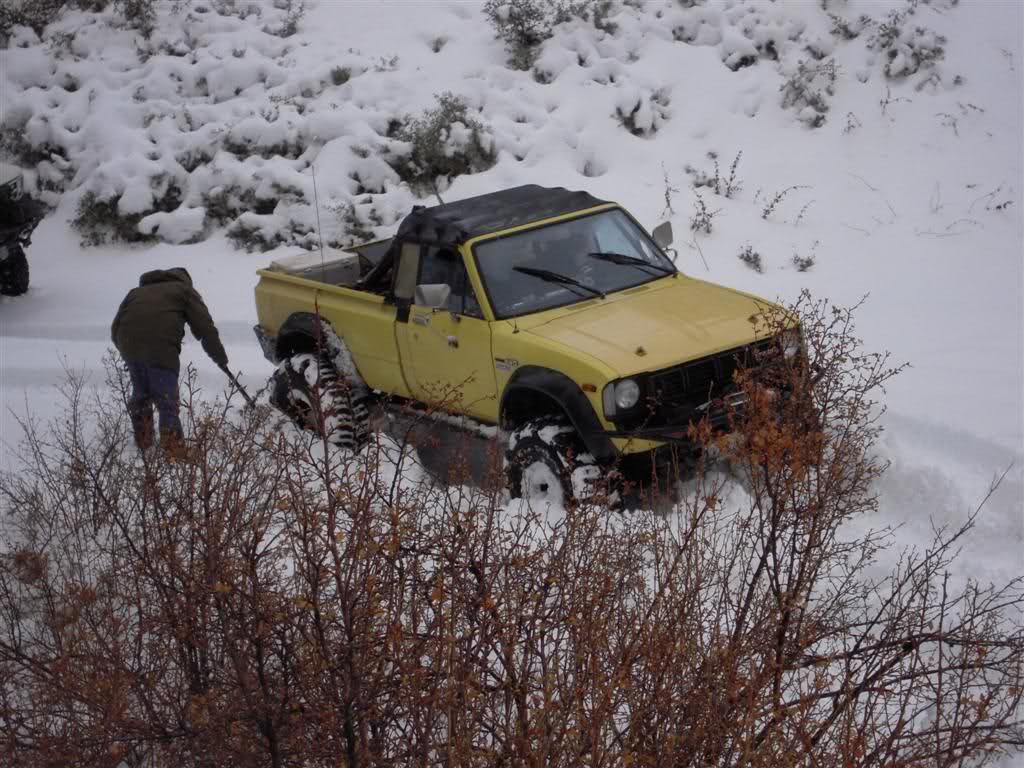

    meh..all i know from experience in wheeling in the snow(same principle applies to yucky mud, sand, loose gravel blah blah blah) is that you need momentum momentum momentum. my last big snow wheeling adventure in Big Bear had us cutting through fresh snow(breaking trail)on the fire roads that we were on.
    here's my buddy's rig with a LS1 on 37's so you know there was plenty of horse power but we still had to stop and shovel snow.. no way a vehicle with ATRAC would be able to cut through the snow as it would prevent the wheel speed that is needed..
    me:D
