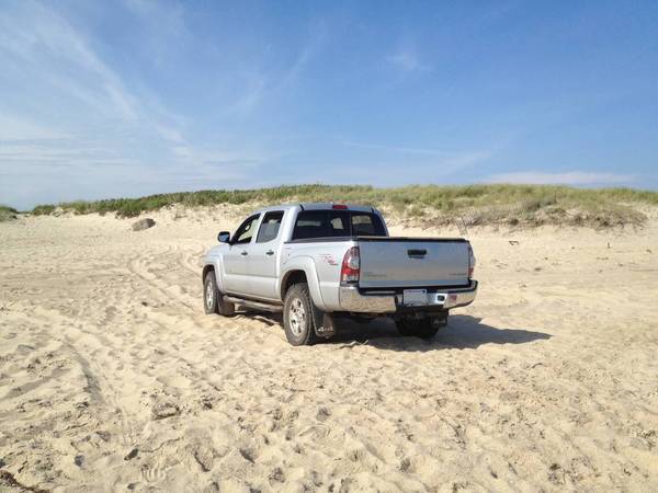

    Your posts are great and have been really helpful. I have had my truck (same as yours) for about a year and I just took it on some trails and to the beach. Seems like every question I had you had a post for it. It had just rained and I wasn't sure how deep I could go through puddles. Saw your mod. Thought it odd that A-Trac was not on in H2 and thought I was looking at it the wrong way. Was nice to hear someone else think the same. Anyway, thanks for sharing. Here is my girl's first trip to the beach.
