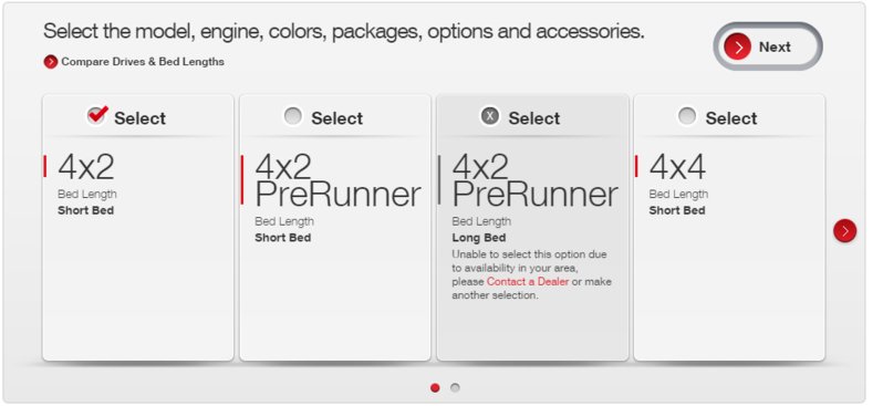

  19. Feb 17, 2015 at 7:48 AM
    #1279
    js312
    js312 Well-Known Member
    Apr 20, 2014
    #128076
    5,803
    Joe
    New England
    23 F150 PowerBoost Lariat 502a
    Husky Weatherbeaters, OEM Mud Guards, Wheel Well Liners, Bullet Spray-In Bed Liner, Gator Soft Tri-Fold Cover, Michelin LTX M/S2 (Summer), Blizzak DM-V2 (Winter)
    Double-cab options from the Toyota website. The DCLB 4x4 is cut off to the right, but you get the idea:
  20. Feb 17, 2015 at 7:53 AM
    #1280
    OZ-T
    OZ-T I hate my neighbour
    Dec 15, 2009
    #27584
    50,587
    Peter North
    British Columbia
    Short Bed
    There it is
