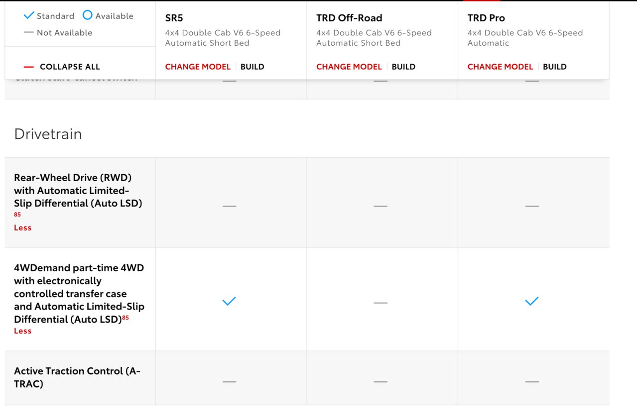

    So what's with Toyota's summary for the 2020? Off-Road does not include Auto LSD or A-TRAC.... Pro is left out on A-TRAC... :confused: Also appears to have added a new term 4WDemand? FYI I'm just learning about this stuff as I'm trying to decide on buying a SR5 or OR (new to 4WD and Tacomas). This chart totally threw me off...

    That chart also makes no sense to me. Hope someone can clarify.
