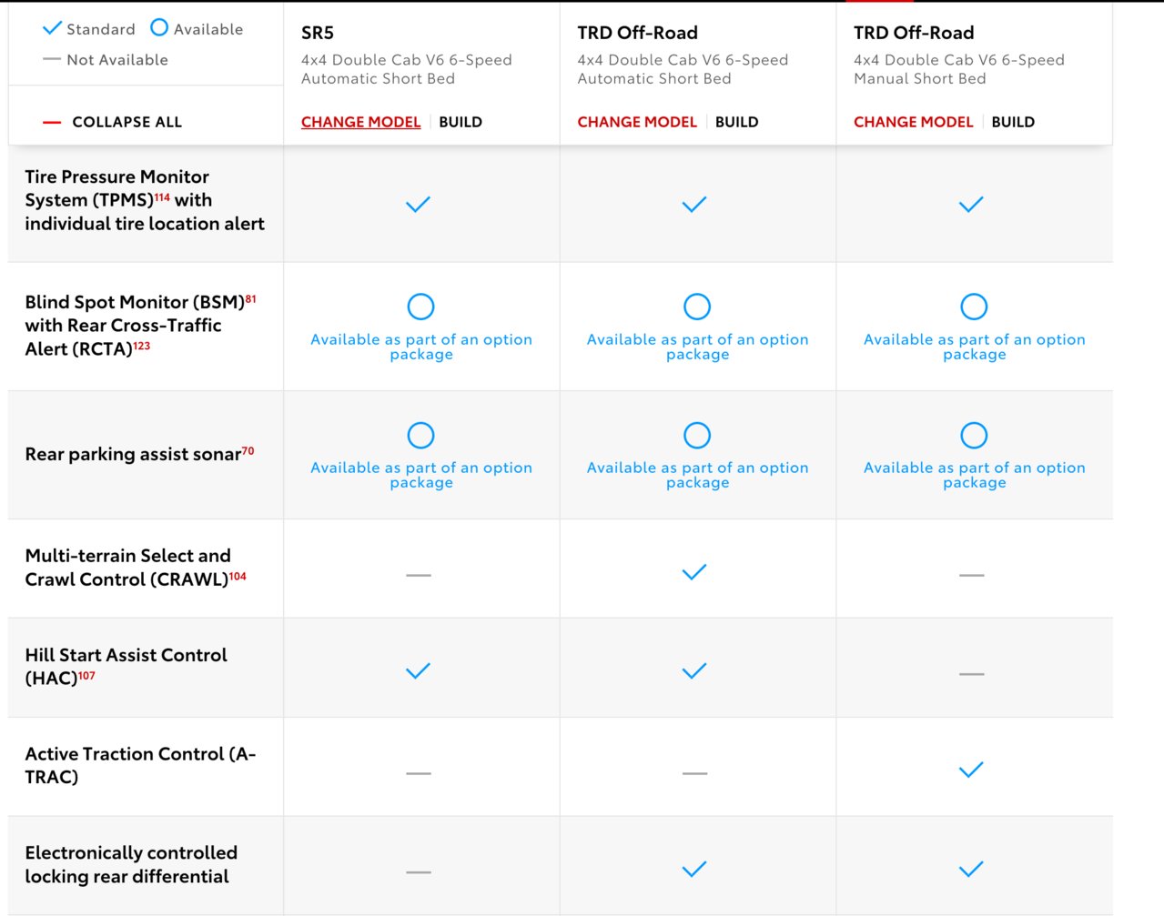

    I'll admit I didn't read all 73 pages... I think I stopped at 20? :D was this chart explained on page 71? I just figured it should have a few more check marks....

    OK I went back a few pages and see where A-TRAC basically is MTS for automatic off-road trims. So then I remade the comparison.
    So it's still a confusing comparison because they don't list MTS and Crawl Control.
    And then I had read in the thread that Off-Road trims do have Auto LSD but based on this they do not...?

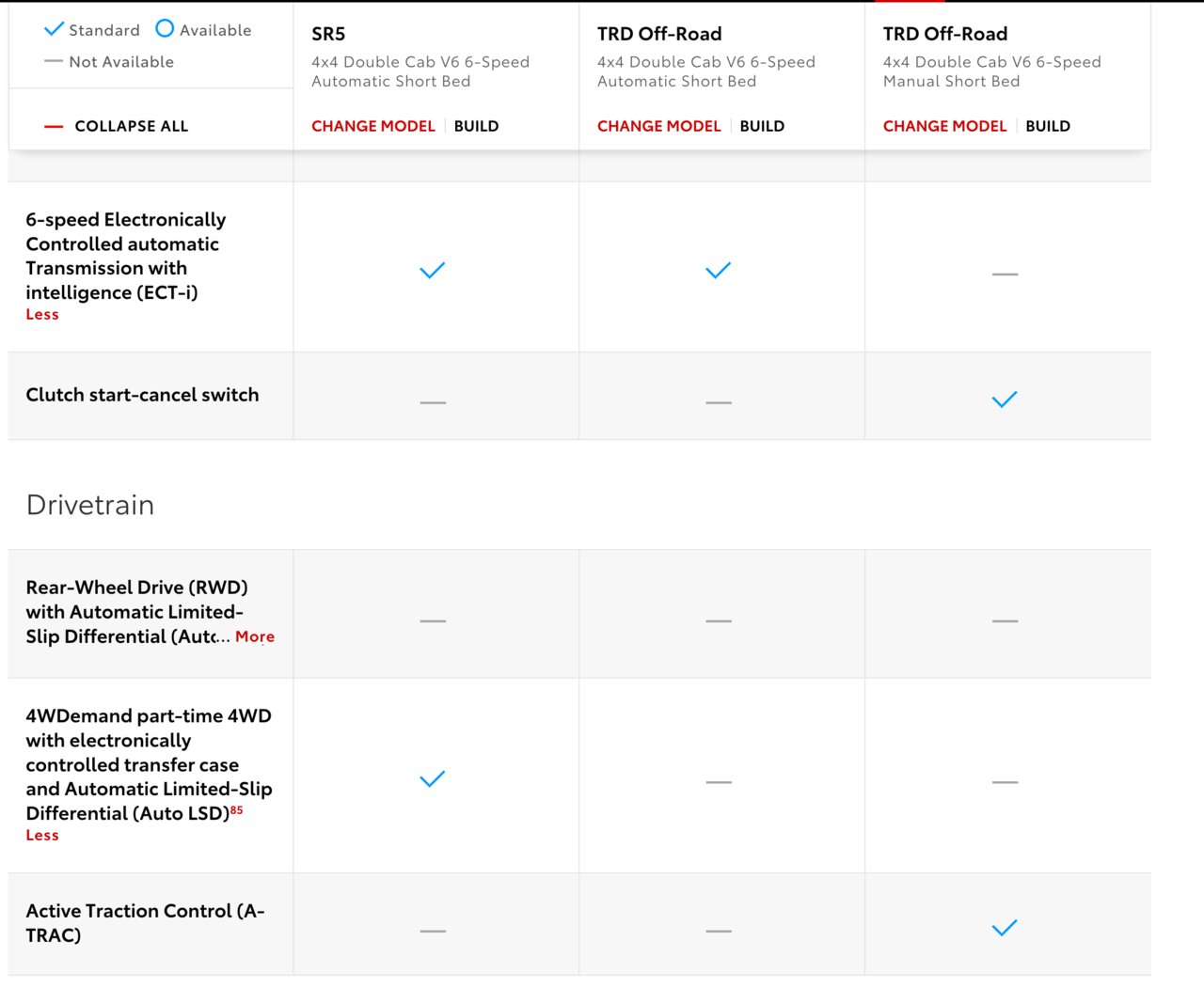

    Ahh it is under "Safety and Convenience"... Still confused on why Auto LSD is not listed on the Off-Road trim.

    Just guessing here, but by looking at the screenshots the SR5 model lists the Automatic limited-slip Differential, which makes me think it might be an actual LSD in the differential. The OR trim has an E-locker in the differential, the auto LSD on the OR trim is a computer trick with the braking system to limit wheel slip as part of the TSC. Not an actual limited-slip Differential.

    First Chart is no good. Second one is.
    Off Road (and Pro) have the traction aids (locking differential and MTS/CRAWL (automatics) or A-TRAC (manual trans).

    David, thanks for your input. Reading your posts it seemed for sure that the Off Road trim had Auto LSD. However, the thread started 8 (?) years ago... It seems on the Gen 3 model (or at least 2020 year) Auto LSD does not exist for the Off Road and Pro based on the first chart (which is a screen shot of Toyota.com's comparison tool).
    I was trying to confirm this because I was assuming Auto LSD would help with traction while in 2WD driving on asphalt during rain. I live in Houston and a lot of my time will be spent driving family around on asphalt and in heavy intense rains. We currently drive a Mercedes E350 Estate (wagon) with AWD 4MATIC and it is incredible how it sticks to the pavement in a rainstorm going 70+ mph. I know a truck won't drive like that but I'm weighing whether to purchase an SR5 or OR trim... I'd rather go with the OR trim to have the extra insurance if I get stuck on a beach, but if only the SR5 has Auto LSD in 2WD....
    So really two questions:
    - Does OR have Auto LSD or not? Clearly the SR5 does have it.
    - Will AutoLSD aid traction in heavy rainstorms on asphalt (in 2WD)?

    AUTO LSD is only needed if your 2WD can't get moving from a stop by allowing full power to the traction tire while braking the tire that wants to spin.
    If you have 4WD then that would work better as long as you return to 2WD on dry pavement.
    The AUTO LSD selection should be in both 2WD and 4WD models. No reason to remove it.
