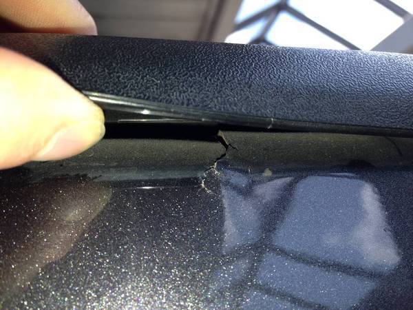

    I have been carrying my spare, a general grabber 33x12.5x17, using a bedside mount for 10 months. A few weeks ago I noticed a wrinkle in my bedside which was pretty close to where the carrier was located. You can see where my tire was in this picture.
    This Monday I took the tire carrier off while I was rotating the tires because I didn't want what I thought was a small buckle to turn into a crack. Then we get to today. A buddy was looking at it and peeked underneath the bed rail cap. Guess what
    I guess I was a little late in trying to keep the wrinkle from turning into a crack huh?
    The bedside is cracked clear across on the top and has separated along it's seam. Fantastic! I guess I'll be taking a trip to the dealer to inquire about getting them to fix this under warranty. I can't see why a tire, with all of it's weight ont he bed of the truck, can cause this kind of damage if their bed rail cleats can hold 200lbs and the rail can hold 400lbs.
    I know steel, and I realize this is a stress fracture from the tire moving up/down and left/right while driving on bad roads and offroad, but the bed shouldn't crack like this. My hopes aren't high that the dealer will do anything about it, but it never hurts to ask.
    The tire carrier was mounted to the rail directly between two of the bolts that hold the rail to the bed. The failure is directly in-line with the last bolt on the rail.
    One way or another I'll have to get this fixed as I'm afraid the crack will continue to grow. You can see there is a second crack towards the back of the truck.
    I would caution anyone with a tire mounted similar to mine to check for cracks. There are two plastic holders on the inside of the cap that have to be pulled out then you can simply pop the cap off and see for yourself.
    The maker of my carrier isn't the issue here, it's the weak design of the tacoma's bedside.
    I'll see what the dealer has to say, and no, I'm not holding my breath. :)

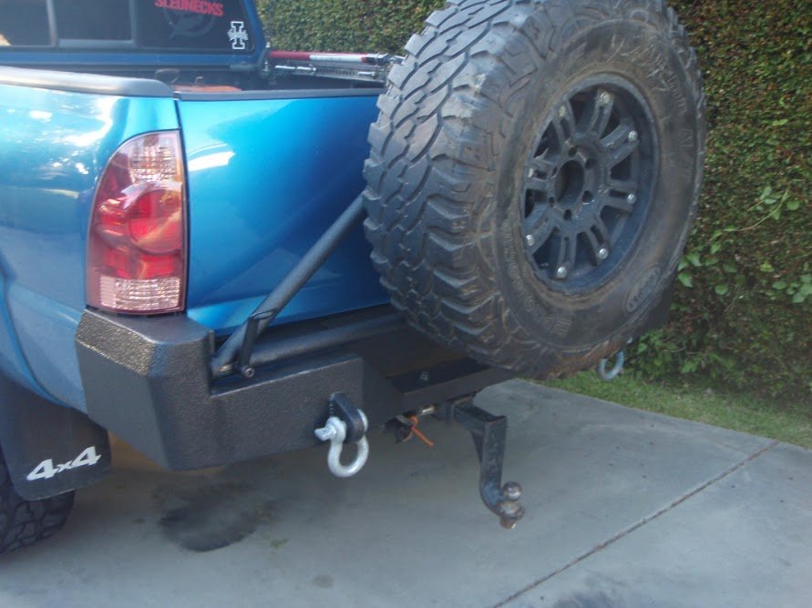

    54,640
    ID
    i had a side mount like that. I need to check if it mess up my bed to :S.
    here is what i have now.

    Correct, the cracked part is the metal skin of the bedside.
    I have to park in a garage at work so that's a no go. With my luck I'd buckle the roof.
    What he said, but they'll fight me anyway.
    Nice.
    I was very surprised to see how little structure there is under the bed rail cap. The only thing keeping the body together back there is the thin sheet metal that cracked, and it only overhangs the inside by an inch.
