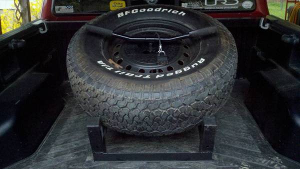

  15. Jul 11, 2013 at 9:38 AM
    #35
    aaronbuell
    aaronbuell Well-Known Member
    Nov 30, 2011
    #67967
    304
    aaron
    windsor NY
    09 TRD/OR Access Cab V6 debadged
    Fog-light anytime mod, ,black grill,URD short throw,TRD decals removed ,debadged,black rear bumper, homemade tire carrier,TreadWright tires,Evo mod,removed rear headrests and seats,ABS kill switch mod,black center caps,Clarion CX501 head unit,Relentless hood brackets with floodlights.
    hope mine don't do that [​IMG][/IM
    [​IMG][/url]
    3rd pic is in the up position with the rear cross bar mounted about were the op had problems
  16. Jul 11, 2013 at 9:45 AM
    #36
    scocar
    scocar Patron of the Farts
    Nov 11, 2009
    #25814
    40,080
    This x3 ^
  17. Jul 11, 2013 at 10:21 AM
    #37
    mr2mki
    mr2mki Well-Known Member
    Jul 1, 2013
    #107429
    214
    aaronbuell, it looks like yours is braced in 3 points. It shouldn't be doing any flexing. If I'm reading the pictures right, that's a good example of converting the dynamic load of the OP's setup to a static loading.
