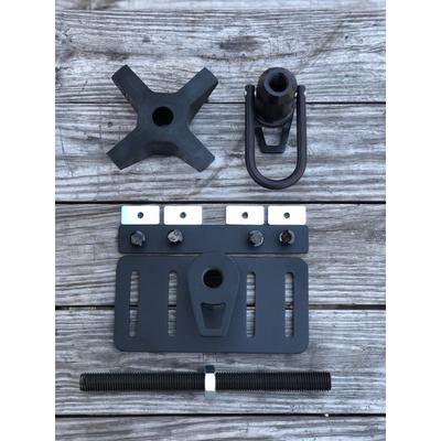

    Wilco makes this. Tire sits flat up against the front of the bed and the base. You can adjust it for different size tires. You could also throw a strap over the top, but I don't think it's necessary. I just picked one up and only time will tell if it's going to be a problem. Anyone else running this setup?

    At the very least, add these: https://www.relentlessfabrication.com/collections/toyota/products/05-tacoma-bed-tie-down-bracket
    They should greatly reduce the flex from the heavy tire.

    Freshly pilfered from the net. I was thinking of going this same route.

    Ok, now I see. Those are real nice. Thanks.
