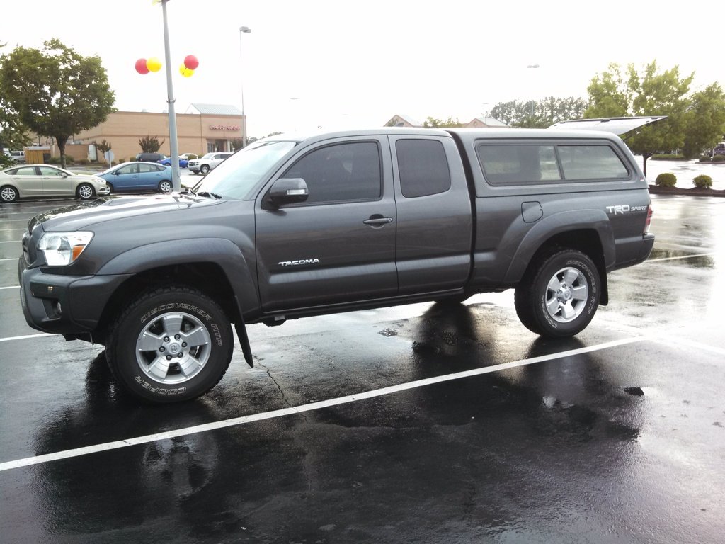

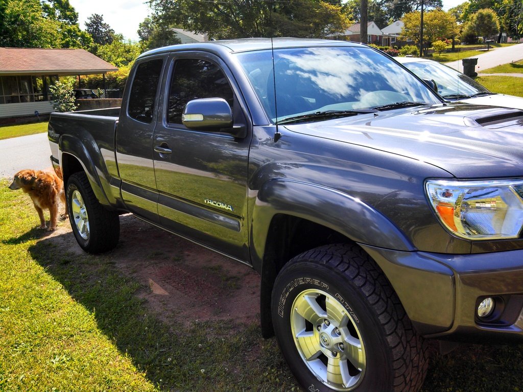

    2014TRDsport
    5100's all around with OME 884 at 0. Weathertechs, Carhartt seat covers. BFG KO2's 265/70/17. T4R SEMA wheels. 18% tint on front windows. General Springs HD 4 leaf pack, Leer 100 XR shell.
    these are the only pics I have at the moment. 883 and 5100's all around. i dont have any side shots to show the wheels flush with the fenders but thats how they sit with the 1" spacers. I got a little over an inch up front after the springs settled and the ride was great.
