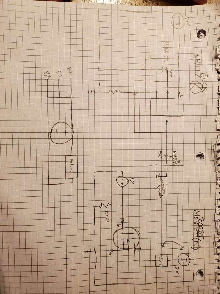

    I built and tested the step up converter on a range of supply voltages and it worked. It was a very simple circuit with a IRLZ44N transistor and a 10kOhm resistor, so I am pleased that it will be easy to replicate on other channels (although I will only have 2 or 3 different 12V outputs if all goes according to plan).

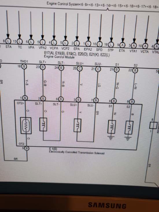

    Okay, did some testing with the actual ECM today, and the solenoids are working as expected, but the tachometer signal/ pulseIn() function was not. It looks like with 2012-2015, the comms with the tach are strictly CANbus only. So, my options are to a) read in via CANbus, b)attempt to create a new formula for the transmission output shaft sensor that reads in to the ECU, or c) ignore and have no speed safety lockout like a real manual transmission. I am brainstorming, but I think I am going to try to go with option B. Seems like the safest with the least amount of rework.
    Solenoid diagram and pinout from ECM (for later Gen 2s only, earlier Gen 2s use only 4 harnesses):

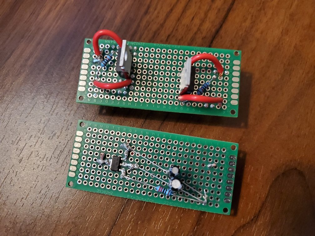

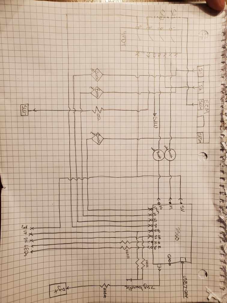

    I also got some PCB in, and I am working on simplifying the circuits. I have notoriously unsteady hands, so my soldering is usually abysmal, fair warning. I think for proof of concept and ease of replacement in the early stages, I will probably make each component on its own small circuit board. That way if something fails, I can remove it without taking everything apart. If it does work, I will probably make a second version that is more clean/ permanent (or more realistically ask a friend who doesn't solder like a middle-schooler).
    A functional test example on PCB of a linear buck/ boost converter:

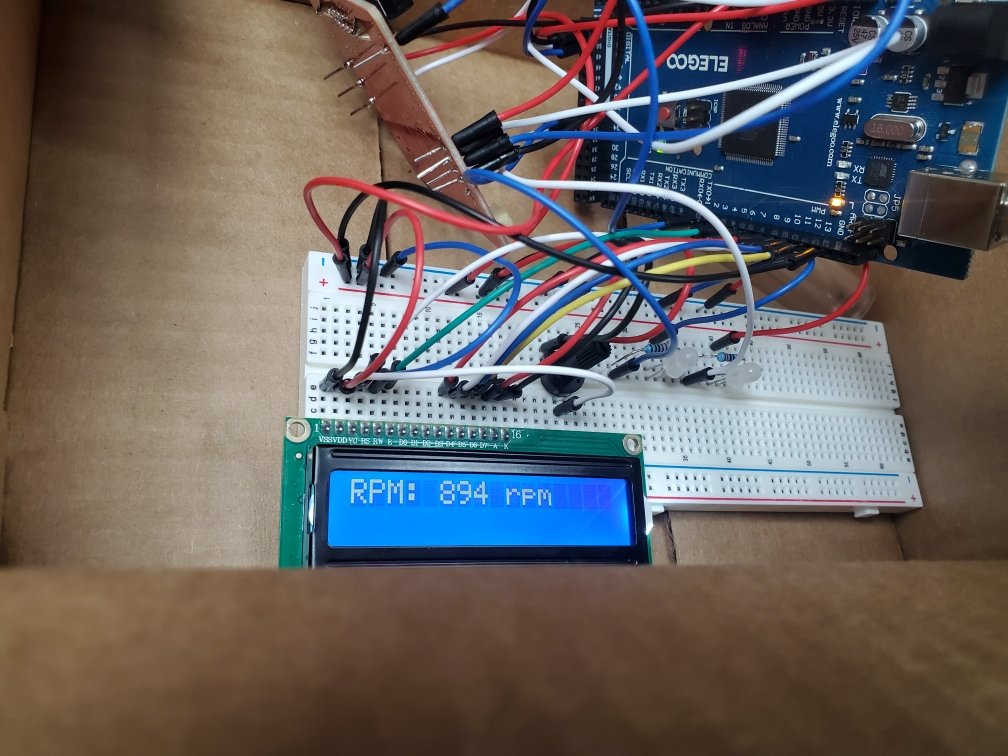

    Breakthrough! Was successfully able to read in engine speed. Had some issues with the CANbus upload speeds/ baudrate alignment, but got them sorted out fairly well. I am using a conservative high-pass filter to eliminate any noise that may come through under 500 rpm and interfere with the signal. The signal is accurate to about 50 ms scans, which is probably plenty fast considering the shifts themselves take nearly a whole second from the transmission (transGo valve shift kit in the future?).
    If anyone uses this method, it is worth noting that the controller shield does not fit a 2560R3 arduino, and you will have to edit the 'default' library to use pins 50-53 instead of pins 10-13 for SPI comms. I wont go into detail on this here since it is pretty specific to my particular scenario, but if anyone happens to get confused on this step in their own project, I'd be happy to help if you reach out.
    I believe I now have all signals working, and I just need to throw them into one singular routine and package things more neatly. I'd say I am reaching the end of the development stage of the project!

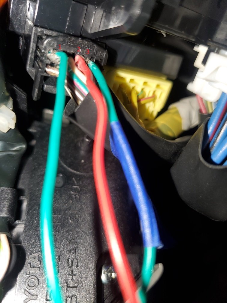

    Here is a photo of the holes under the felt that I am running the signal wires through up the shifter console to the dash:Resized_20250405_170637.jpg

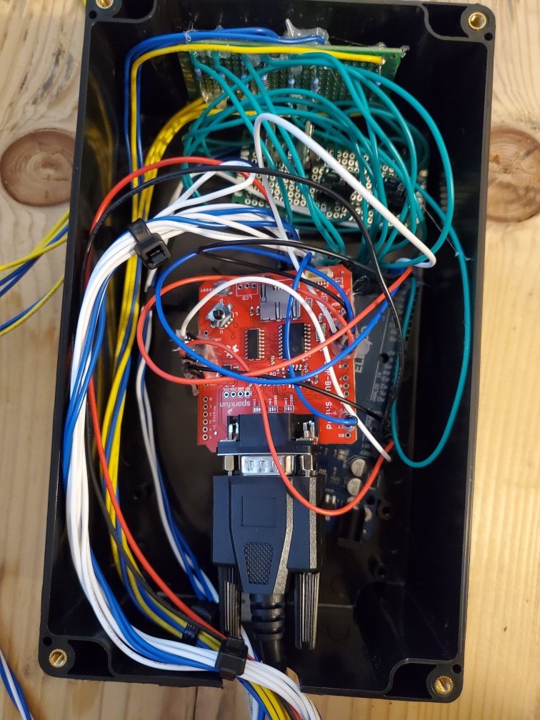

    Here is the general layout of the final enclosure... will fix the main circuit boards to the container after I have run it for a while. Want to have the flexibility to remove and troubleshoot if needed for a bit, but also dont want connections jostling around for long. Enclosure box hides nicely in the arm rest with lots of room to spare. Going to make sure the transistors have some breathing room in case they get hot.

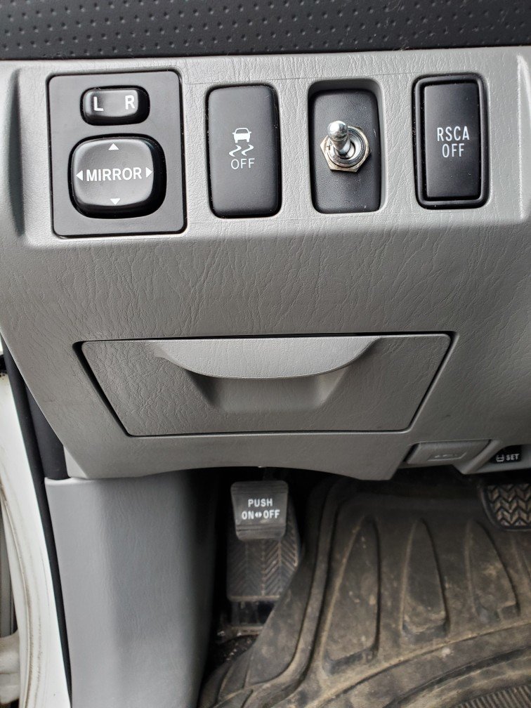

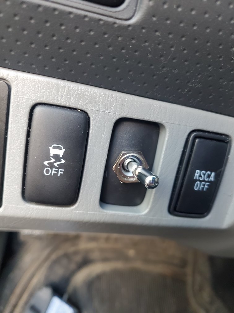

    Location of the 4PDT switch that will also toggle the mode from man/ auto:

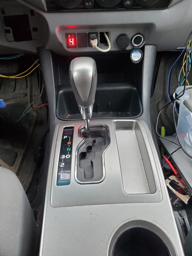

    My temporary gear indicator and shift light is... not pretty. Luckily it wont be the final resting place for it and will be getting updated in a year or so. For medium-term trial purposes, it'll be good enough.

    Well the rain stayed away long enough to make some progress, but not long enough to finish. Here are some status update pics.

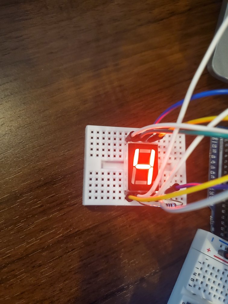

    Shift Lights and Gear Indicator (with wires dangling, still work in progress). Arduino is currently powered by the stock USB port, which is nice because it is fused, low voltage, and shuts off when the truck does! Will make this prettier, but I also need to be able to pull out extra length of the USB for future software updates:
    Manual/ Auto Switch now hooked up and functional:

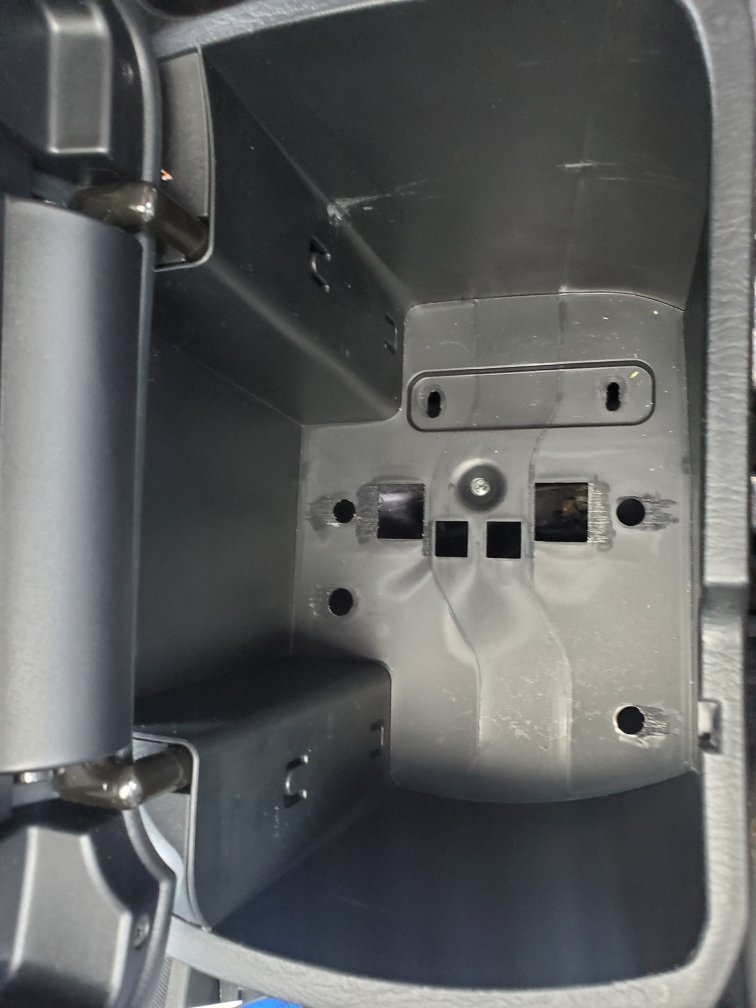

    How the little enclosure fits in the arm rest console. Going to run plastic tubing along the wires so I dont get issues with vibrations/ rubbing:

    voiddisplay1(){
    digitalWrite(segB,HIGH);
    digitalWrite(segC,HIGH);
    digitalWrite(segD,LOW);
    digitalWrite(segE,LOW);
    digitalWrite(segF,LOW);
    digitalWrite(segG,LOW);
    digitalWrite(segH,LOW);
    voiddisplay2(){
    digitalWrite(segB,LOW);
    digitalWrite(segD,HIGH);
    digitalWrite(segF,HIGH);
    digitalWrite(segG,HIGH);
    digitalWrite(segH,HIGH);
    voiddisplay3(){
    voiddisplay4(){
    digitalWrite(segE,HIGH);

  17. Apr 17, 2025 at 4:59 PM
    #37
    SmallerBaller
    SmallerBaller [OP] Well-Known Member
    Feb 7, 2024
    #443375
    83
    2015 Tacoma SR5 2.7 Auto
    Easter weekend just started for me, so I am hoping to wrap up this project by end of day Sunday! May be easier said than done in the time between traveling to see family, etc.
    Anyone have ideas for how to mount the paddles to the wheel? I did manage to get in touch with the person whose reference photo I included previously on a Tundra wheel, and he had used insert nuts, but I didnt glean too much more info than that. I am wondering if I should use some sort of expanding tree clips paired with a VHB adhesive in the holes, or an epoxy? I really want to make sure I have a good plan before altering the material on the wheel. Dont want to botch that, and obviously dont want the paddles to be floppy and loose.
    The wires are run to the clockspring on the column, but I have yet to take the wheel off. Gotta disconnect the battery anyway for the last round of ECM/ solenoid signal tie-ins, so I will yank off the wheel probably on Saturday when I do that.

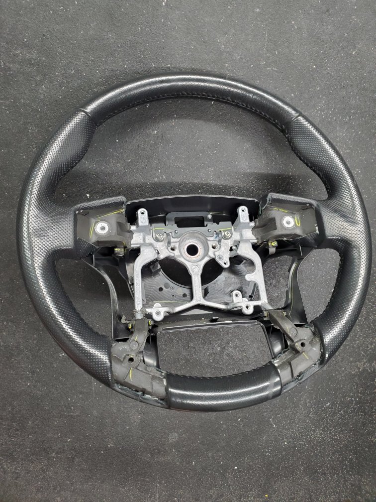

    I am not super stuck on having the factory wheel, but I am stuck on retaining an airbag. I also already have the corolla iM paddles that I have been testing with, so it would be nice to use those if possible. But something like you suggested would probably be a better off the shelf solution than mine, if I could make it work with my wheel or at least a wheel with an airbag!
    tacokarl[QUOTED] likes this.
  20. Apr 18, 2025 at 9:41 PM
    #40
    SmallerBaller
    Feb 7, 2024
    #443375
    83
    Got a couple hours of work done on the project. Wheel is off and clockspring is wired and tested. Paddles are working through the wheel and changing gears.
    1 = downshift, 2 = 5V/ ground (depending on how you wrote the code), 3 = upshift
    Here are the corresponding harness pins on the column side of the clock spring. This pic came out way worse, so I will just say the pins used are A, D, and E for wires 1, 2, and 3 respectively.
    Worth noting that for some reason this harness does not come with the female crimp terminal connections, so you will have to add pinouts yourself.
    Here are some drafts of wiring to the solenoids/ ECM to the main microcontroller from earlier in the process. They may be slightly different now, but they are still substantially correct for someone to reference. If you do your own version, you'll probably be doing it slightly differently anyway.
    Drafts of circuits for voltage regulation, where resistors are slightly adjustable based on the drop/boost you want to achieve:
    And as if I wasnt already in too deep, my steering wheel is now sitting in the house. Remember that before doing anything with the ECM or airbag, always disconnect battery and let it sit for awhile to discharge any capacitance. Luckily the weather was nice so I got to take my fun car out to visit family, but I will need the steering wheel back on very soon!
    Still not sure how I am going to mount these paddles. Honestly, a smart person probably would have started with that.... I am running out of time to keep kicking that can down the road!
