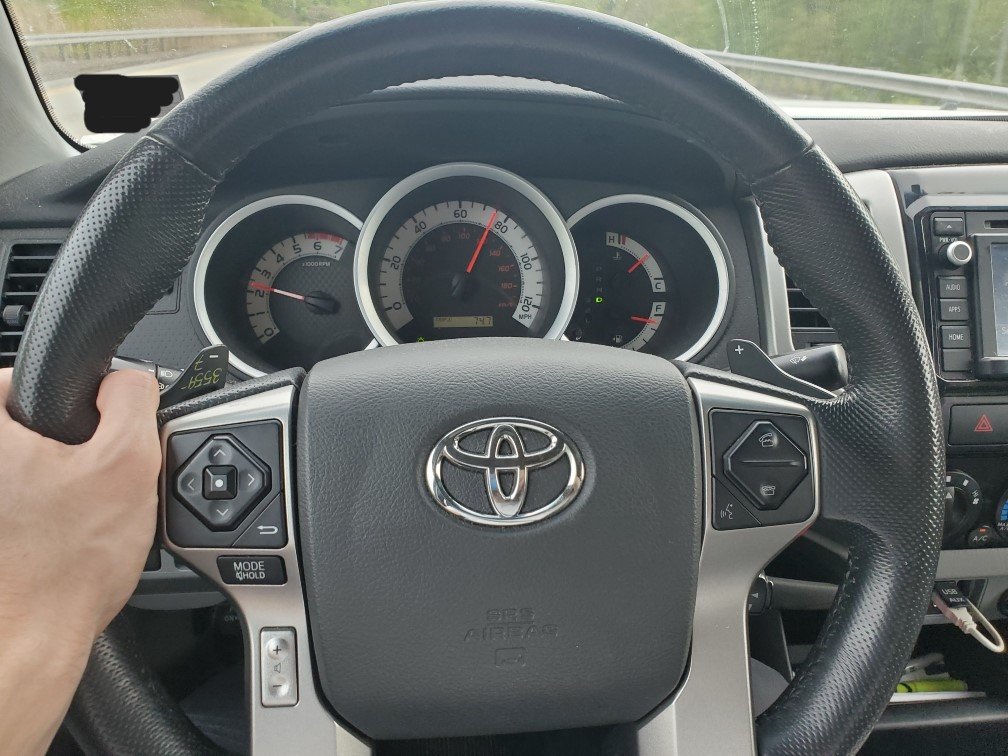

    Okay, so just for testing and the purposes of being able to drive, I used VHB strips to temporarily mount the paddles. It is NOT good enough to be a permanent solution. I am going to take the advice of @tacokarl and get a 3D printed bracket. Contacted my family member and he said he is down to help me as long as I do the design since his motor function is limited as he recovers. Seemed excited for something to do, to my surprise!
    So, the really good news is that the pass-through mode works perfectly. I can drive the truck no issues, which is huge because that means I got everything re-assembled without ruining my truck haha! Sort of bad news is, I can only seem to use 3rd and 4th gear in manual control. I am assuming this is an issue with an electrical connection or ground on Solenoid 1, because the commands and gear readout are still sequencing down to 1 and 2. About to storm, but I consider this a successful test and hopefully something easy to troubleshoot! They all worked when individually testing circuits, but I knew it wouldnt work getting everything back together on the first try... never works the first try!

    I think I figured out the problem! I am right on the cusp of being able to provide the amps drawn by the solenoids to reliably actuate. So, I am going to use 2 relays instead. I really tried to avoid this because it is just more added time involved in the already long shift time, albeit relays are pretty quick (relatively speaking). I will just grab a couple of fused relays and throw them in and the set up should be more consistent/ reliable. Everything seems to be working though, very stoked!

    New 5V relays are in and working! Was able to take it for a bunch of drives without any CEL coming on, in auto and manual. I do think there is still some electrical safeguard the arduino is doing... it is shutting off and resetting itself on certain shifts (just in manual) so I think there is some surge happening every now and then for shifts...maybe the relays are causing it in certain conditions. So I will keep looking into that, but I have driven a combined 5 or so hours over the weekend with a combo of auto and manual and only experienced the arduino reset twice, in which case it just goes back to auto. Not 100% satisfied yet, but I consider that a very successful test run! I will keep poking around with improvements to make it as reliable as possible, but I dont imagine there will be too many more updates other than maybe some cleanup and troubleshooting the voltage spike.

    Figured out the occasional freeze-up. When a gear is called with both relays on at once, every once and a while they will draw too much current. I put a 50 ms delay in between toggling those both high for upshifts and the issue has not happened since! Truck is fully back together. Again, may mess around with some code optimizations to make things a bit quicker, but now I am satisfied with the project as a whole. On to the next project!!

    Been driving between auto and paddle shift back and forth for a few weeks now with no issues! I keep forgetting to remove the pen that is on the left paddle from the junkyard because I dont see it while driving, only every time I get in the truck and say to myself "oh yeah, I will scrub that off when I get out of the truck this time" and then inevitably forget, rinse, and repeat the next drive haha. Anyway, here is the current setup before I get a new wheel and pods. Ordering parts for the supercharger rebuild. Wish I could upload videos but it only lets me link them from other sites and I have no social media.
