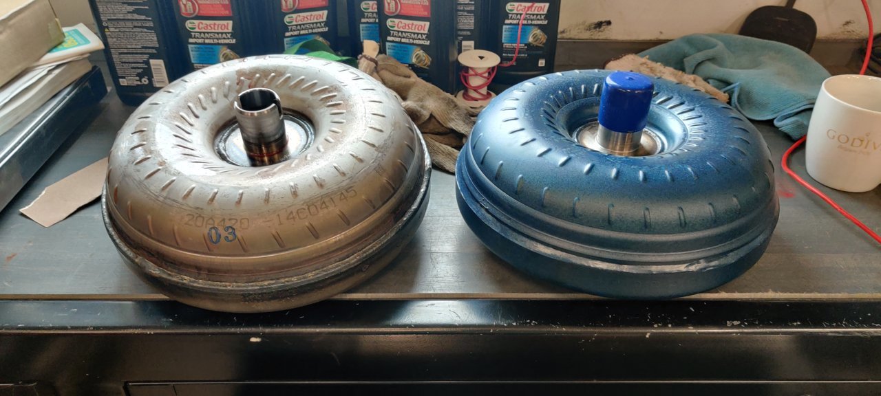

    Just a quick update - I have not forgotten about the post!
    I only just got my new t/conv last night. I finally was able to source one from King-o-matic.
    I also got a new filter and oil... but I was stuck buying a Castrol product as the Toyota dealer here doesn't have and can't get T-IV.
    Hopefully, this goes well!

    Phew... Now the hard part... Assembly!

    IT'S alive :)
    new converter, filter and u joint. Filling the mission up now. No extra parts, no leaks, no abnormal noise. Just like it was supposed to work lol
    Going to be close to 10L to fill it... pushing the 9th in now, still a little low.
    I prefilled the converter with almost a litre, everything has gone smoothly.
    Won't be able to road test tonight, but we'll head out tomorrow after work. HOPING THIS WORKS!!!!
    Thanks again for all the support from the group.
