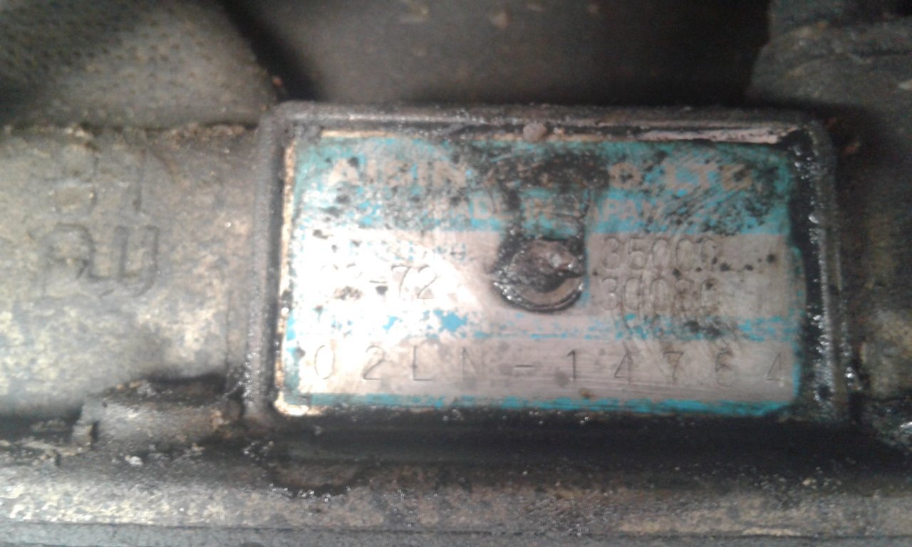

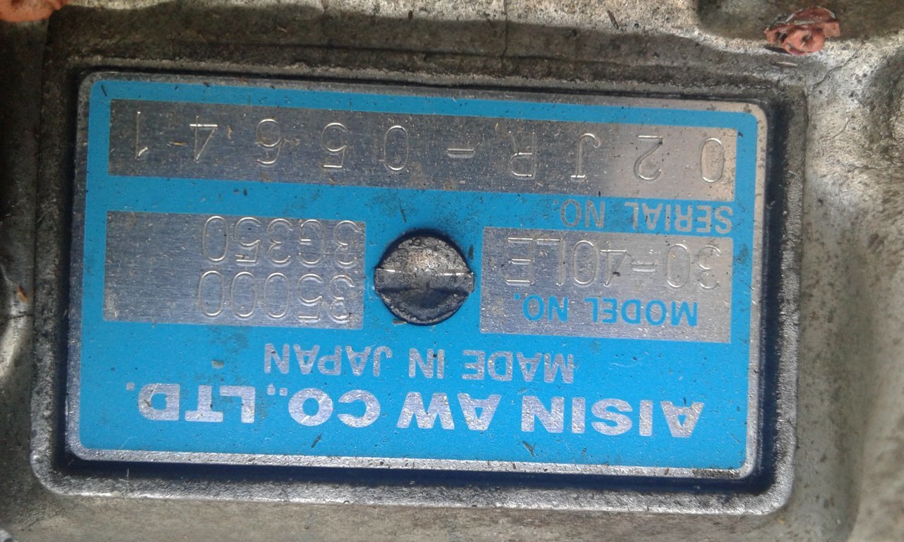

    So the A340E that I have doesn't feature this? I spent hours researching this, and this is the first time I have heard anything throttle by wire. I've called dealers trans places etc.. pics are attached. This is the plate of the new tranny.

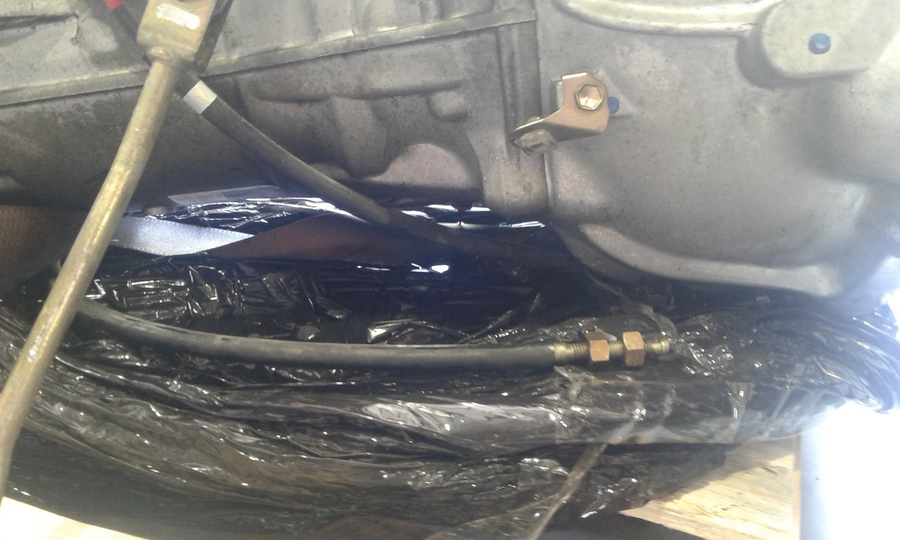

    Here are more pics...first one off tranny on my truck.

    03-72 is what the left #'s show.

    New transmission...

    Another angle...

    That's not an A340E...it's an A340F...which is for 4x4 models.

    You sure? 30-40LE is another name for A340E.

    Yep. A340F is Toyota's model number where 30-40LE is Aisin's model number

    The difference between the E and F is the tailshaft and cone

    Right. A340F has a longer output shaft & different cone to accommodate for the transfer case. The A340E is exactly the same besides the two aforementioned things. I believe you can turn an A340E into an an A340F by swapping the output shaft.

    The A44D reference is probably in relation to the mini-Tacoma's 2WD with 2.4L engines (Non-Prerunner, 5-lug wheels, etc)
    I think the fact OP has the 2.7 powerplant negates the drive-by-wire argument. I thought that only affected the 3.4L powered trucks.
    Check the current trans for the mechanical 'shift-down' cable - drivers side of trans...
